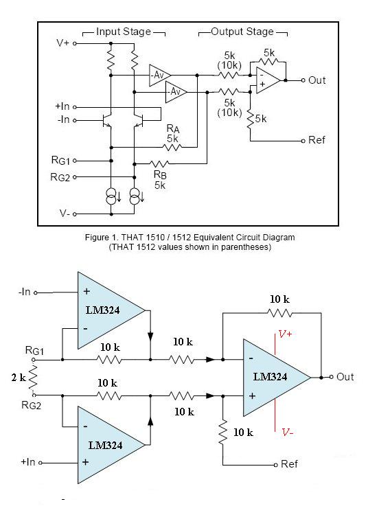

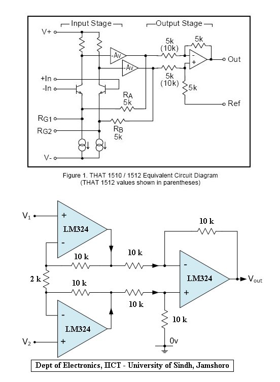

        • Looking at the general block diagram of the THAT chip
          do you think the lm324 amp would be ok for experimental purposes ?
          with a pot for the gain
          The only thing I am not sure of is the ref connection which is pin 5 on the THAT
          the ref connection seems to equate to the positive input of the last lm324
          Moodz has it going to positive, but the lm324 cct has it going to gnd
          which should it be for our cct ?

            Connect the LM324 diff amp equivalent in the same manner. The reason the ref goes to "positive" is because this is the analogue ground ( centre tap of coil ).
            moodz.

                I'm still confused. Ref is 12v logically enough but where does the negative supply (+7v in the schematic, pin 4 on the THAT) connect up to ?

                    I understand the concept of the negative supply, but where does it actually hook into the instrumentation amplifier op-amp arrangement? The THAT 1510 has a reference and a negative supply pin. Op-amps like the LM324 don't..
                    • The inputs are high ie:- 12 volts, as long as the opamp doesn't have any reference to ground (no resistors or capacitors going to ground) it will see the voltage rails as being +/- 5volts. Thats how I see it anyway.
                      Mick
                      • Yeah sorry mick, that's not what I meant but it's my fault, I was explaining my confusion poorly. I've got it sorted now, for some reason I had it in my head that the ref connection on the instrumentation amplifier arrangement was the actual gnd pin of the op-amp, pretty much just because it went to ground and the schematic omitted the actual gnd. No consideration was given to the fact that it clearly goes into the non-inverting input... pretty poorly thought out really... I think I'll drink less vodka tonight.
                        • ...just my two cents .... a differential amplifier amplifies the difference between two voltages ... ground does not come into it. The difference between the two voltages must only be less than the common mode range and gain of the amplifier. Because the output is single ended the ref connection is the "ground" ... however a true differential amplifier would have a differential output also ( not referenced to ground ).
                          ( actually there is no such thing as ground .... electrons cant read ... they just move in response to magnetic and electric fields )
                          moodz

                              Redrawn for your viewing pleasure. Note that the GBW of the LM324 is about 1 Mhz whereas the THAT1510 is is very much north of that. The LM324 could be used after a demodulator section. DC accuracy wont be stellar but it will work.
                              moodz.
