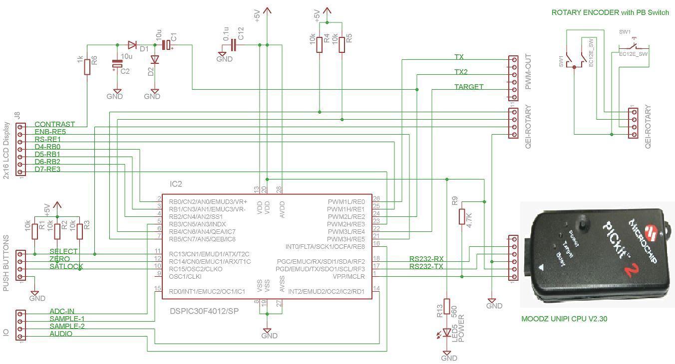

    Schematic is here ....
    A differential front-end PI design originated by Moodz and open for community development.
      [ATTACH]16622[/ATTACH]

          dear friends ... I am happy to ship you a chip if you really cant get hold of one however I feel that if you invest in a pic programmer there will be more benefit as I am sure there will be many small code changes in the near future that will make shipping a new chip each time rather inconvenient if not costly as well. If you have a programmer all you need is the hex file.

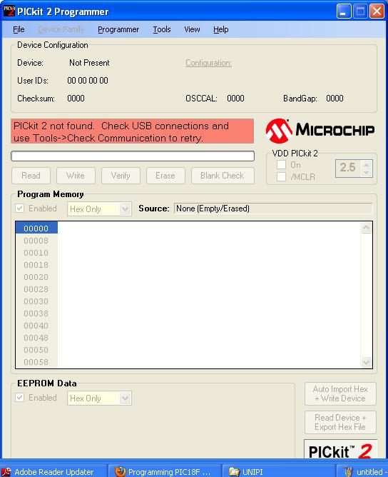

          The UNIPI chip can be re-programmed even if soldered into a board via the ICSP interface on the schematic. ( see programmer in position below )
          I use the pickit2 programmer ( pickit3 is later release but would be OK also ). Of course there are other pic programmers available. The pickit2 is connects to your windows computer via USB and is very easy to use ... also powers your target board with 5 volts if required. The UNIPI chip uses the ICSP interface as a serial port and the pickit2 can be used as a serial port also .. so you can talk to the UNIPI chip using the pickit2.
          You should be able to get a genuine pickit2 for about $40 ... there are clones on ebay for less than $20
          The blank dspic30F4012 should be about $5 depending on suppliers.
          Some of the features I have coming up are better audio, active damping, descrimination ( maybe ) Multiple timings saved to eeprom for fast mode switching etc etc ...

                ... NOTE .... If you have a PicKit2 / 3 programmer you dont need to wire up the rotary encoder or LCD .... the code will not break if you dont wire these in .... you can use the inbuilt serial comms in the PicKit to talk to the UNIPI code and program / save pulse timings to eeprom. Just use the UART selection under TOOLS tab in PicKit programmer with the programmer dongle connected to the ICSP port as per schematic. Once the settings have been made in the serial mode and saved to eeprom ... they will reload everytime the chip is reset / powered on ... you wont need the serial again ( unless you want to make changes )
                ALSO NOTE ... you must wire the ZERO button though .... the code expects you to press this once to commence operation after first power up .... if people dont like this I will remove this "feature"

                        About the pulse outputs of the UNIPI.
                        The TX pulse drives the mosfet driver. Is this pulse a positive pulse?
                        What would be a good level shifter or translator?
                        The same question also for the sample pulses. If they need to be level shifted or translated, and we want to keep the precision timing, we need to have a fast circuit.
                        Does anybody have a recommended circuit?
                        Monolith
                          positive pulse
                          The pulse is positive 0 to 5 volts.however because you can sample at any time during tx or tx period you can use either type of mosfet ...think about it
                          to invert the sample pulse you set the off time to occur before the on time for each sample pulse
                          moodz.
                            moodz.
                            That was badly explained ..... should read because you can sample at any time across each TX cycle either the high level or the low level can be used to drive a mosfet.
                              Thanks for the explanation. So I can use the pulse either way 0 to 5V and 5V to 0. The timing resolution is so high that I can compensate for any switching delay generated by the level translator.
                              Still, to take a 3us sample I would want the switching delay to be less than 100ns on and again off. This means a fairly fast level translator. I need to look at some datasheets and search for possible circuits.

                                Correct ... I have played with sample pulses at 1us ...no problemo.
                                regarding the mosfet driver ... depends if they are P or N I suppose. I am no Microchip fanboy but they do make a fairly good range of driver chips .... there are other ones out there.
                                eg TC4421
