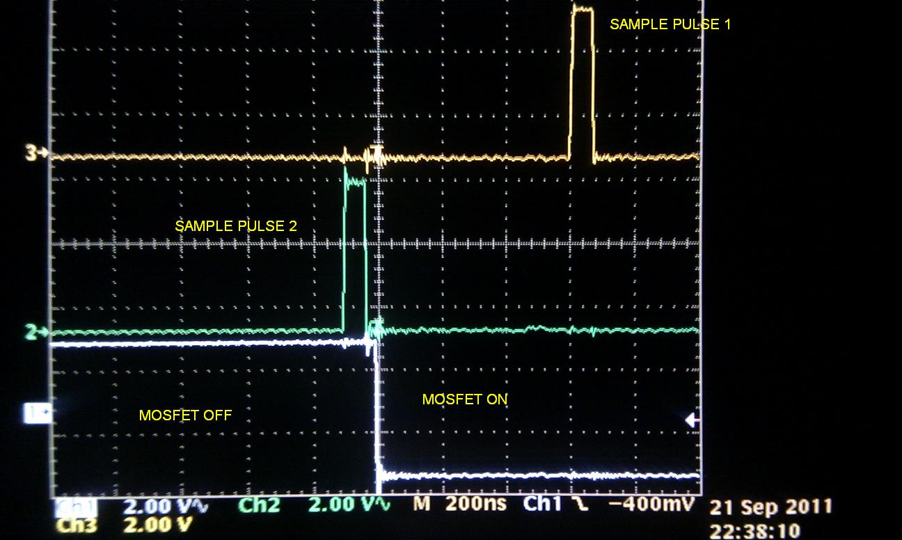

      Now some timing info ... see pic below. ( this is from TX active low code )
      sample pulse 1 and 2 have been set to the extreme ends of a TX cycle ( ie TX on and off periods ) and minimum sample width ( 2 steps ). in this case the TX frequency is 4 Khz so the period is 250 us. The TX on time is 125 us ( adjustable from 0 to 250 us in 66 ns steps )
      The minimum width of a sample pulse is 66 ns ( no prize for guessing what the maximum width is ) ..... The minimum step increase in pulse width (ie sample resolution ) is 33 ns.
      So you should have no problem sampling wherever you want to during TX ON or OFF at any practical resolution, sample pulse width, TX frequency, TX pulse width ... ( is there something I forgot in that list ?? )

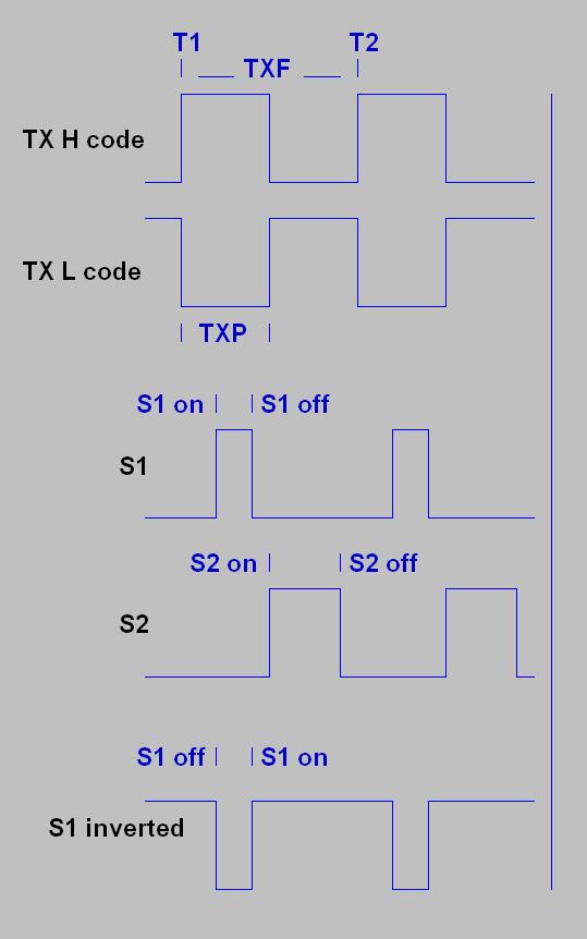

          I wish to undestand this: how ".. with respect to sample times."?
          Can you explain this by drawing? Thank you in advance!
            ... a picture says a 1000 words.
            Answer for WM6 and maybe others ...
            Following parameters can be set from menu ( LCD or RS232 )
            1. TXF transmit frequency
            2. TXP transmit ON period.
            3. S1 ON sample pulse 1 on time set from start of TXP (T1 in diagram)
            4. S1 OFF sample pulse 1 off time set from start of TXP (T1 in diagram)
            5. S2 ON sample pulse 2 on time set from start of TXP (T1 in diagram)
            6. S2 OFF sample pulse 2 off time set from start of TXP (T1 in diagram)
            S1 and S2 can be configured for any on and off time during the period TXF including 0 and the maximum ( TXF ) so you can sample during TX or RX or both or disable by setting both to 0.
            TX pulse repeat at TXF frequency rate T1 , T2 etc
            Also shown how sample pulse is inverted but timing remains the same.
            moodz.

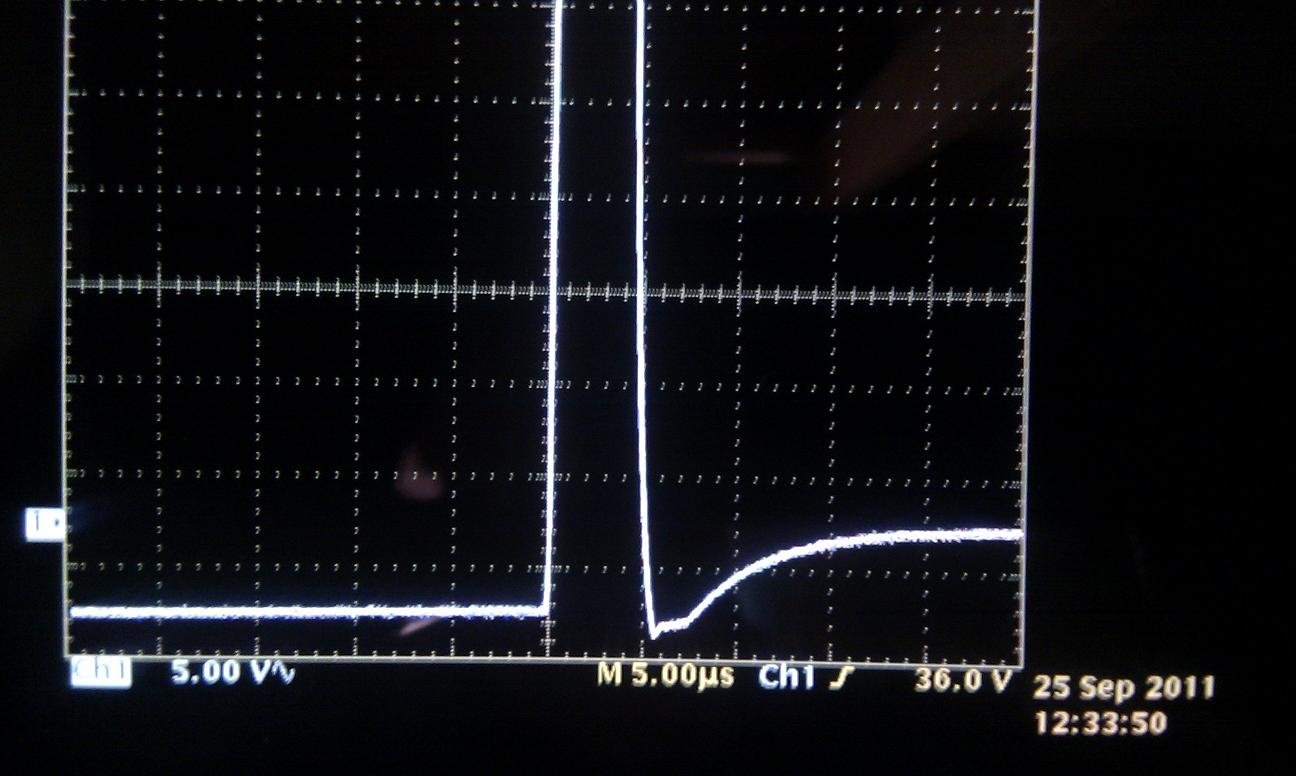

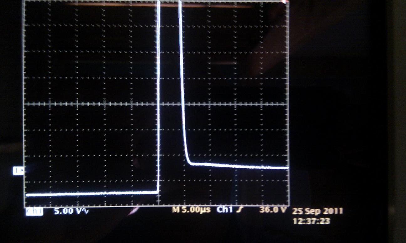

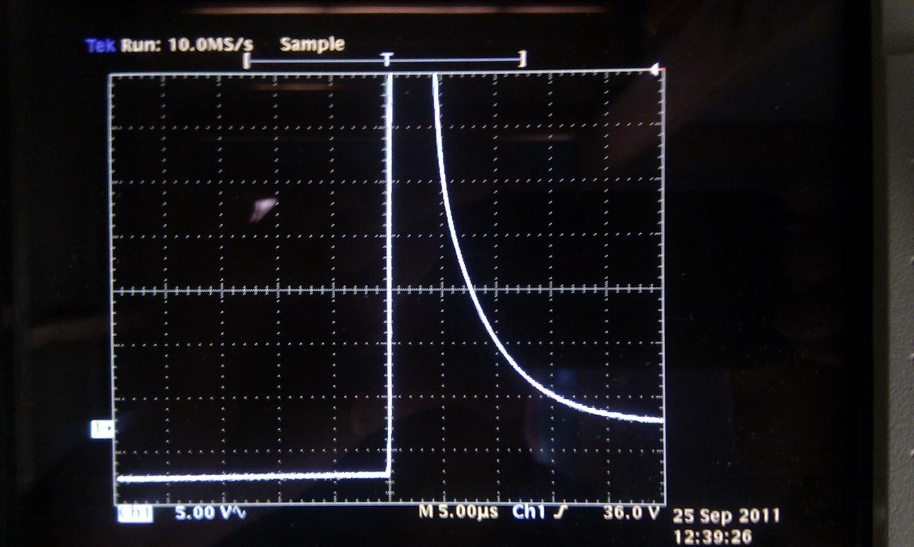

                        ....now we move into the overtaking lane.

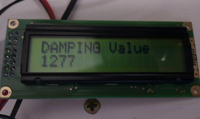

                        A new menu item has been added to the UNIPI chip. User settable damping
                        It is usually not practical to set damping in the field ... The UNIPI can do it now ... select from menu and adjust for minimum signal using AIR ( ie coil not near ground ) .... or you could adjust it with the coil near the ground ( AIR + GROUND ) ... who cares ... do whatever you want .... its easy
                        Below we see shots of OVER, UNDER and OK damping. Below that is the LCD menu displaying the "goldilocks" setting.
                        ... some may ask ... but how will I know if the damping is set right in the field without a CRO ???? ..... well if you look at the pics below and lets say you were sampling at about 7 microseconds ( he he ... oh you noticed my nice coil speed did you ) the output of the preamp will either rail positive or negative depending on over damp or underdamp and this is what indicates by way of a very simple measurement whether you are under or overdamped.
                        Anyway ... if anyone is interested I could add some code to "autodamp" the coil which was going to be a feature on the UNIPI PRO but what the heck ... we can do it on this chip also.
                        These results were tested on a monocoil front end. This is the descriminating frontend that not only descriminates but also provides faster damping through elimination of parasitic capacitance ( sure to be a future topic of furious debate ). I have the circuit physically laid out for testing .. but I have not drawn it yet. The code on its own wont damp anything ..... so I will release it when the hardware drawings available and maybe a bit more testing on coil speeds etc.
