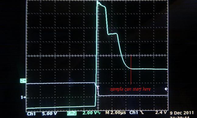

    The coil is a flat basket weave 18 inch monocoil 16 turns of 2 mm2 wire and is driven by the UNIPI chip.
    Demodulator sampling begins at 3 microseconds with a 70 microsecond transmit pulse.
    Below is shot of the output of the active FB blocker prior to the demod / amp section Green Trace. The white trace is the mosfet gate drive signal.

    Descrimination is available However it is via a two sample method which is not quite as "neat" as the single sample used on the differential coil.
    However it is a vast improvement over conventional monocoil front ends.

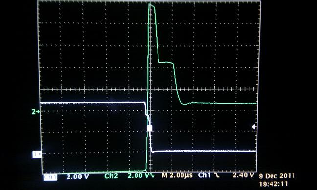

      ...more results.
      We increase the Tx pulse length from 70 microseconds to 120 microseconds .... now there is some serious current and flyback running in this 0.37 ohm 18 inch coil.
      The active blocker does its job with nearly 800 volts at the input
      Still better than 4 usecs settling.

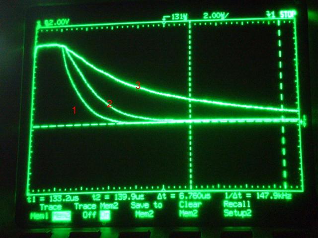

          ... add 260 pf to the circuit.
          we add around 260 pf ( actually substitute heavy duty switch instead of low capacitance switch in blocking circuit ) ... very little degradation ... I am impressed. Maybe sampling at 5 microseconds now ( 120 microsecond TX ).
          Ok so we wont be picking up the fine gold chains ...

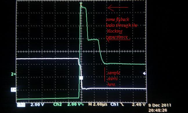

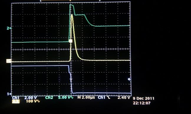

              ...flyback blocking
              Below is a pick of flyback blocking with input and output of blocker shown ... obviously there is a difference in voltage scaling ... the input is 400 volts peak.
              ( no resistors were harmed in the making of this picture )
              moodz

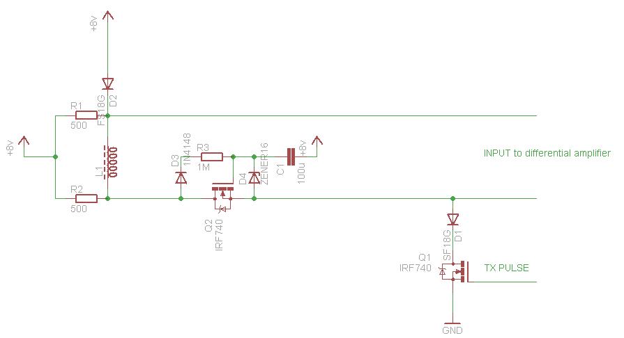

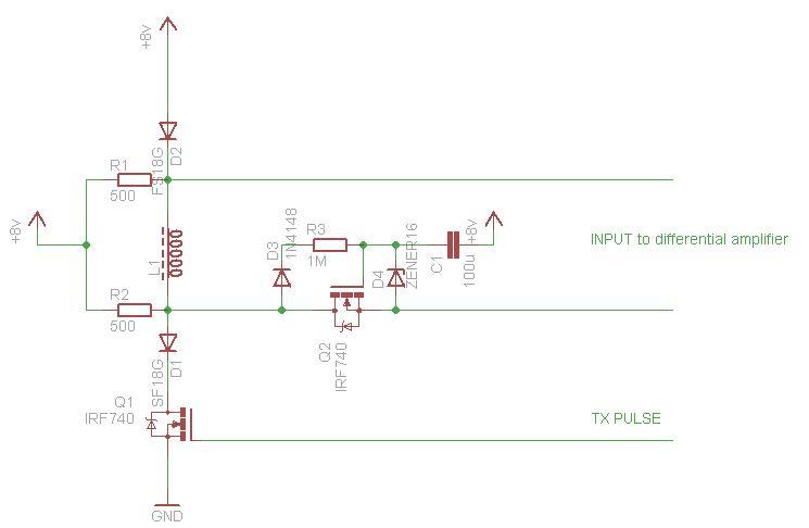

                          Here is the circuit ( as tested )
                          Thanks you guys ... well here is the circuit. ( told you it was simple )
                          Tepco dont read this because it does not work .. it will work for everyone else though.
                          For the coil there are two states ( TX and RX ) D1 and D2 provide current path through coil during TX and isolate it during RX. ( this is important )
                          R2 is the "real" damping resistor however R1 is provided to balance the coil during RX. ( balancing the coil is very important ) By keeping the coil balanced the differential amplifier will reject a very high degree of EMI and make it possible to operate with no coil sheilding on simple detectors.
                          The blocker is formed around Q2 ... it is very simple but provides diode speed blocking of voltage spikes reaching the input of the amplifier. It is not needed on both inputs as the flyback is only on one side of the coil.
                          Q2 is "on" at all times but goes open circuit or "OFF" when the voltage input exceeds the gate + threshold voltage being maintained by C1.
                          Q2 should ideally have a high breakdown at least equal to the TX switch Q1 and a minimal gate capacitance.... though I tried a "power" device here and it worked swell.
                          C1 is charged via D3 and R3 which impose a very minimal loading on the flyback pulse. This also forms a saftey delay after turn on as until C1 reachs sufficient charge Q2 remains OFF.
                          The blocker circuit can be used in any situation where you want to protect a sensitive input such as an amplifier. It is not specific to this diff circuit ... use a diode clamp if you want but make sure the circuit is balanced ( coils sees same circuit loads on both sides )
                          the coil is your standard monocoil ... I would recommend that if the coil is sheilded that the sheild is not connected to one side of the coil. Should be connected to ground.
                          moodz

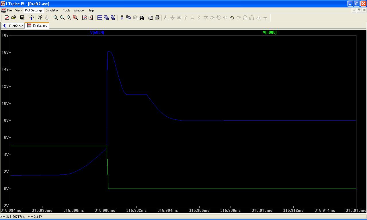

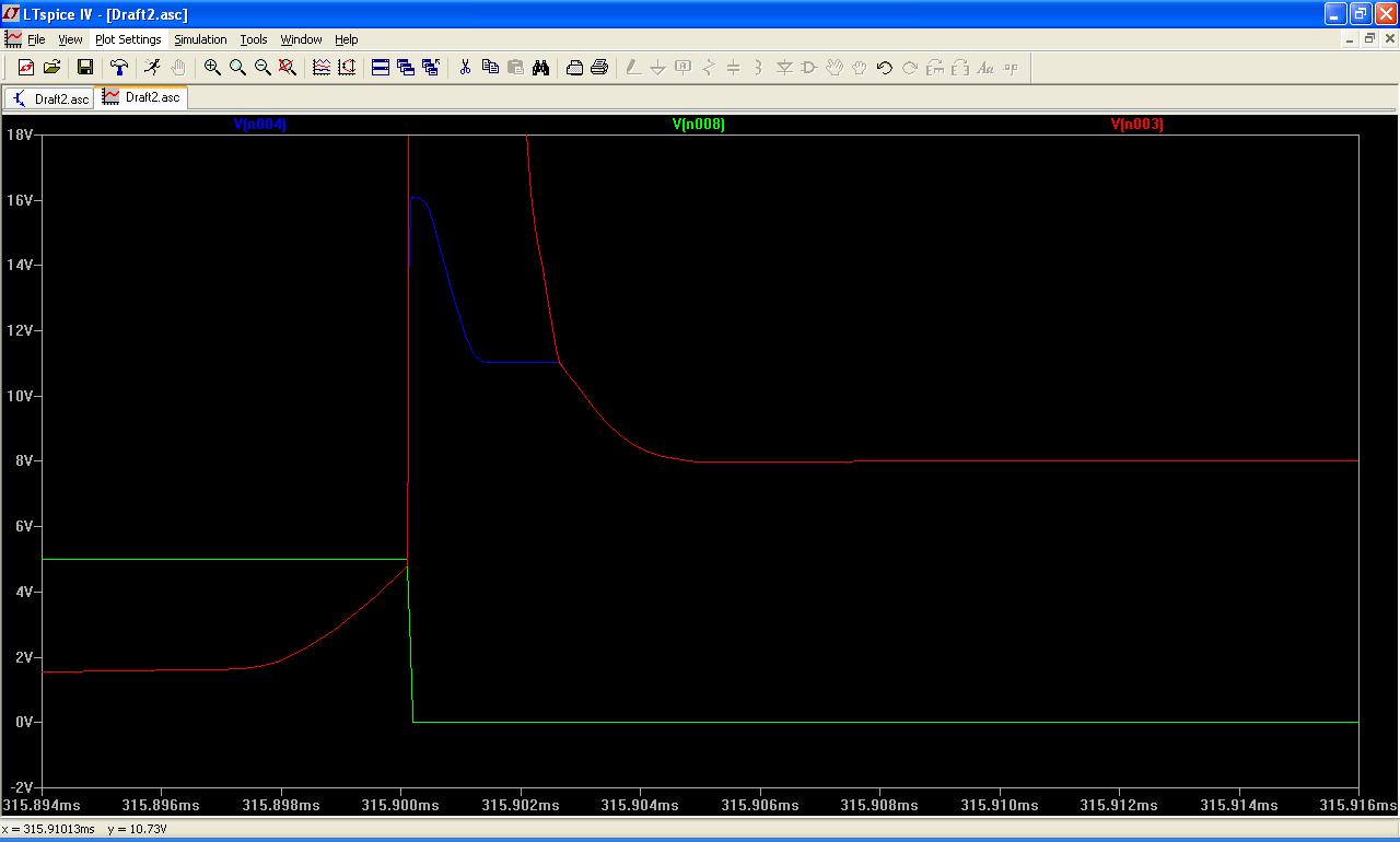

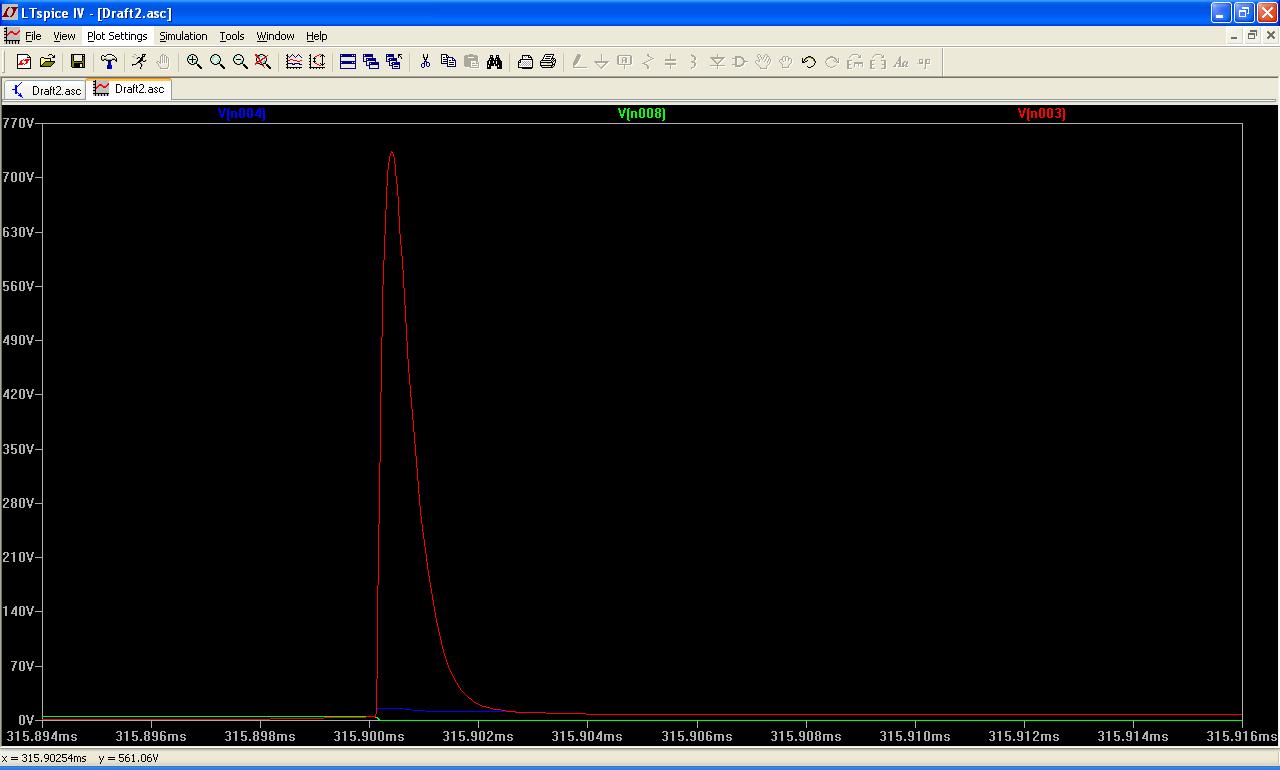

                            And the sims work as well ...
                            I ran the sims after I did the prototype ... and it works swell too.
                            note I ran a smaller tank cap on the blocker to speed up the sim runtime.
                            moodz

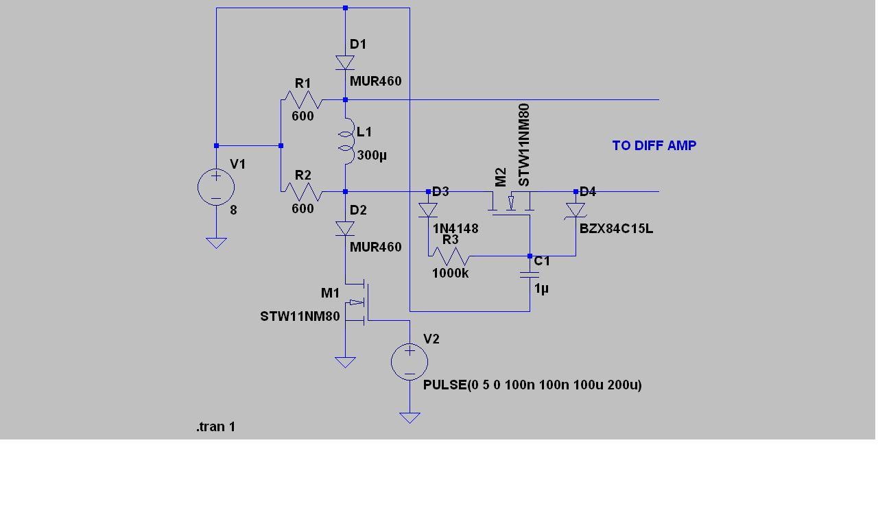

                              MONODIFF2
                              .... here is another ( to be ) tested improvement ..... the differential head, damping and blocker circuit can be located in or very close to the search coil ... This will eliminate the flyback pulse having to travel up the coil cable to the control box ..
                              The blocker transistor Q2 should have a low "ON" impedance.
                              and again it is the most simple change ...
                              PS the TX switch device does not need a high voltage rating now ... the blocker handles the flyback volts
                              moodz
