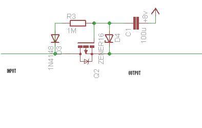

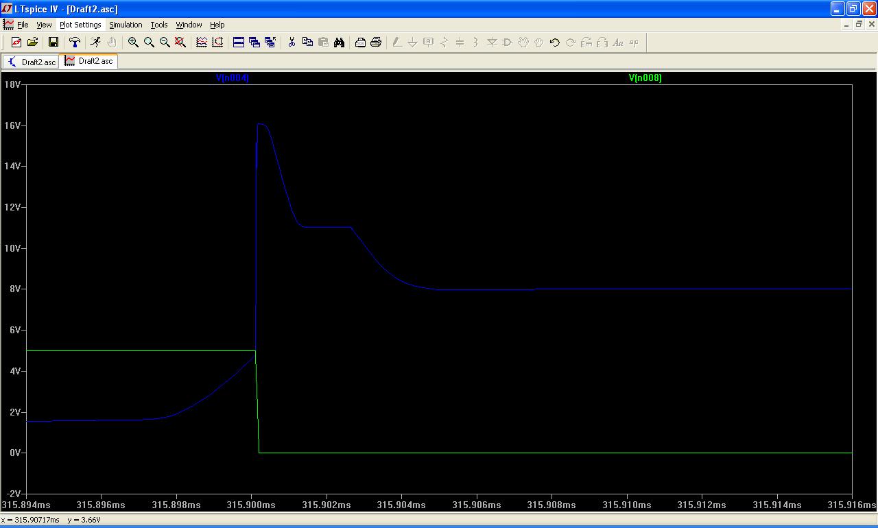

be careful, when using the (internal) semiconductors of LTspice library!!!!!!!
The diodes, mosfets (and transistors) didn't implement the break down behaviour (and very likely the other parameters as well).
Use the part's individual and specified spice model from the part's manufacturer in this case.

Hi moodz, do you need to change something in code or last version is applicable here too?Originally posted by moodz View PostThanks Aziz ... I am wary of sims ... I did build and test this circuit before I simmed it and managed to get it up to 800 volts before I blew the mosfet up ( which was supposedly rated at 600 volts ).

Hey, what's up?
I couldn't verify the spice simulation results however (schematics from post 14 http://www.geotech1.com/forums/showp...1&postcount=14 ). I'm sure, I didn't make anything wrong. I have used the real spice models (IRF740) rather than the internal ones from the library.
Aziz
Aziz ... are you sure your library models are working OK ..... add on libraries sometimes dont work because they dont model underlying ideal device behaviour correctly.Originally posted by Aziz View PostHey, what's up?
Aziz
Anyway here is the file ... make sure you run the sim till the voltage reachs 16 volts on C1 ( stable operating condition ).
Dont forget .. I ran this on the "real" simulator .... using real parts in a real circuit
moodz

WM6 are you talking about the UNIPI code for the control chip ?? I did not change the code.Originally posted by WM6 View PostHi moodz, do you need to change something in code or last version is applicable here too?
But I did try differenty types of Mosfets in the circuit and they all work ... they just have different maximum break down voltages.
The highest breakdown reached 1700 volts but this is not practical.
moodz.
Hi moodz,Originally posted by moodz View PostAziz ... are you sure your library models are working OK ..... add on libraries sometimes dont work because they dont model underlying ideal device behaviour correctly.
moodz
[ATTACH]17711[/ATTACH]
ok, I have ran the sim much longer so the gate voltage stabilizes at 16 V. In this case, it works.
But the blocking fet circuit needs further improvements.
Aziz
