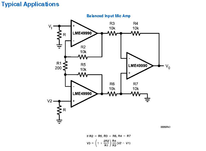

          Cheers Midas .... I will get some results but Mick will probably beat me to it. The LME49990 certainly has some pretty good looking specs but it is an OP-AMP not a diff AMP like the THAT .... snippet from the 49990 spec sheet below if you want a diff amp ... I am not saying dont use it though ...( if you got em ... smoke em )

              Got plenty of them. I also have a INA133UA sitting in the parts bin, unity gain diff amp. Might be ideal if it doesn't have input diodes.
                  Yep I realize that. That was pretty much the circuit I was planning on using. I thought we'd already given up on single chip diff amps. But if you do know of\find one with specs as good as the lme49990 I'm all ears. I'm sure I can find another use for the lme's. Whatever I use though I'm actually hoping on keeping the magic smoke inside the little black box.

                      I reckon just make up a diff amp using ne5534 ... ???
                      so you reckon that would be the way to go Moodz ?
                      • #41
                        Well what I meant was you could use them if you have them on hand .... they are fast enough and reasonbly low noise / low cost ... depends if you demod then amplify or amplify then demod.

                          • #43
                            Considering that the unbalanced input of the amplifier in most PIs have very little, if any common mode rejection ( thats why you need all the elaborate shielding on the coils ) the discrete differential amplifier will be fine. You actually only need about 16 db of CMRR whereas an "unmatched" discrete differential amplifier will achieve usually better than 30 db.
                            The bottom line is that for this application you dont need some fancy pants CMRR rejection level .. you will never be satisfied with the performance if you indulge in catalogue engineering ( there is always another chip with better specs ).
                            Good engineers make what they want out of what they can get.
                            Make it work then make it better .. not the other way around.
                            moodz.

                            • #44
                              moodz.
                              Hi Moodz,
                              I'm not sure what you mean when you say you don't 'need' fancy CMRR. Are you saying that past 16db you stop seeing any benefit in noise reduction?
                              I was thinking the more CMRR the better which is one of the reasons I decided to go with the discrete opamp solution. My plan was to add in a multi-turn trimpot to one or two of the resistors where I was hoping I'd be able to to adjust it its to a better CMRR than the THAT1510. Perhaps its not worth it.
                              So what did you mean when you said:
                              "The THAT amplifier is not the best here ... use opamp DC diff amp."
                              Midas
                              • #45
                                Hi guys,
                                no doubt, you can use the discrete version too. You just need a compensation network for best CMRR (crucial point in differential amplifier applications). This means adjusting the source impedance (source resistance and capacitance) and the amplifiers resistor network.
                                The complete instrumentation-amp IC's reduces noise, pcb space and cost of course.
                                Aziz
