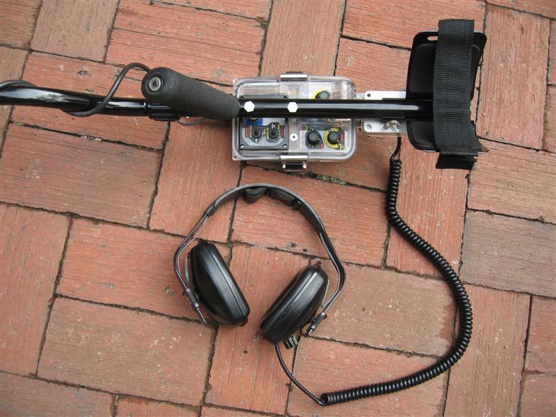

          not mine pic Click image for larger version
Name:	IMG_7132 (Medium).JPG
            nice! $10! http://www.ebay.com/itm/IKELITE-UNDW...AAAOSwPCVX-pKa
              Some of the Ikelite boxes will fool you in size, request or research the interior and exterior size. Some are real heavy, some appear to be the right size and then when you get them you realize you find they are totally unsuitable. There are many Ikelite housing to choose from and if you watch you can get a good housing for under $30.00. The smaller your circuit board the better chance of finding a workable housing. Older Ikelite housing do make great waterproof boxes that can be converted for U/W metal detectors.
              I bought a housing like this last year for $20, right size but, because of the thickness, it is heavy. At least you know its waterproof to 250'. You may also want to look at the waterproof underwater flashlight housings. Some of the older ones had larger housings.
              http://www.ebay.com/itm/STEAMPUNK-7-...YAAOSwWntXNOId
              This listing offers one that was the same used by Garrett for the XL500 and i think the Barracuda. http://www.ebay.com/itm/Ikelite-Vintage-Three-Housings-For-Strobe-Camera-Collectible-/391566150059?hash=item5b2b2949ab:g:fS0AAOSwaB5Xt3g f

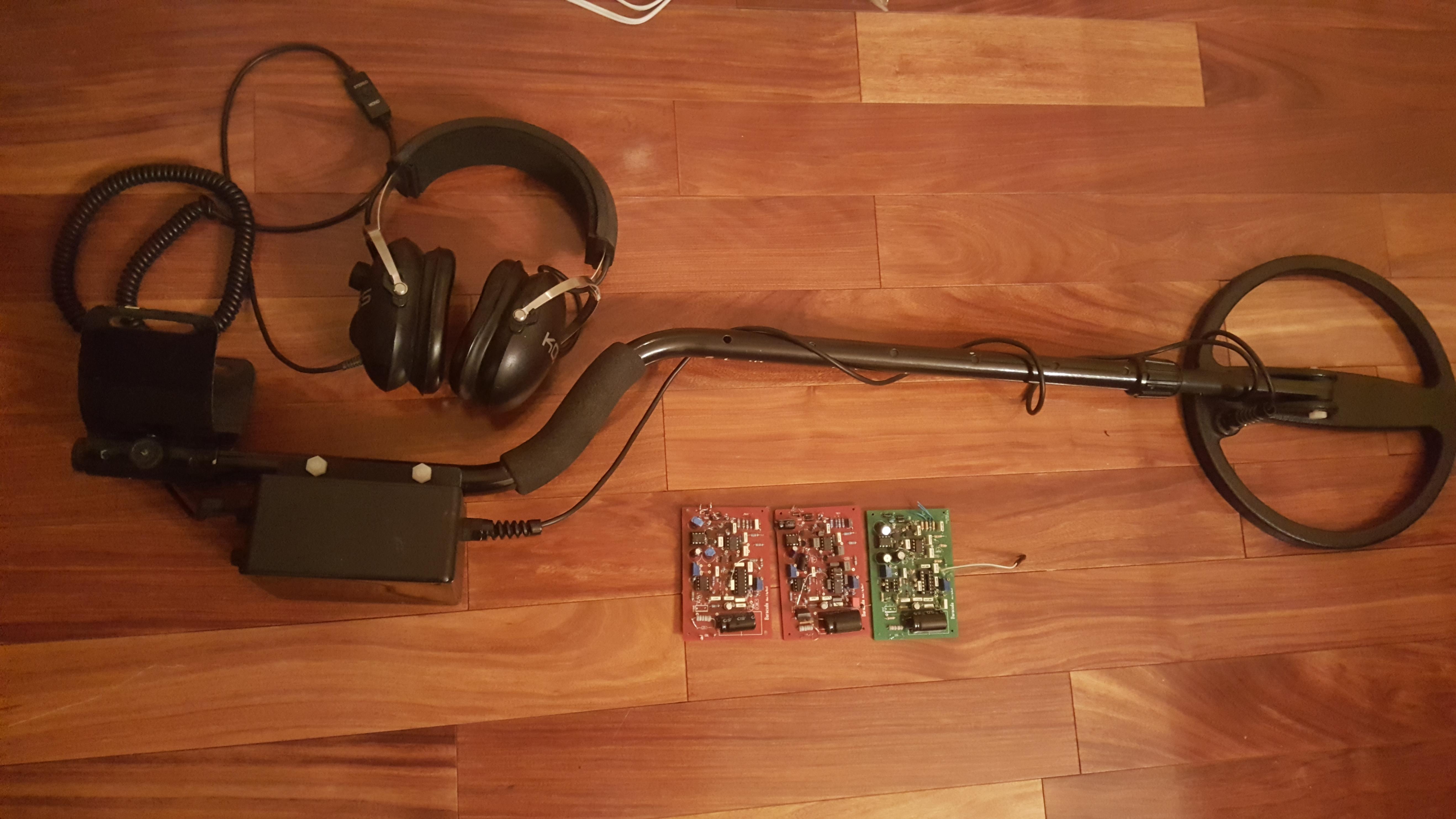

                        Thanks to George and everyone else who contributed to developing this wonderful project. Baracuda #4 works as it should! Completely free from noisy coil movement and all the depth that it should have from the latest Silverdog kit.
                        Don..
