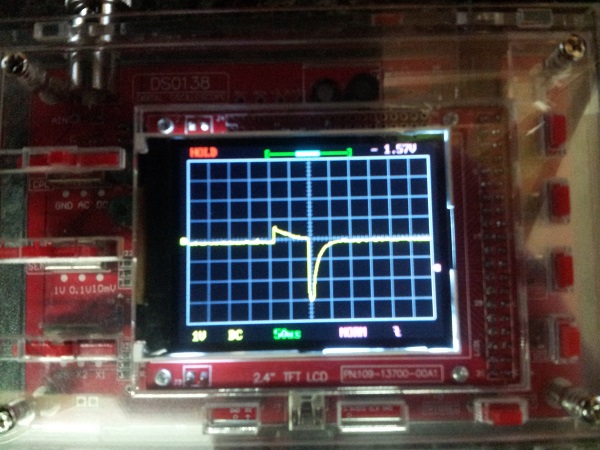

          i use a DSO nice tools i set the delay at 50us on pin 5 of the 40106 max resistance on the pot
          oh i forgot to say i shorted pin 2 and 3 on pl2 to fix the no connection on pin 3

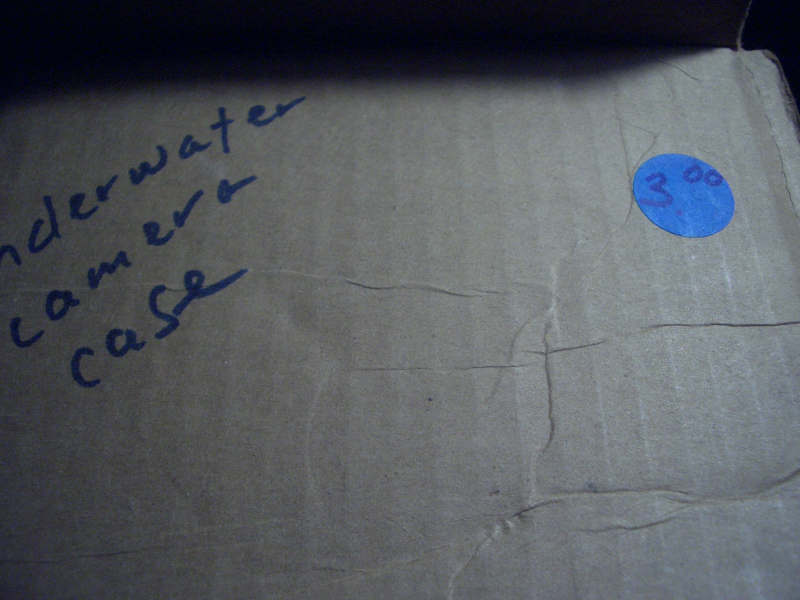

            KT did you tried other waterproof box and was not good? or this is first md for underwater? i also want to do baracuda for underwater use.
              ikelite camera case is perfect on the cost. i believe you can find it for $3 on any US sale - look
              cartoon box and a price on it (real price, not the same i bought it at ebay).
              all american made are unaccesable for me just cause i am on another continent. i do all people could get
              low cost waterproof enclosure for the project.

                        What point is that image on the DSO taken from ? First Op Amp ?
                          if your talking about my pic its not the op amp you just set that to 0v on pin 6 using the scope if you want, for the delay i set that to 50us to match my coil rate which is 50us you can look at the rate on pin 6 of the op amp then set pin 5 of the 40106 to the same rate basically when it falls of to recovery thats how i worked out my minimal delay(set the delay pot to max resistance before testing), i might be wrong setting it up that way but it works perfect
                          and once your done i used the scope to mark points on the delay dial for reference of the rates
