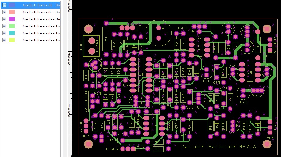

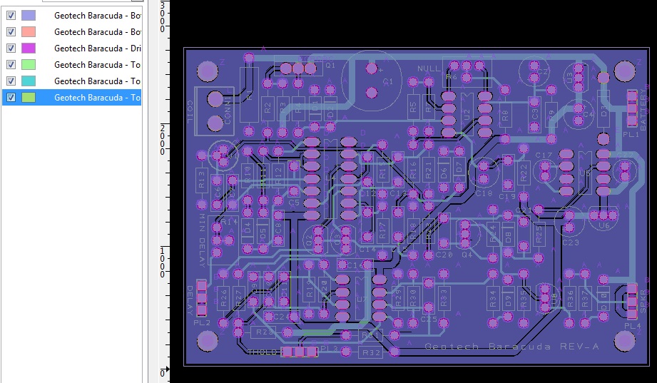

Name:	bara wo bg layer.jpg
    is this correct? i open with gerbv as suggested
Name:	bara all layer.jpg
      this is all layer

        if i say this correct or i say this is not correct what that will change?

          Looks good to me. Why do you think there's a problem?
          Just send the Gerber files off to a board manufacturer, and some nice shiny PCBs will be returned.
            George, if somebody is not trusting to people he has to make all himself. thats gold rule.
              Very true.
              In this case I think he's just confused about the ground plane on the bottom layer. Perhaps he's expecting to see a bunch of tracking, and doesn't know what a ground plane is. We'll have to wait for the reply.

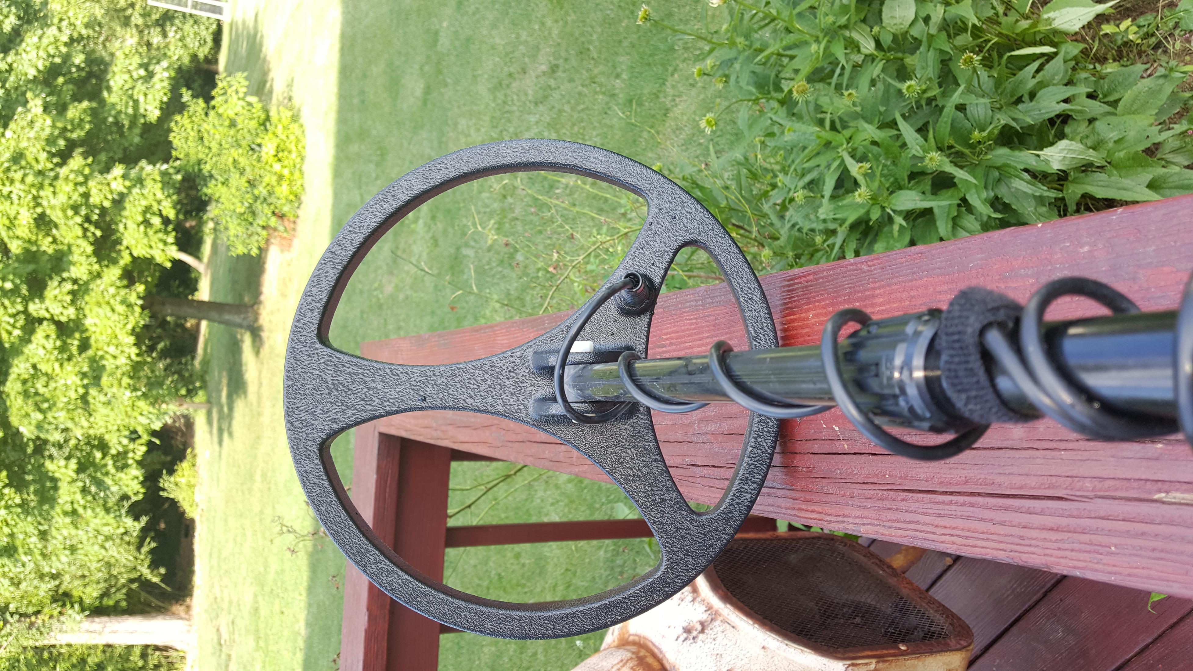

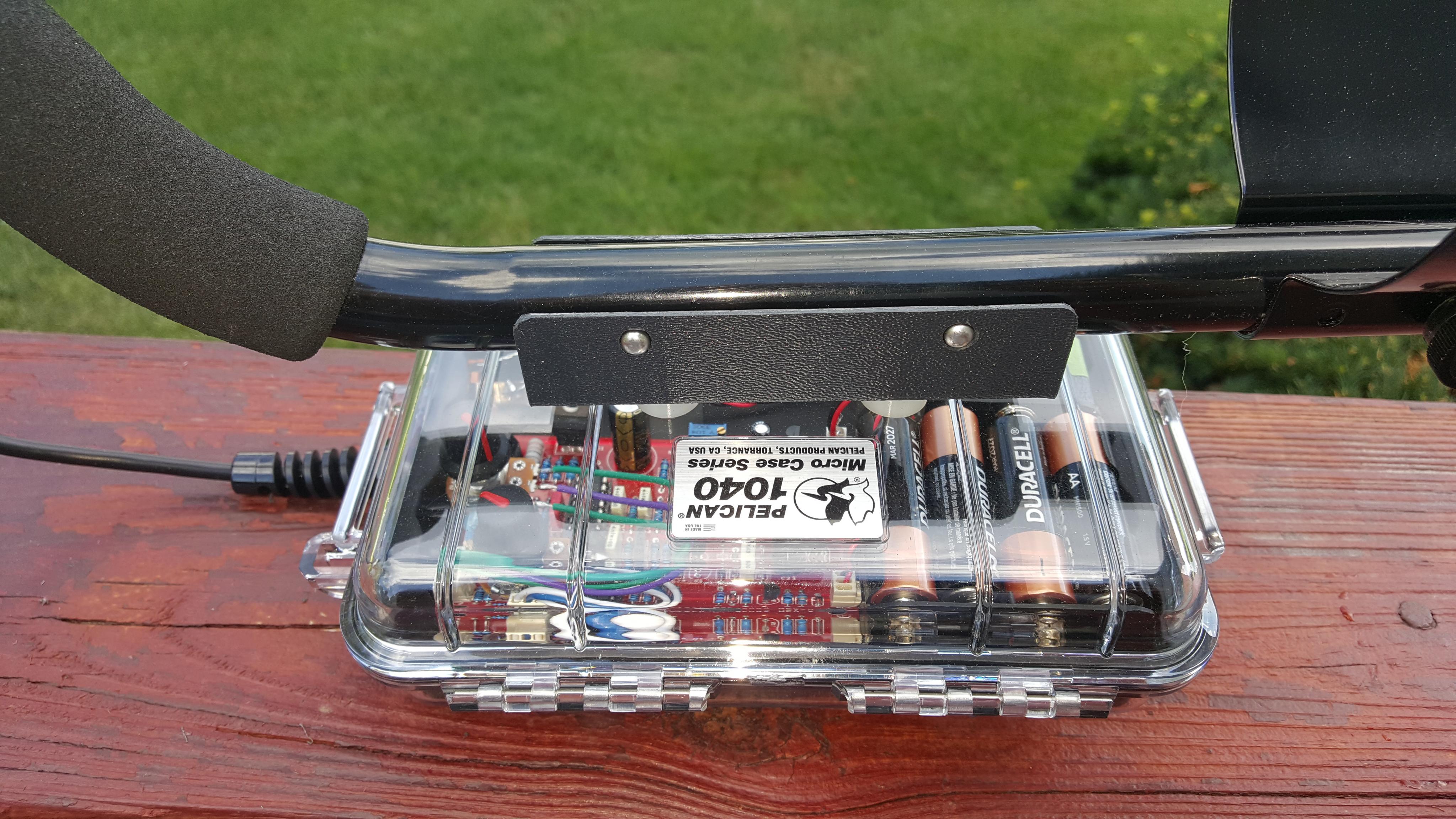

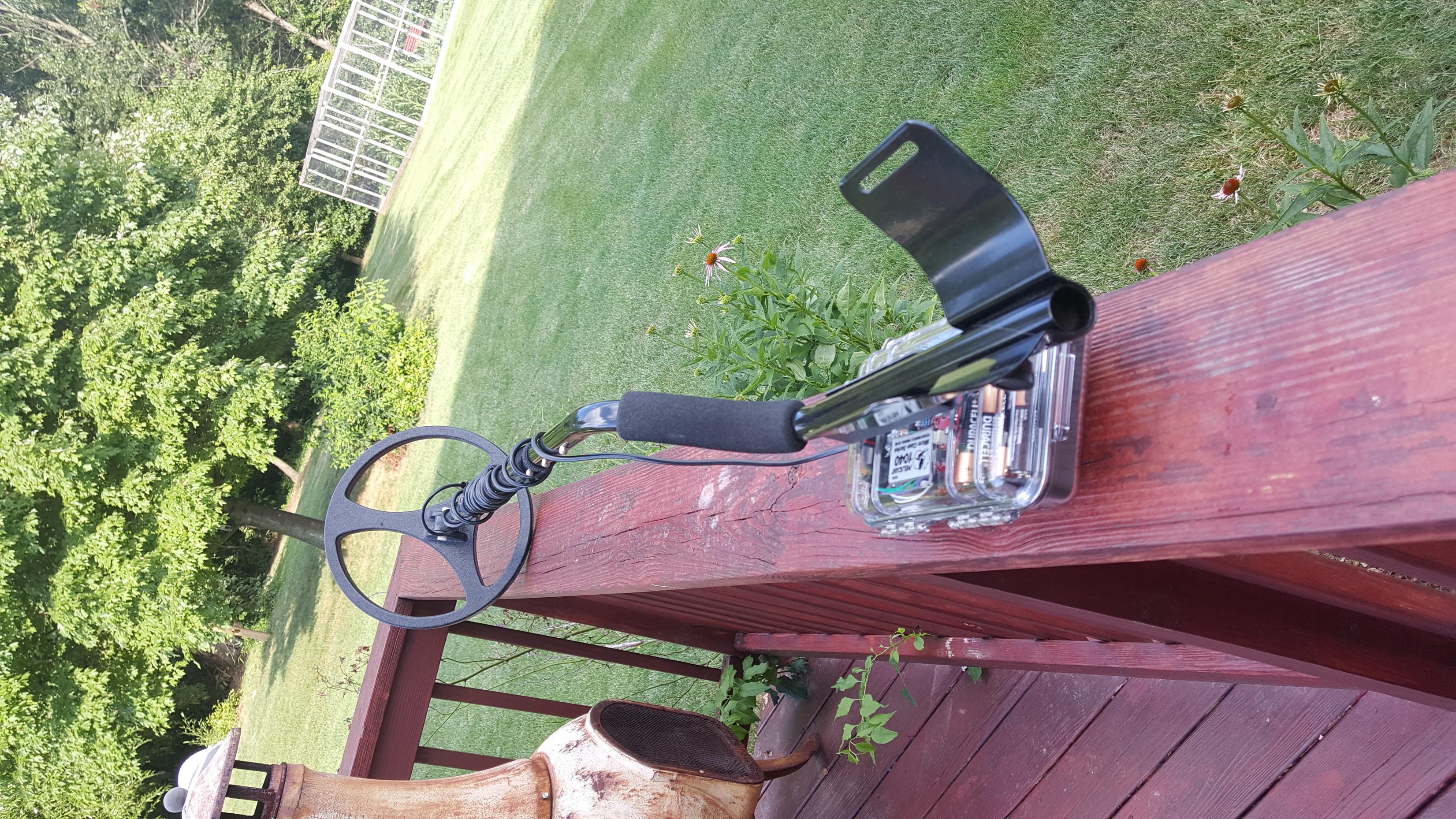

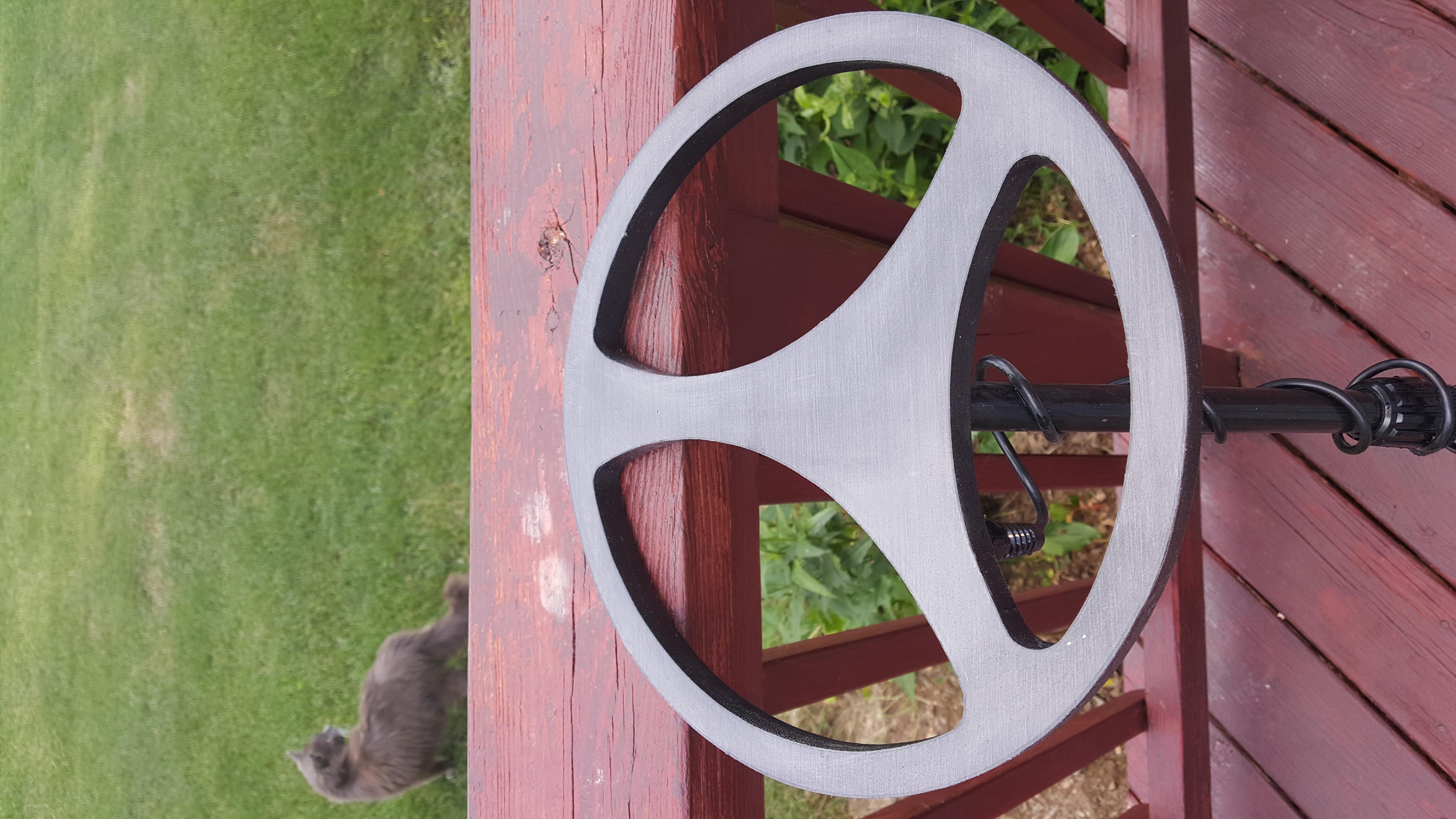

                  Just finished up another Silverdog kit. Performance is about the best yet for a home built kit. I used Max MCR black a/b potting compound which puts my coil build cost at just over $10.00.
                  I was skeptial about wire size but 26 AWG enameled magnet wire on a 10.25" form works just fine with a 15us delay.
                  I'm selling the shells now for $10.00 USD along with a cable strain relief.
                    Dang, That sure came out NICE !
                      nice clean project! Congrats. I do not see the speaker/headphone connector. What you use? And what detection depth you get after setup. Thanks
