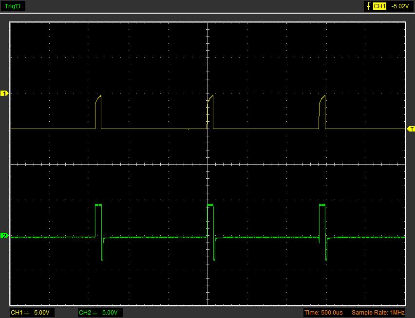

    HelloI finished assembling the baracuda kit, no problem during installation, calibration seem ok from oscilloscope images.
    the coil is 400uh 2omh.
    the depth is good, the threshold goes well, I do not understand what is the delay adjustment, it does not change me absolutely nothing adjustment, it depth, it discrimination.
    I do not understand what it's worth, those who help me? Grazie!!!
    http://uploads.im/GBPaJ.jpg 700 khz pulse
    http://uploads.im/OJmPS.jpg delay min
    http://uploads.im/s2pQE.jpg delay max
    those who help me?

      The lowest delay setting achievable with your coil is around 20us, so that looks correct. If a PI can detect aluminium foil, then increasing the delay will eliminate the foil. Further increasing the delay will knock out pull tabs. Hopefully you're not expecting the Baracuda to discriminate against iron, as PIs discriminate targets based on conductivity.
      By the way, your pulse rate cannot possibly be 700kHz. It looks more like 700Hz to me.
        thank you Quiaozhi
        my mistake, the frequency is about 700Hz

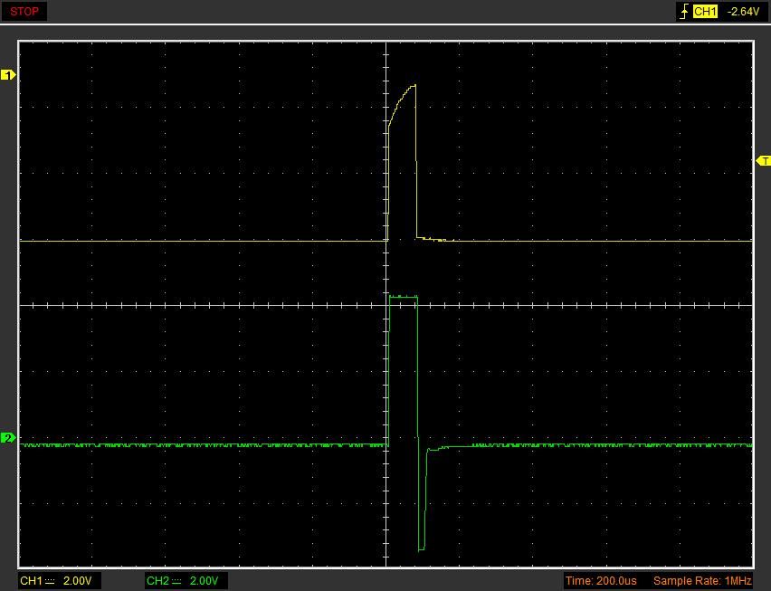

                          ok Qiaozhi,I adjusted trimmer r6 for 0Volt off set pin6 U2, I am attaching oscilloscope images .ch1 U4 pin4 - ch2 U2pin6.
                          it all seems ok.
                          It could be a disorder of the LT1054 synchronous?
                          thank you

                            Are you sure the preamp output is settling at 0V?
                            From the scope shots it appears to be offset in the negative voltage direction.
                              STEP 5
                              RX preamp (see Fig. 7)
                              Fit R4 (1k), R5 (1M), R6 (100k trimmer), R7 (1k), R8 (22k), R9, R22 (27R), R16 (150R), R18 (10k), C2, C18 (47u), C3, C15, C19 (100n), D1, D2, D6, D7 (1N414 and U2 (NE5534)
                              Measure the DC voltage on U2 pin 6, and adjust R6 to give 0V
                              Step 5 needs to use a scope to set preamp output to zero volts.
