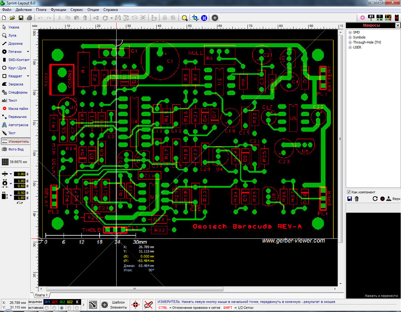

        Hello, I have a barracuda on order from silverdog and I'm trying to get the other parts together. I want to get a housing, but I don't see the dimensions of the board listed anywhere. Can anyone help me out?
          57 x 87 mm . Don't know height with components is like 2 inches.
              silverdog board 65 x 96 mm. i do measurement in sprint layout...

                  KT315 is correct (in metric).
                  The board size was kept the same as the original from Alexismex, which is actually 3.8" x 2.6" (96.5mm x 66.0mm) to be exact.
                    hight is like 25mm with the big cap in normal position. i just ordered this box, i think is good with 3x18650 batteries.
