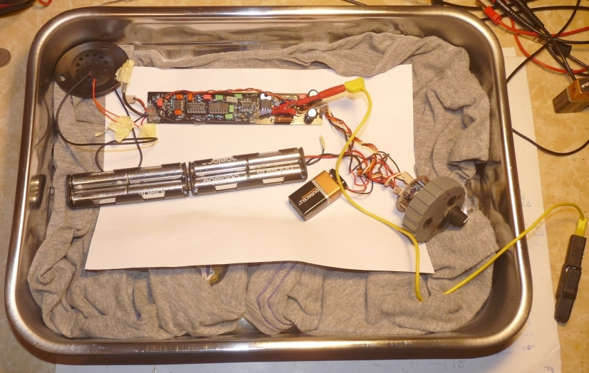

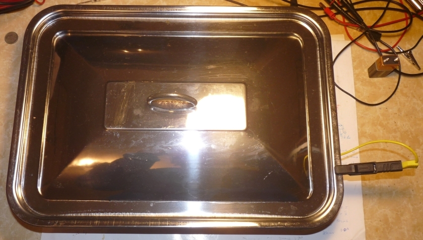

        I am still chasing the noise issue and am learning a lot in the process.
        I put my noisiest surf pi in a nirosta (magnetic stainless steel) box.
        There is NO coil attached, only the damping resistor ist connected.
        I am not measuring anything externally, just listening to the threshhold wobble.
        It stays the same even with the lid on.

        Question: is this a proper way to reduce emi in any way or is it just wishful thinking?
        In other words, is this a bollocks way to "measure" EMI before after?

          That SS contained should be ok for electrostatic shielding and maybe magnetic shielding. Mag shielding is tough to do.

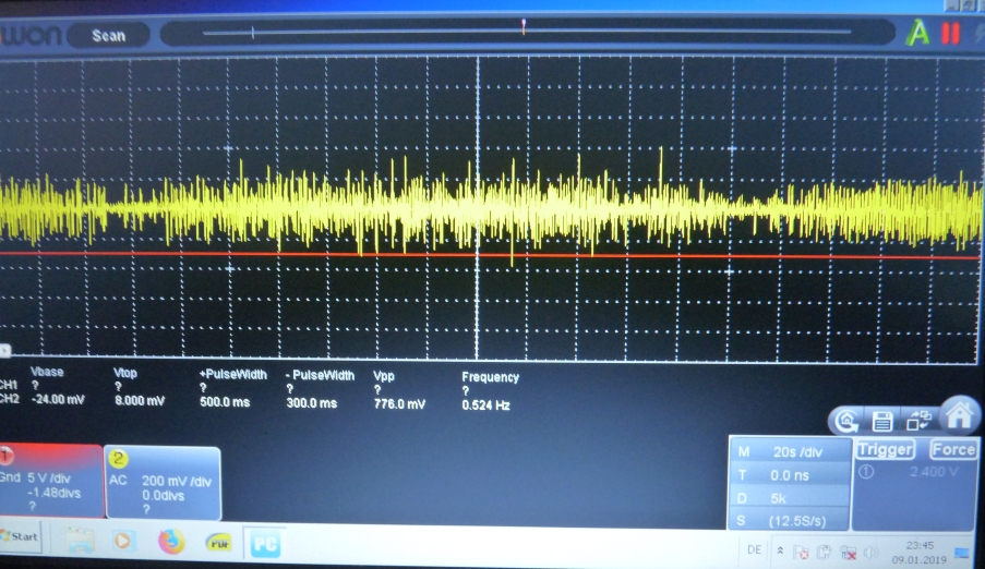

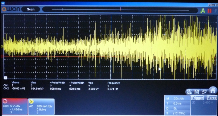

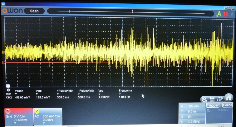

                I did a slow trace for noise on pin7 on my oscilloscope last night and was happy with the results and just let it run.
                Then I saw lots of noise on the scope when I looked again later. I then started taking photos.
                Here are the photos, maybe you can make sense of them. At first the noise was only around -+50mv when I wasn't taking photos.
                There is a small "gap" in the first photo at div 4. That was my "happy" noise level before the noise came.

                Thought the following article might be interesting for you. What is your take on this?

                  Very hard to tell if it is picking up external noise or if breaking into oscillation.
                  The noise you show in the scope is pretty bad. Is this is on pin 7, +5V, on the pre-amp? That indicates something is wrong in the DC-DC converter that generates the +5V.

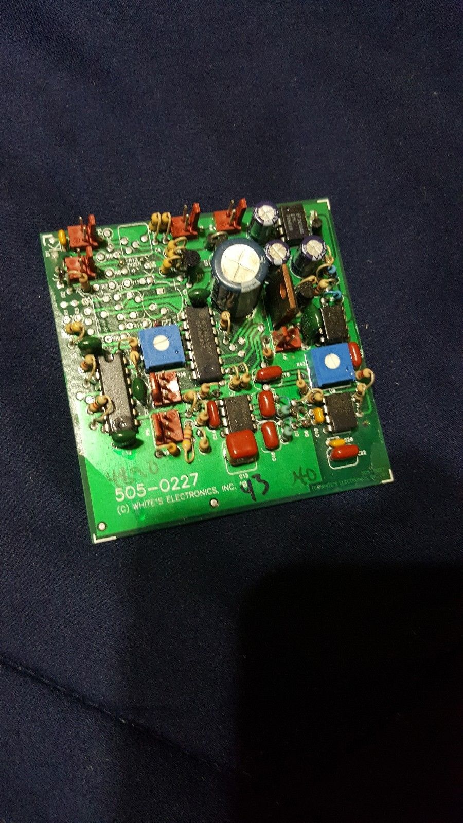

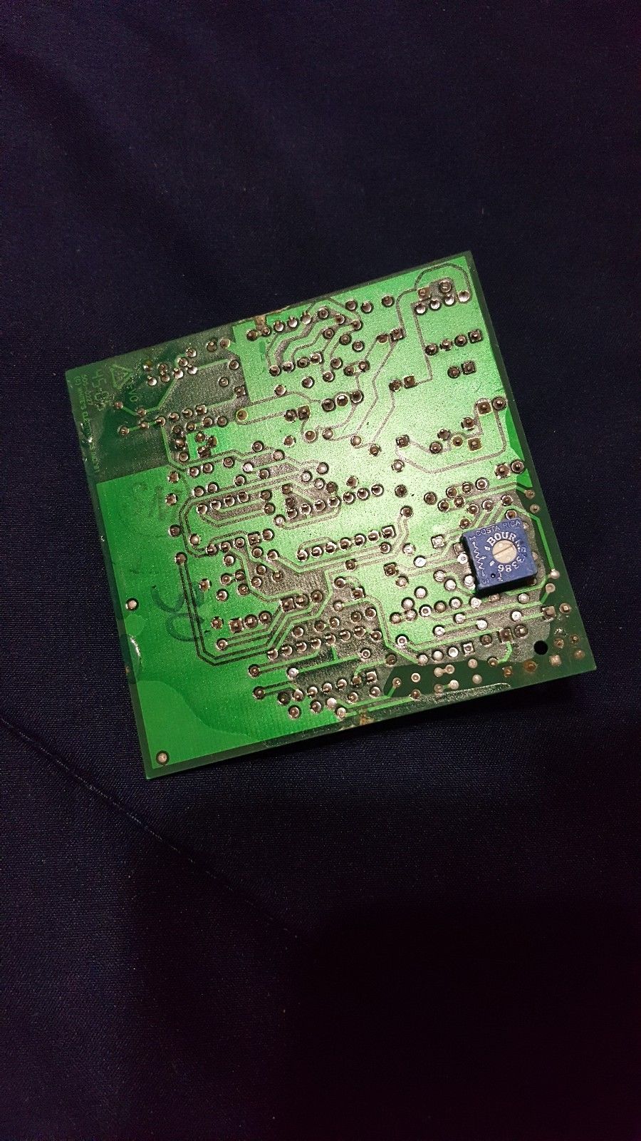

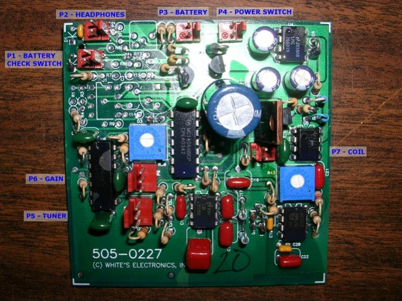

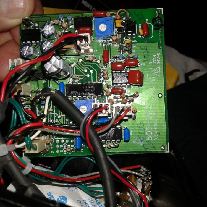

                    These are the best photos I've got of the original Whites PCB. Might be helpful to someone.
                    With regards to the noise I've read topic on the Russian forums where a person put the decoupling capacitors between positive and negative rails, rather than ground as the ground rail is more noisy. Same person add a mod for deeper threshold which if i found I'll show you here so you evaluate it. Note i've not try any of these.

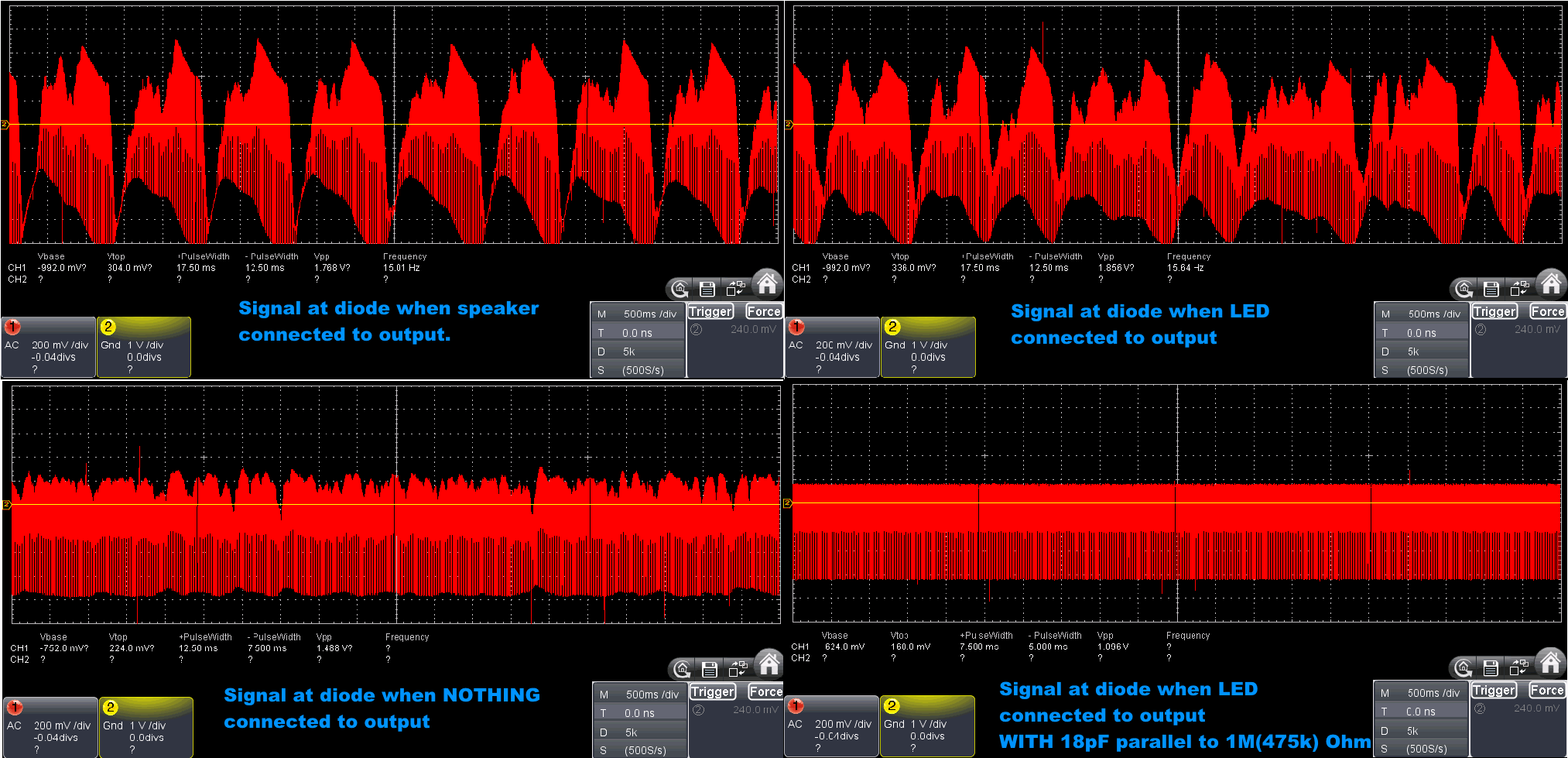

                      Tried this with an 18pF capacitor, my smallest one. Behold a miracle, the violent wah-wah noise was gone.
                      BUT, the detecting distance went way down. From 8 inches to 2 inches with a nickel.
                      Put 3x 18pF in series, not much change. It was a small wire mess, perhaps to much L?
                      I will be getting smaller caps soon.
                      I am so happy to at least not be hearing the wah-wah anymore ... Thank You! Just got to get the depth sorted.
                      Originally I thought my speaker was somehow magnetically feeding back through the detectors coil.
                      That is when I used the LED instead of a speaker. Similar result.
                      Checked when nothing is connected to the audio output of the detector. There is a visible difference oddly enough.
                      Here a composite of all four measurements with what is what in the picture:

                        18pF across 500k Ohm = 17kHz roll-off so noise/oscillation lower but so is response.
                        1-2pF is most to get needed BW and this may be too much C.
                        This was to see if the noise is coming from this amp and it seems so. But you need more BW (why response reduced).
                        Best to find where noise is coming from instead of reducing opamp BW.

                          Anyway, I then had another close look at the oscilloscope pictures I posted in my last post #70.
                          I was pondering, why is this wobble gone when nothing was connected to the audio/led output of the detector.
                          The wobble was only visible through about 1/3rd of the threshold adjustment range when audio/led was connected.
