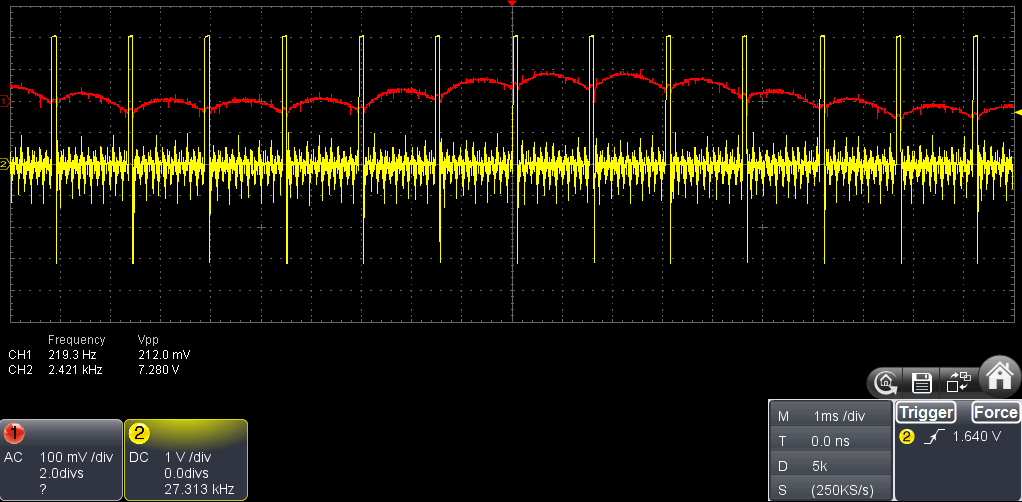

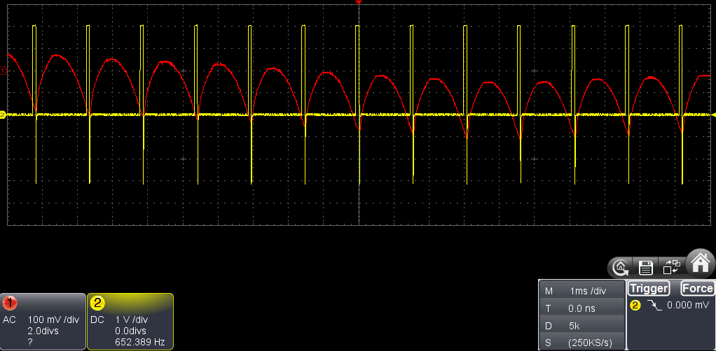

              Sorta feel lost in the thread I started, geeeez ...... Putting up more ...

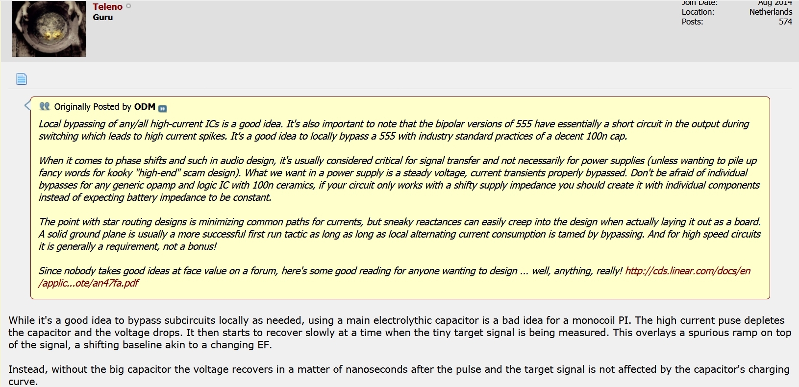

              My ongoing quest about my threshhold problem found me this tidbit (THANK YOU Teleno):
Name:	PI_NO_capacitor for coil_22811.jpg
              I disconnected C1 and found what Teleno states has merit.
              The threshold jumpiness is approximately halved!
              BUT there is a helluva lot more noise on pin 6 now.
ID:	351130 dada Click image for larger version
ID:	351132 nocnoc Click image for larger version
              Looks like the LT1054 frequency which was not a problem in my battery test before can really be seen now.
              Disconnected that again, put in second battery. Bingo, the helluva lotta noise is gone.
              Didn't do much more for the threshold jumpiness though.
              If anyone has a scope pic of threshold jumpiness of Baracuda, Geotec Baracuda, Surf PI or Hammerhead, PLEASE post.
              It would be great to have reference pictures.
              To be continued ...

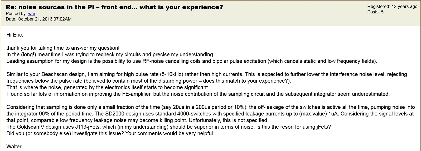

              Found this, don't understand it yet, may be interesting for others, see "low frequency leakage noise" part.

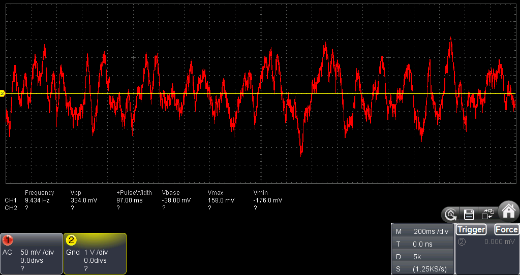

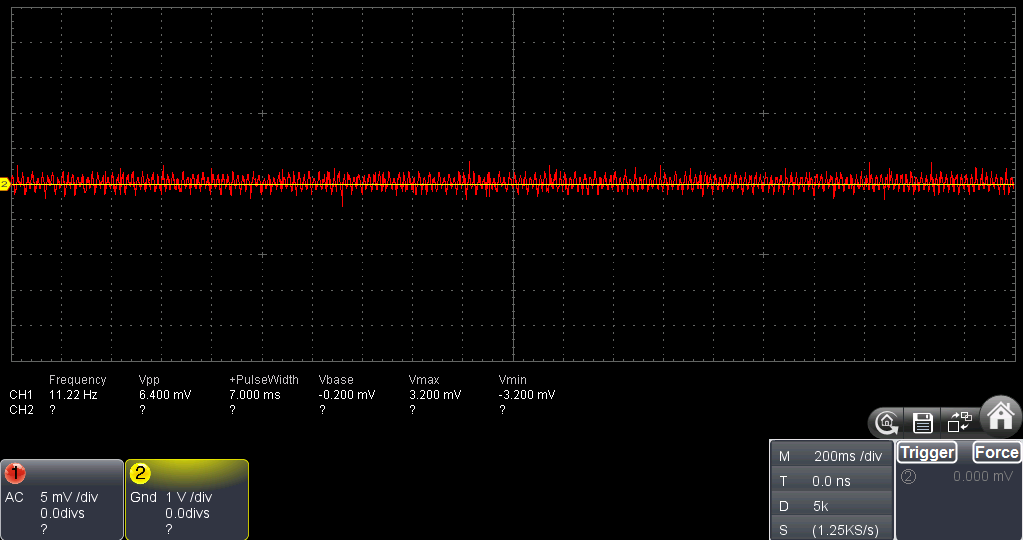

              • #52
                Interesting experiments.
                Unfortunately, I have an old analog scope so slower time base traces are very hard to see (200ms/div).
                I do have some threshold jumpiness but doesn't seem to be a problem in actual use. I adjust the threshold just above the jumpiness and run the Gain in the SAT stage much lower (~30 instead of 100) which reduces the peaks of the jumpiness.
                I do run a large value cap on the MOSFET TX and also use JFETs instead of analog switch for the sampling.
                • #53
                  Originally Posted by SVEN1 Recently rec'd some knock off Texas Instruments NE5534's, they give off a rather wonky wave pattern, not even close to what it normally looks like. The detector still functioned.
                  As soon as I changed out to a real TI NE5534, the wave form was normal.
                  Thanks Sven!
                  I will look into that as I have some TI NE5534's as you've mentioned in use.
                  I didn't get them from the bay or China, but even some of the more reputable dealers sometimes seem to have wonky parts in their supply chain
                  I got some TI 5534's from another vendor and some old Signetics ones too. What you mention was part of the problem! Good find and info!
                  Now I can discern external noise, like rotating coil etc., from the "casual" internal noise.

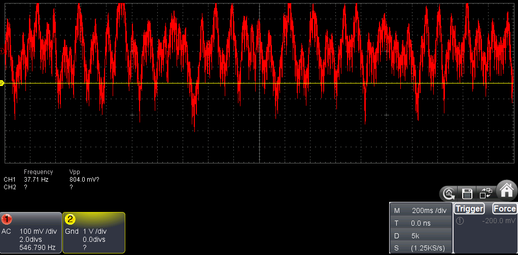

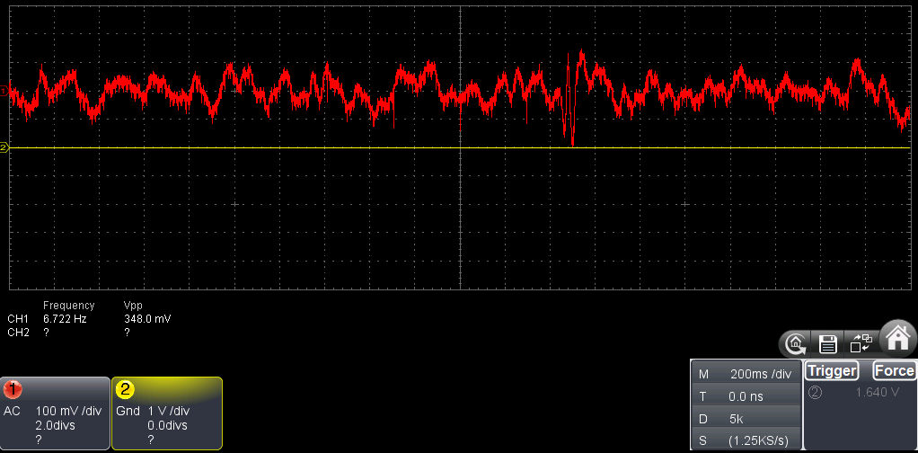

                    Here two scope pics of Pin 7 of U7(LF412) @ 200ms.
                    One with C15 diconnected and one with C15 connected again at same scope range.
                    From what I can tell the signal without C15 is dead quiet ... the threshhold sounds super solid here.
                    barageo_pin7_lf412_nocoil_noRdamp_C15no.pngbarageo_pin7_lf412_nocoil_noRdampR_C15yes.png

                    I have been wondering about this too. You're not missing anything! Perhaps the following answers your question.
                    Out of desperation I have been looking/asking around what might be causing so much interference.
                    I think I might have found one of the main EMI culprits. Perhaps some seasoned engineers might want to chime in on this one.
                    Apparently it is not continuously on, which might explain my differing results when looking at the behavior of the PI outputs.
                    In a nutshell: Transmitters for measuring ocean currents. Roughly 5 to 50 MHz. Pulsed 20us to 150us.
                    I don't know if you guys in the U.S. have problems with this at some beaches. Anyway, here's more info on that:
                    1A-SeaSonde_v2_20100331.pdf
                    The closest transmitter to me is 1.2 miles. When testing away out from town I was even closer to this bugger

                          I thought a big fat cap was crucial for coil switching. Teleno's information has helped me reduce the wobble some more. I now have a 10uF in parallel to the coil
                          which clears up the new noisy stuff pretty much as compared to the coil without a capacitor.
