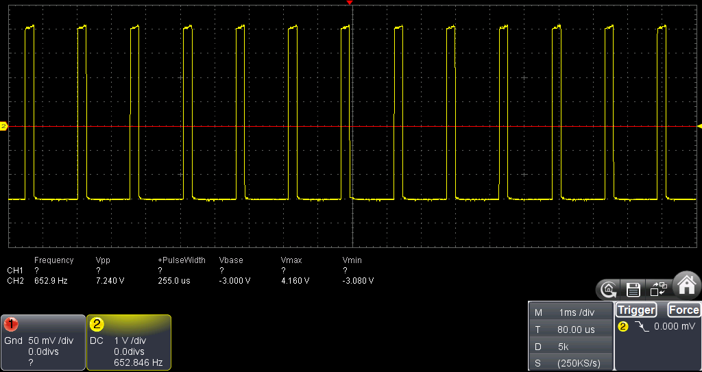

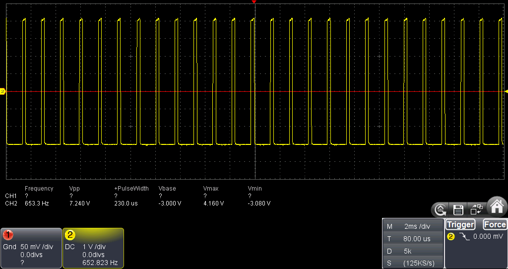

              I did make two scope pics at 1msec & erronously at 2msec instead of 10msec. If you need the 10ms one, I will hook up everything again.
              So I am posting 1ms & 2ms. Coil is disconnected and there is no damping resistor either.

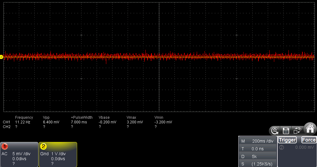

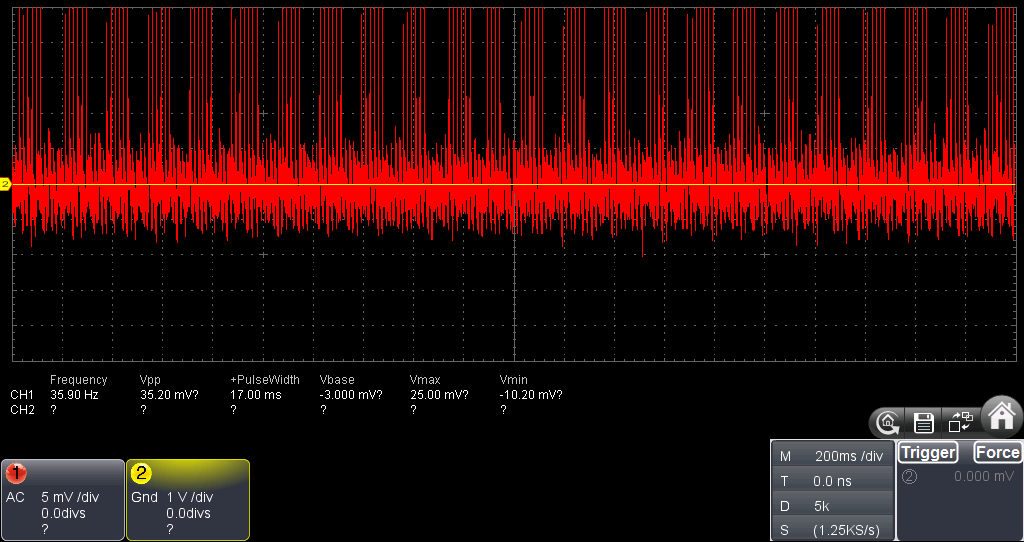

              Here two scope pics of Pin 7 of U7(LF412) @ 200ms.
              One with C15 diconnected and one with C15 connected again at same scope range.
              From what I can tell the signal without C15 is dead quiet ... the threshhold sounds super solid here.
                [ATTACH]42785[/ATTACH] [ATTACH]42786[/ATTACH]

                Thanks for the measurements. My error on the amplifier out measurement. I'm interested in the noise level at amplifier out, forgot about Tx causing a signal with coil disconnected. I'm expecting maybe 5mv p-p noise at amplifier out with coil disconnected and Tx off. I disable Tx when measuring amplifier out noise with my circuit. Maybe not needed with your circuit. 1ms time base is probably good, maybe try 200usec. Play with the scope settings and see what looks best to you trying to see p-p noise level. Disconnecting C15 verified the noise is coming from the amplifier and coil. Don't know if my estimate of noise level at amplifier out is correct with coil disconnected. Maybe someone could calculate what is expected. Don't know how to calculate expected noise level at U7 pin7 knowing amplifier out noise. Maybe someone could suggest a method.
                Maybe you could try shorting D1, D2 when measuring amplifier out noise with coil disconnected to see what effect removing resistor noise has.
                You need the damping resistor when making the noise measurements with coil disconnected.
                Might have to adjust null offset when measuring amplifier out noise with coil disconnected.
                                barageo_pin7_lf412_nocoil_noRdamp_C15no.pngbarageo_pin7_lf412_nocoil_noRdampR_C15yes.png
                                scope pictures don't look like pictures from reply #21 http://www.geotech1.com/forums/attac...2&d=1523301124 http://www.geotech1.com/forums/attac...4&d=1523301171 what am I missing?
