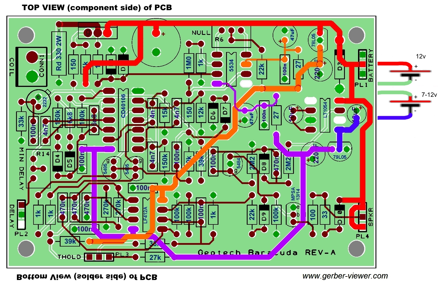

            Here a picture of how I understand it, just to be sure:

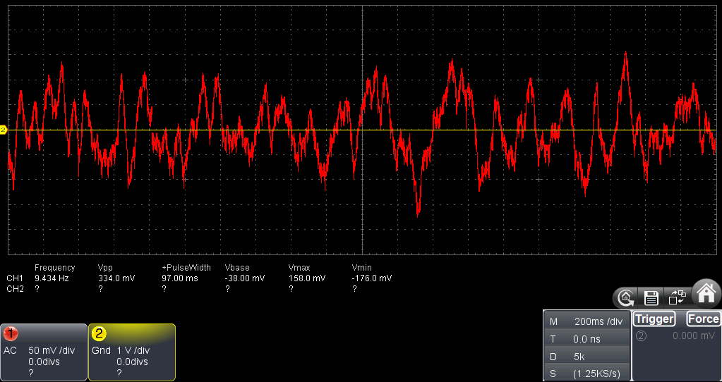

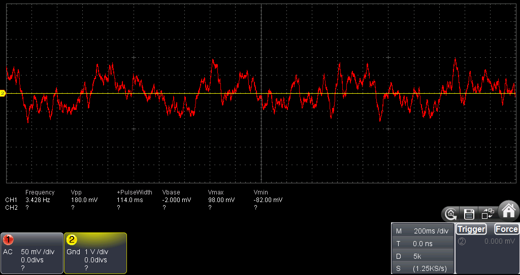

              Both are without trace persistance.

                I'm sure it doesn't matter. On my Geotech Baracuda board I shorted out R22, and reduced the 4mV ripple to zero. There was no detectable difference in the preamp output. This is exactly the same power supply filtering arrangement as the Hammerhead design, and there's no problem there either.
                Polymer appears to have an error on his board somewhere.
                  [ATTACH]42721[/ATTACH]

                  Battery connection diagram looks good. You now see how to get a Negative Voltage using two batteries.

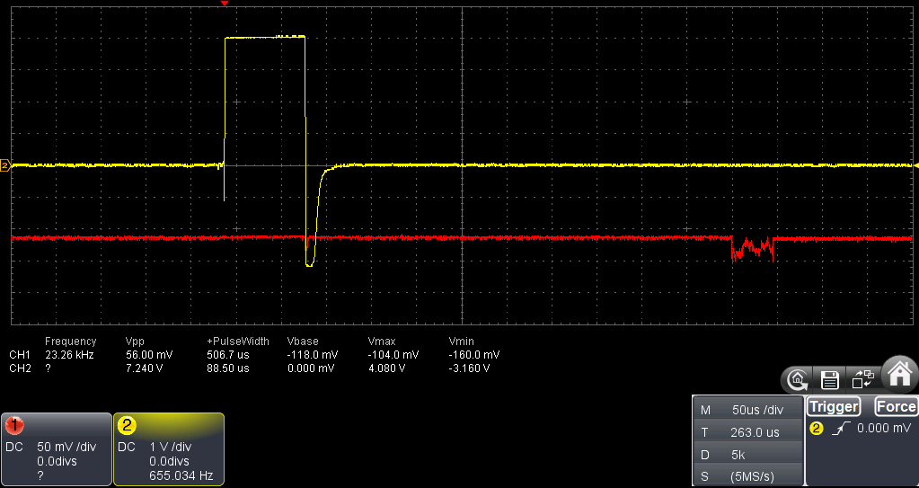

                    I probed the Q2 jfet like you advised. I also probed Q3 as a comparison.
                    Both gate signals look good to me coming from pin 10 & pin 12 of the 40106.
                    The output of Q2 (second sample) does not look good to me.
                    It's in the right position timewise though. But who am I to say ... Here's the pic:

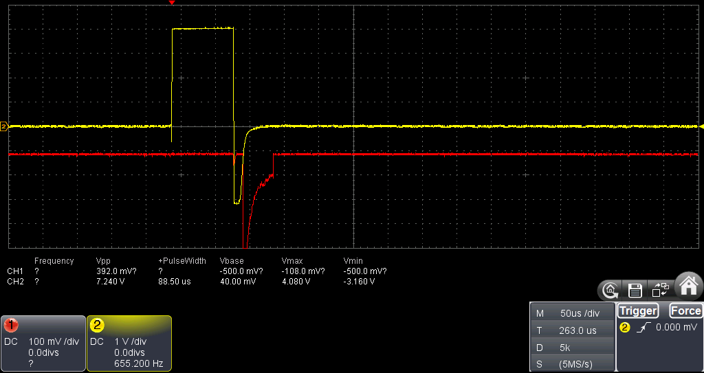

                    Here the screenshot of the measurement of the main sample at Q3.
                    Looks somewhat "better", but the signal shape is odd to me nonetheless.
                    I have no reference scope pics of them working at "nominal" value.
                    Just a somewhat wild guess here from what I have learnt so far about jfets:
                    - They may be ESD partially damaged
                    - The wide range of Upinch in these components may be causing problems
                    What is your take on these signal shapes?

                      The second sampling looks pretty noisy compared to the first sample.
                      It does seem the two samples are doing what they should in the scope trace on the Integrator output in Post #14. !st sample increase signal, 2nd sample decrease signal.
                      Now trying to not get your project confused with someone else's (the MPP rev E) but could have a similar problem.
                      Possible the wobbling is due the AC mains interference. Have you taken the detector far from the house and AC mains?
                      If the wobbling goes away then that is the problem. My HH detector does this when the heater kicks on a few feet away in my shop but is fine when away from the house.
                      Another possibly thing to try is increase the delay a few usec. You do have the 1st sample a bit early and sampling a little later may help.
                      Also possible one or both the JFETs are not working properly OR U7 needs better caps on its power pins (adding caps may help).

                        Yes, of course! here you go:
                        [ATTACH]42722[/ATTACH]
                        [ATTACH]42724[/ATTACH]
                        What is the best test procedure to determine the cause of noise and how to minimize it? My thoughts, maybe someone that knows could suggest the correct procedure.
                        Pin 7 of U7 is the important test point to monitor, 200msec/div. Noise pickup from coil would vary with location so testing with coil disconnected would be best. Lifting one end of R16 or C15 would remove amplifier noise. Record p-p noise at U2 pin6 to see if noise is near what expected could be a place to start.

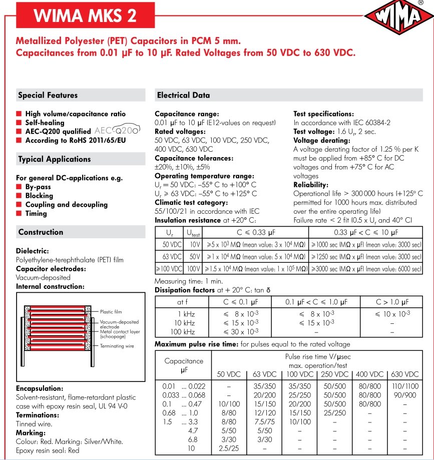

                            One thing is the possibility that the AC coupling Cap from Pre-amp to Integrator is causing the issue. Maybe this cap is the wrong type, quality.
                            With many, many cap types the capacitance changes with Voltage and we know the Voltage at the pre-amp output goes rail to rail.
                            Exactly what cap is used here?
                              interesting thing i though... i did bara board to decise all problem of people... but sametime George also run in the process...
                              strange enough that problems are still not fixed and only growing up )))
                              Don't know if there is a problem. Amplifier and resistor noise are expected, also noise from coil pickup. I think what is needed is a test method to determine if noise level is higher than expected. Would be nice if someone would post a scope picture of U7 pin7 of a good bara.
                                Been thinking of what might be the problem.
                                The C15 on the board is is a 100nF WIMA MKS 2 (100v).
                                I think the quality is ok. Here's a part of the datasheet: Click image for larger version
