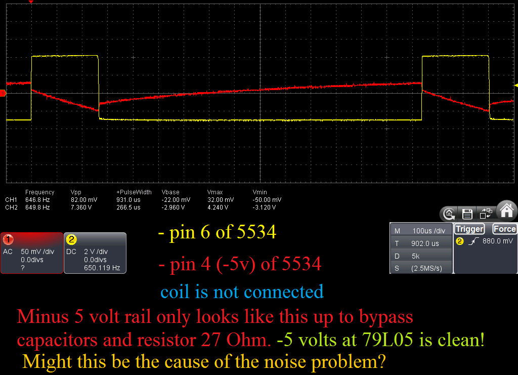

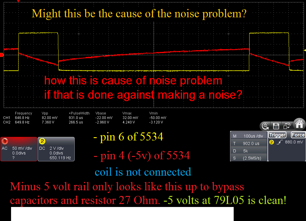

Not so DC waveform of minus 5 volt rail at the ne5534 - could this be cause of noise problems
  • Not so DC waveform of minus 5 volt rail at the ne5534 - could this be cause of noise problems
    I have a very jumpy threshold and am trying to hunt down where all the noise is coming from.
    I found this rather odd waveform on Pin 4 of the ne5534. It should be -5 volts DC.
    This funny signal only gets to the bypass caps (47uF+100nF) and 27Ohm resistor.
    The -5v DC on the other parts of the board are just fine!
    From what I have learnt here, opamps are pretty sensitive critters.
    So could this funny DC be causing noise problems and what could be done about it?

    Oh, here's the osc pic, nearly forgot: Click image for larger version

    Your scope is set to 50mV AC for that rail, so it would be very surprising if the voltage there was any different.

      That's perfectly normal. The "wobble" is caused by the fact that the LT1054 output is paused during the TX-on period. If you like, you can kill off the "wobble" by disabling the LT1054 sync circuit, but this will leave the voltage converter in free-running mode. Whether one solution is better than the other can only be found by experimentation.
        Has anyone else seen this on their Geotech Baracuda?
        this is called 'synchronization of LT of outer signal', in your case this is circuit C21 R25 D8. you can always disconnect it doing LT working 'as-is'. seems you need to read datasheet on LT or 7660...
                      I think there's a misunderstanding here.
                      The -5v output at the regulator after the lt1054 is just fine - a nice flat DC signal as far as I can see.
                      The -5v rail on pin 7 of the 40106 is just fine too. Flat as a tack DC as well.
                      It's the -5v on pin4 of the ne5534 which has this "noise" on it. It's synchronous to the PPS obviously, but how is it getting there

                        When the -5V drooping is Synchronous with the TX pulsing then it should NOT effect RX noise. Since the -5V out of the regulator has no droop and there is a series resistor to the neg rail pin of the op-amp means that op-amp is drawing a good amount of current. The Vdrop times the series resistor value (27 Ohm) equals the current draw. This is when the TX is ON which is then OVER VOLTAGING the Op-amp (driving its output to the power rails which is drawing more current. This is what you see.
                        It may be possible that the NE5534's Bypass caps are not being effective. Maybe try a different 47uf (or other value) & 100nF caps.

                            I have put another 100nF ceramic cap directly from pin 4 of the 5534 to the ground plane of the 1k resister next to it.
                            That didn't change anything. I then popped in a 100uF cap in the same position.
                            Didn't want to unsolder the 47uF first to find out it's not the problem.
                            The DC signal at pin 4 of the 5534 is for what I can see, quiet now , so that is solved.

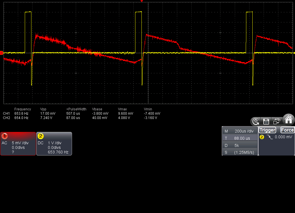

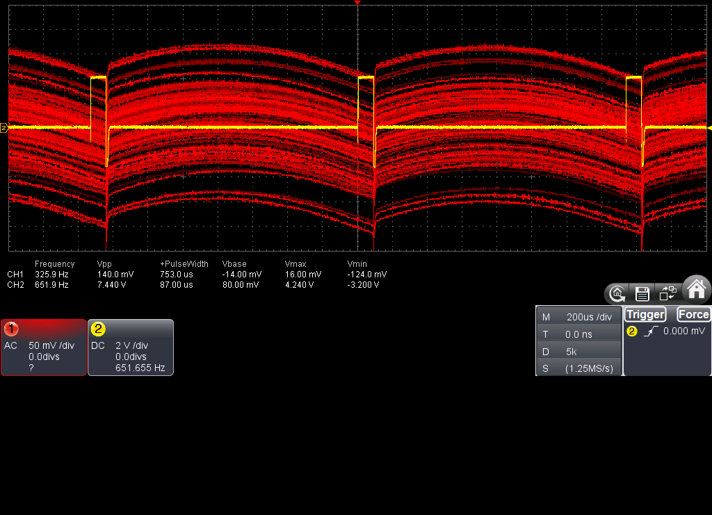

                            Here's the output of pin 1 of the LF412 like you asked (This is the output of the integrator stage U7a I believe)
                            The first pic is the signal in normal display mode.
                            The second pic is the signal in persistance display mode (5 seconds) to easily see the amplitude of the wonkiness here.
                            The jumpiness is already in that stage, with the threshold loudspeaker output dancing to this signal.

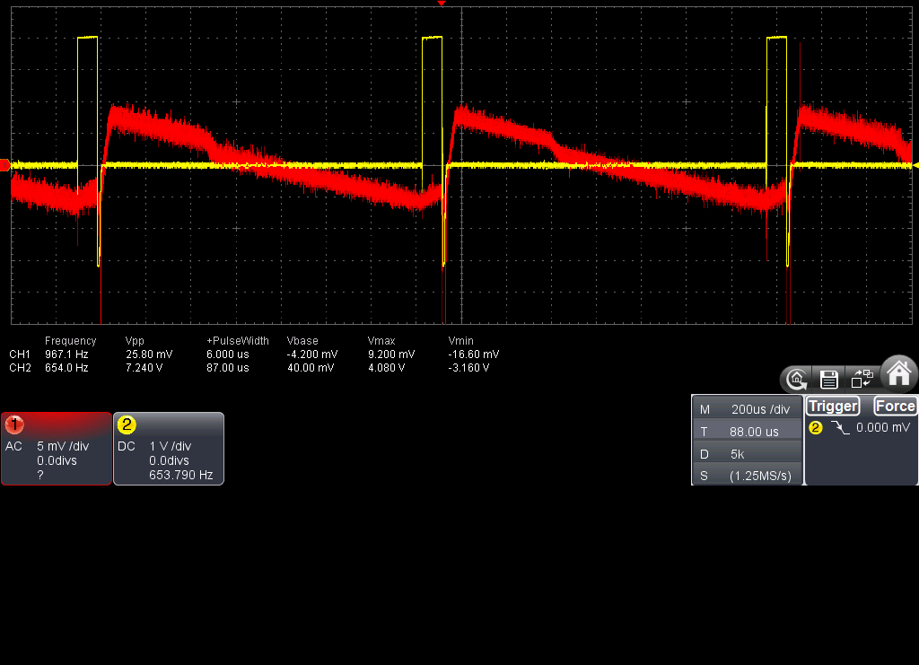

                            here's another on from pin 7 of the LF412

                              Sounds like either R22 (27 Ohm) value is not correct as has been suggested (did you check?) or the 47uF cap is NOT a Cap. Adding a 100uF seems to have fixed this so that should be good enough.
                              Your scope capture of U7a Output (pin 1) looks like the Offset from the Pre-amp is not adjusted correctly- but the pre-amp is AC coupled (cap) so can not be the case here.
                              OR - the second Sampling switch (Q2) is not working correctly.
                              Re-check the second sample pulse and Q2 is switching. Scope probe on Q2-R26 connection should show a change of Voltage level when Q2 switches on.
                              Look at Q3 output and the RevD to see what this point should look like.
