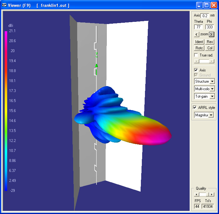

        • Oh yes,
          you remembered me to my 2.4 GHz WiFi antenna developments last year. It was quite interesting to get an internet access through several km's downtown. Here is one of my several developments: a high gain 21 dbi franklin antenna.
          model source: http://mitglied.lycos.de/pp4nec2/files/index.html
          Aziz

                            Probably because someone, whose name is Franklin, did probably invent this type of antenna array.
                            The page you are looking for cannot be found. Use this page to navigate to the part of the site you are looking for.
                            See on page 1 figure a)
                            This antenna is optimized for 2.4 GHz for an impedance of 200 Ohms. You need a balun to change its impedance into 50 Ohms (WLAN).
                            I have a prototype of this antenna and it is working well (for WLAN). But probably not convenient for a GPR project.
                            If the reflector is reduced (removing the wings), it could give still a good directional antenna. But then, the antenna has to be recalculated (optimized).
                            Something like this:
                            These antennas are also called "Amos" in the web:
                            This was not my invention. So there is no need to alter your books.
                            Aziz
