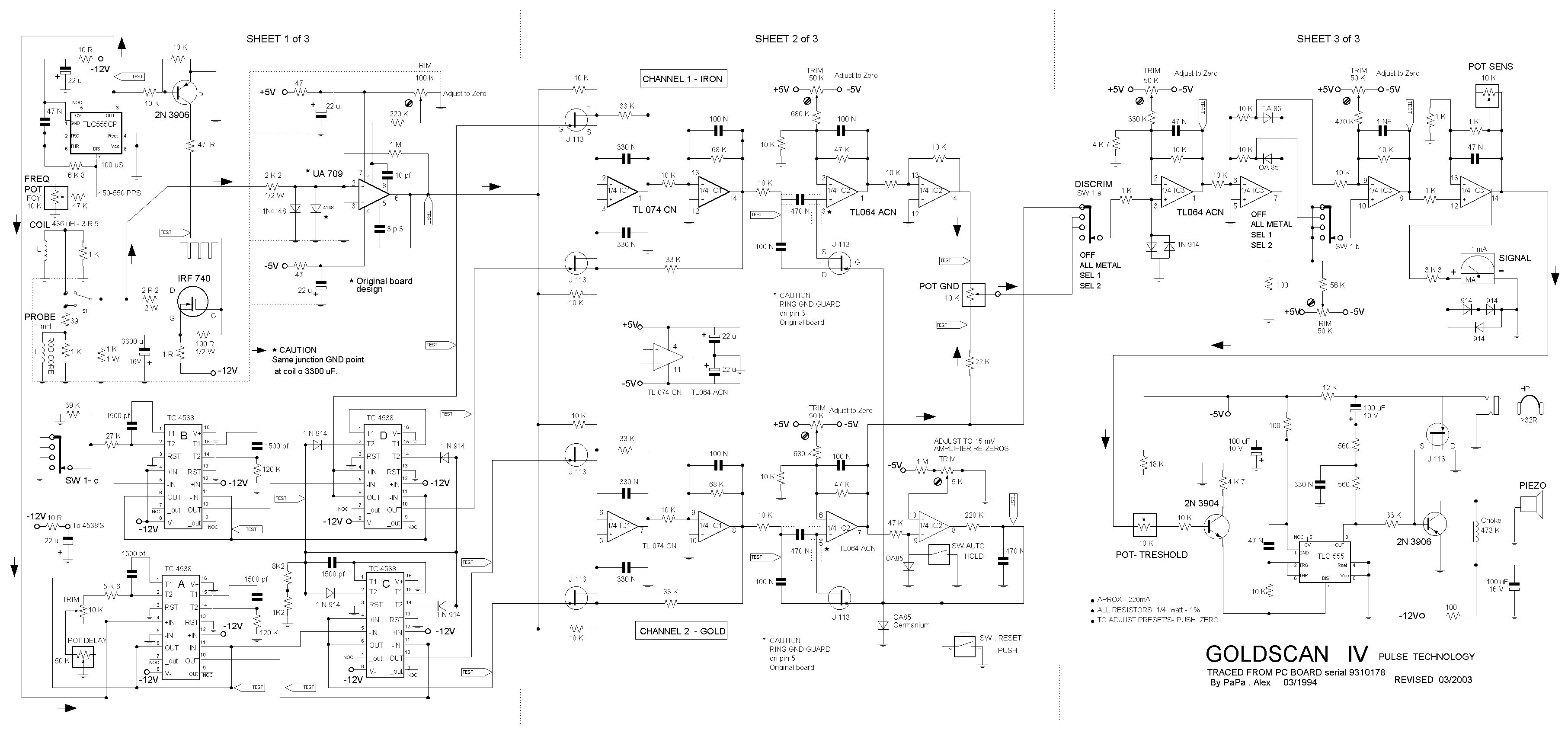

      Please see GoldScanIV schematic.
      If understand correctly, is it trying to discriminate via different delaying?!

        You have to understand that there is a big difference between rejection based on target conductivity and the way a VLF discriminates. Using target conductivity does not provide reliable ferrous discrimination.
        I think the so-called ferrous rejection in the Goldscan IV works in the same way as the TDI. That is, it hijacks the ground balance sample to create a "hole" in the target response which corresponds to the conductivity of small ferrous targets (such as nails).

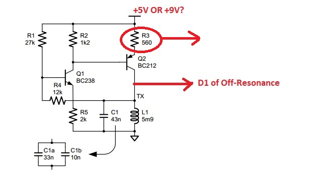

            I want to build your Off-Resonance inside of p. 37, IMD book. But i'm going to change its TX schematic with the attached (raptor TX).
            See attached,
            1- Should i use 5V or 9V?!
            2- Should i R3 with 5K pot or it's OK? (R3 should be adjusted for maximum amplitude at the collector ofQ1.)

              That won't work.
              The original off-resonance oscillator is designed such that the bias voltage is dependent on the oscillator frequency. As a consequence, the bias voltage is also sensitive to changes in coil inductance. This is not the case with the Raptor TX.

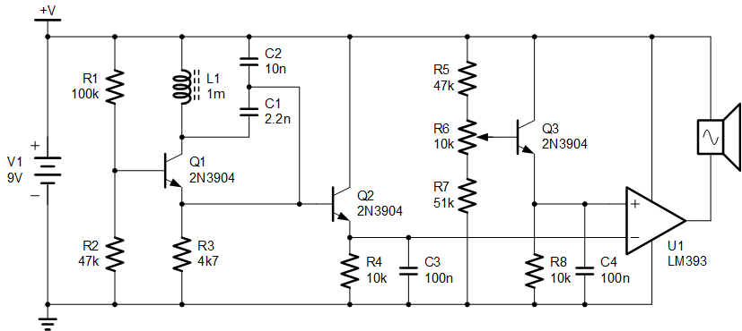

                • Here is an example circuit using a Colpitts. I do not guarantee this circuit will work (I think I built it many years ago) and it will certainly have some temperature drift. Technically none of these are "off-resonance" but rather something called "energy theft."
                    [ATTACH]56607[/ATTACH]

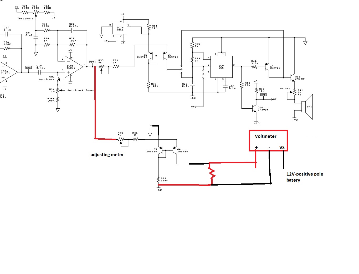

                      I want to add a Voltmeter in your HH1 so that it shows 0 number for no detecting metals. As soon as detecting, the number is increased. Do you think it's possible?
                      • Yes, I think we have already discussed this.
                        • Yes, i used an analog VU meter and works very nice.
                          Now, i want to replace a digital VU meter instead of it.
                          Unfortunately, i can not find a digital numeric VU. So, do you think is there a method that be able to use a regular digital voltmeter for it?

                          • Replace the VU meter with a resistor and connect the voltmeter across the resistor.
                            I don't see anything new in the link. PI can only do pseudo-discrimination.
                            • Thanks for your guiding.
                              Is it correct?
                              • Yes
