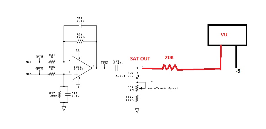

          See attached, Did I get it right?

            That's it. It picks off the integrator output.
            Note the 20k is for a 500uA meter. Check or measure your meter and re-calculate the resistor value.
            Here are the notes on my schematic:
            Integrator output is +5V to -5V
            referenced to ground (+VB)
            This is 0 to 10V referenced to 5V-
            600 Ohm * 500 uA = 300 mV to move meter full scale.
            R90 forms a Voltage divider with a ratio of 0.3/10
            So 600 Ohm /(.3/10) = 20k Ohm. A19.4k Ohm resistor is
            close enough to move meter to Half scale whrn integrator outout is Zero.

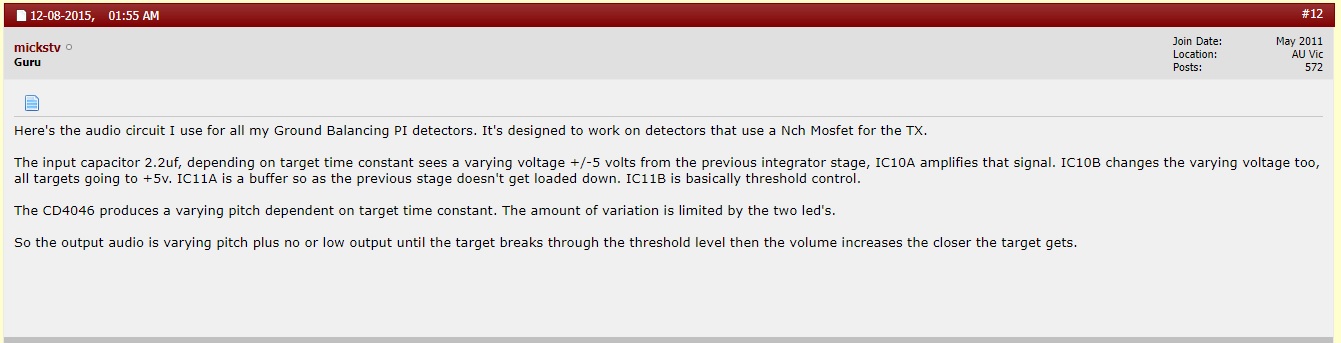

            • Thanks dear Walter for your guiding.
              As you know, i have built two versions of HH (1-HH1-Rev-D, 2-With GB).
              Both of them works very very nice. About GB version, i changed its audio part and i added Mr. MickStv's schematic.
              According to your advise, i have to use the VU+resistor in my GB version.
              Is it possible to tell me which point of MickStv's schematic is the best for connecting to VU?
              For more understand, you can read in attached Mickstv's explanation about his schematic.
