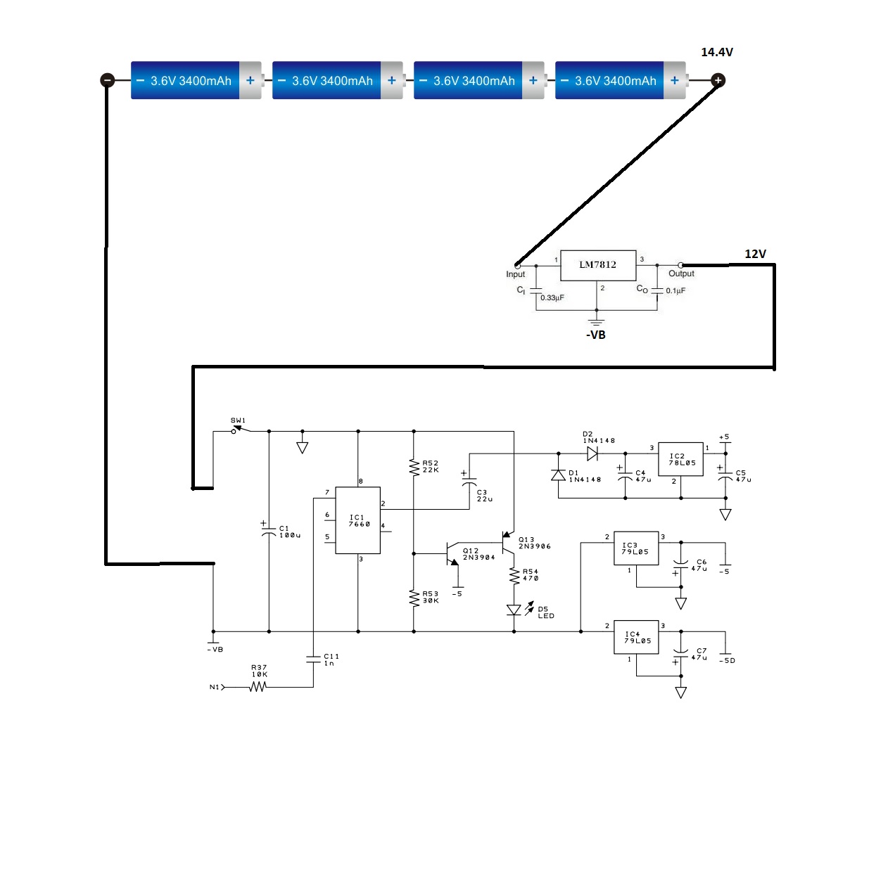

      Please see attached, i'm going to use four 18650 Lithium ion batteries for my HH1.
      As you know, voltage of HH is 12V and its ground is +VB. Is it possible to see attached and tell me whether i can the schematic for my HH or not?!
      Thanks for your kindness.

        Hello
        Dear Carl

        The maximum input voltage for a 7660A is 12V, and for a 7660 it's 10V.
        The nominal voltage of your battery pack is 14.4V.

          Please see attached, i used a 12V regular.
          Do you think it works with the regular?

            Thanks dear Qiaozhi.
            [ATTACH]56660[/ATTACH]
            That should work ok.

              For last question, do you think ground pin of regular (middle pin) should be connected to +VB or -VB?
                Thanks.
                Middle pin of the regulator should be connected to -VB.

                    Wondering why you suggest that should work. His schematic shows ICL7660, rated 10.5V absolute maximum supply volts.
                    • Yes, use the 7660A for 12V. Better yet, replace it with the LTC1144 and you can get rid of the extra 7812.
                          I've already pointed that out. Please see post #168.

                              That was in answer to Green's post, not your's.
                              • IRF840 is fine. It's a little better than the IRF740.
