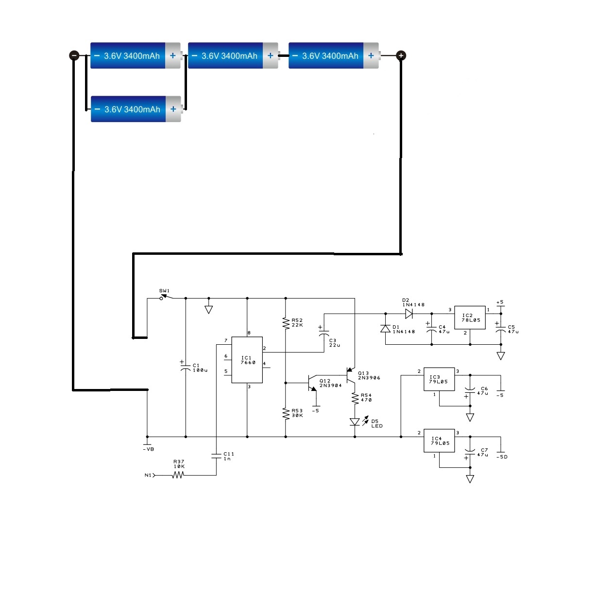

          • The 12V regular should work IF a 7660A is used.
            The 3.6V per LiIo cell is the Nominal Voltage. At full charge they are 4.2V per cell so 16.8V for 4S.
            This does waste power since the Voltage drop across the regulator times the current equals power as heat.
            I use a 3S LiPo battery on my HH2. 12.6V at full charge, 10.8 discharged but indicate empty battery at 11V.

              For keeping more charging, i'm going to use 4s but one of them is as parallel. In this case, we can remove 12V regular and keep more charge for more duration.
              Please see attached, do you think it's OK?

              • The one parallel battery won't make any difference in overall battery life.
