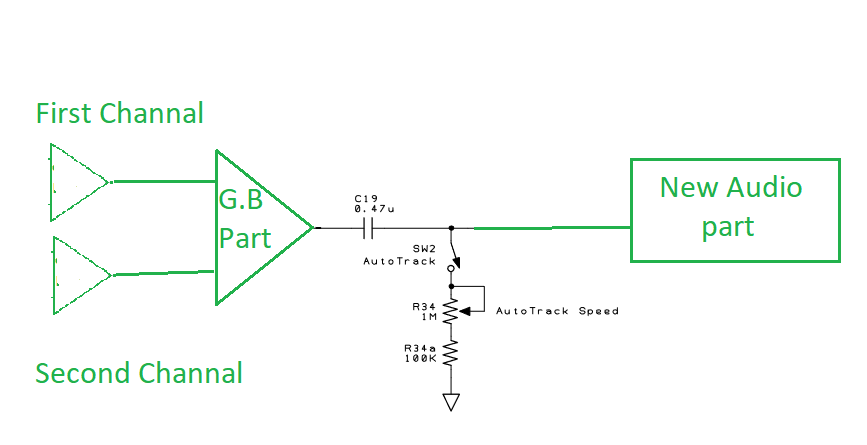

            Hello
            Dear Carl
            I hope you feel good​. Please forgive me for my more questions.
            As you know, i added G.B and a new Audio part to my HHD and it works very nice but i have a problem with its AutoTracking part.
            I tested it more and more and it doesn't work at all. In other words, it has no effect on the HHD and it is non-motion mode.
            But its motion mode is interesting because i have a nice audio in motion mode but i have a constant hissing sound in non-motion mode.
            ​Do you have any suggestion for solving this problem?
            • The design of the "New Audio part" must have near-zero input current, otherwise you will quickly rail out the input and nothing works. Otherwise, I don't know.
                Thanks dear Carl.
                My audio is Mr. Mickstv's schematic. The schematic is post integrator/BPfilter stages of PI design.
                Before connecting the schematic to HHD, we must adjust output of first opamp to zero volt via a pot.
                Is your near-zero input current as the zero volt of the first opamp?
                • Either post the schematic or provide a link to it please.

                    • I still don't understand. Is C8-R20 above the same as C19-R34 in post #335?
                      Back when I did the Hammerhead design I should have called this function "autotune," not "autotrack." It has nothing to do with ground tracking, it is merely a threshold retune feature. Normally this is done in the integrators immediately following the demods, not after the GB subtraction.
                        Hello
                        Sorry for my delay answer.
                        No, both of c8-R20 and c19-R34 independent.
