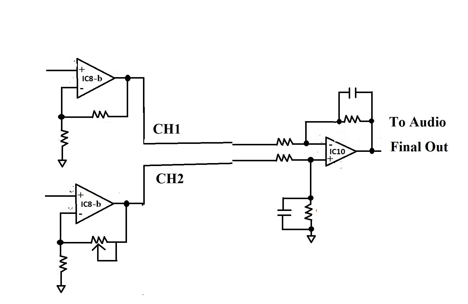

              Time that the question has engaged my mind. Please first see attached, it's my two channels for GB processing. In fact, we use the GB pot (in ch2) for reaching zero volt at final output.
              The my question is here! I don't connect any coil to my PI, so we must have a static dc voltage at output. But i have a voltage fluctuation output in without using coil!. For example, 2.741-2.750 V.
              This fluctuation will show at audio sound and unfortunately i have not a stable audio in basic mode. Do you have any suggestion for solving such problem (for stabilizing audio)?
              Thanks for your kindness.

              • This most likely due to thermal noise generated within the circuitry. Probably CH2 is worse because it typically runs at a higher gain. You can't get rid of all the thermal noise but you may be able to improve it. That requires knowledge of noise analysis. Search the forum, there have been discussions on this.

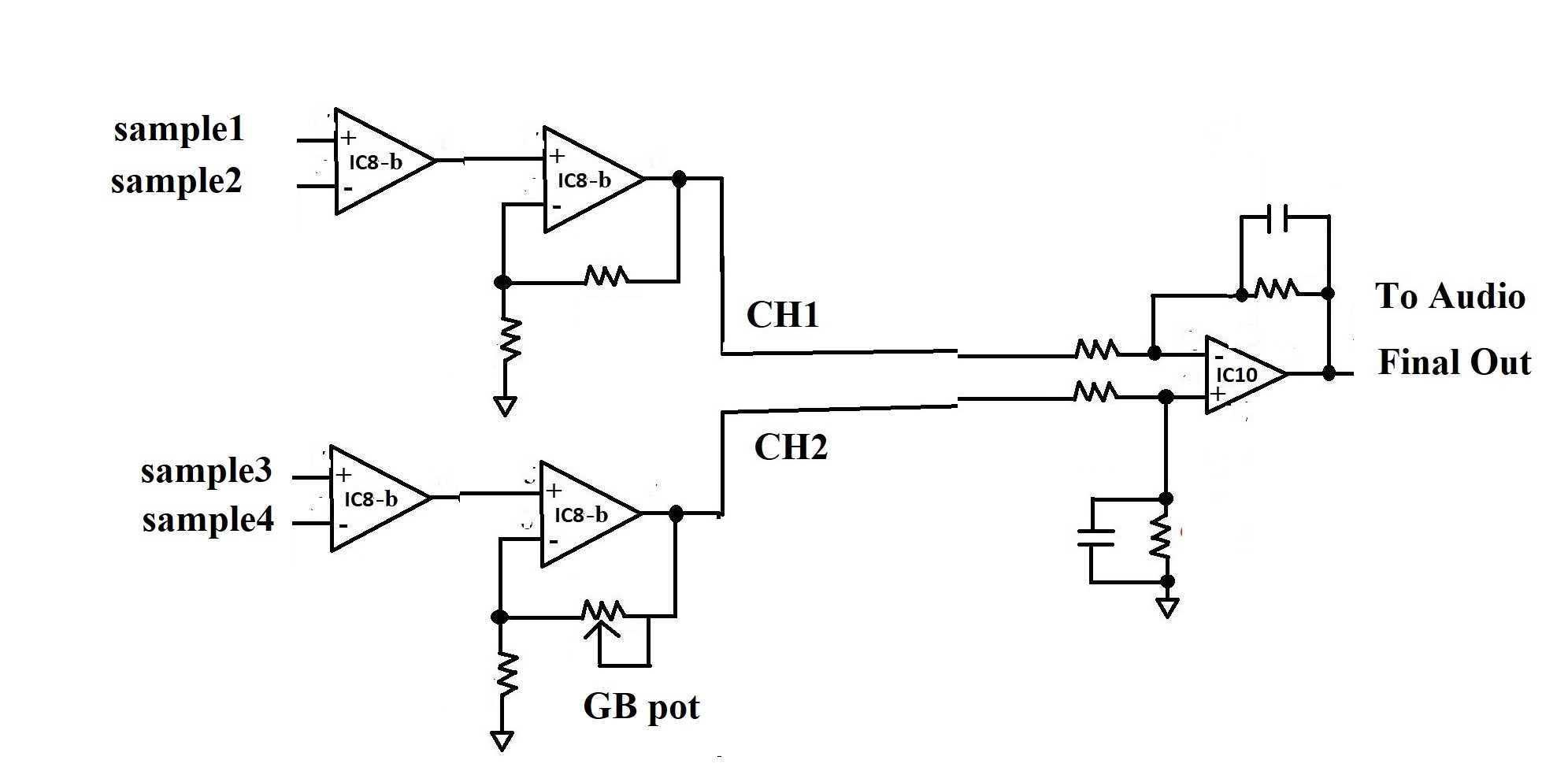

                  As you know, i added GB (based on 4 sampling) to HHD (attached). Now, my HHD works as non-motion mode so that it produces a constant audio (noisy audio) if i keep a target near the coil.
                  Do you have any suggestion for changing my HHD to motion mode? I also added its SAT part but it had no result.

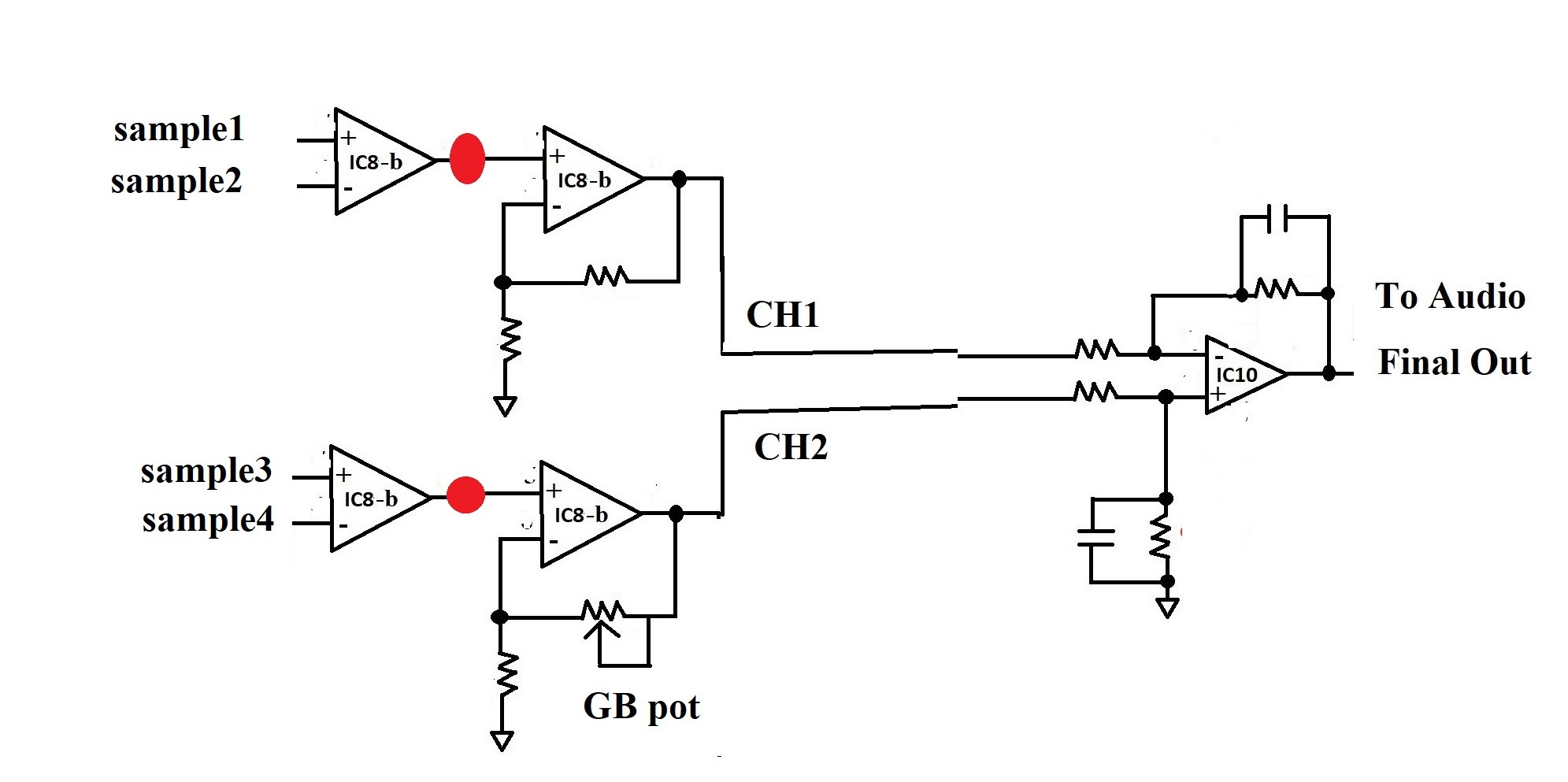

                    Do you think i should add two SAT at CH1 and CH2, before subtracting and gain ?
                      I already added SAT at final out, no result.
                      Yes, that's the way I would do it. Here is a (very) simplified diagram:

                      It is important to closely match the delays through the integrators and the SAT stages.
                        Thank you dear Carl for your helping.
                        See attached, is the position true (red points)?

                        • Yes.
                            Yes.

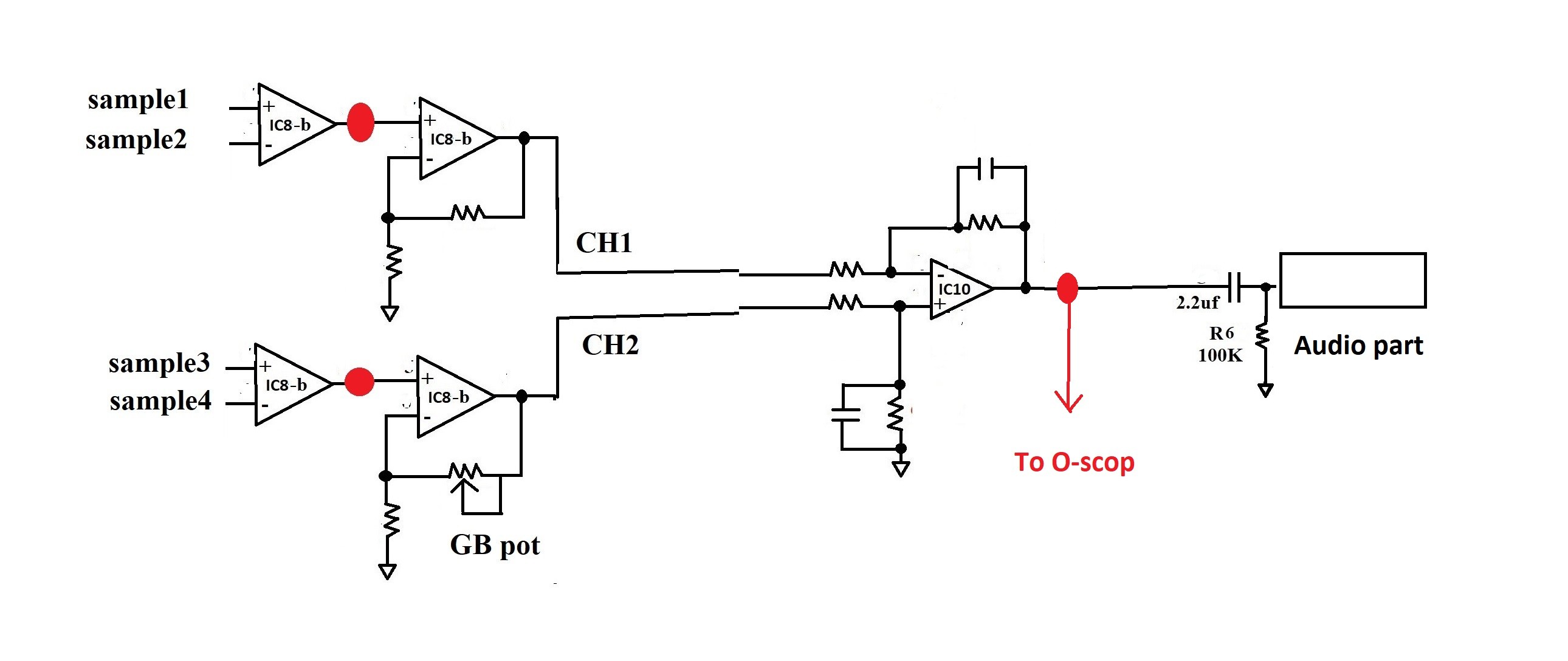

                              Hello dear Carl
                              Before everything, thank you for your guiding (changing non-motion to motion).
                              According to your advise, i added your suggestion part to my PCB and it works motion.
                              But i have still a problem and i can not solve it.
                              For better understanding, first see attached pic.
                              I connected my O-scope to last opamp output (final subtraction, red point ) and captured a short video over O-scop from ( link attached).
                              As you see in video (o-scop), i have not a clear DC output and it fluctuates. So, my audio also will show the fluctuation voltage as shaky voice.
                              (my audio schematic is at #339)
                              What is interesting is that i have still such fluctuation output even without connecting coil! I also screw GB pot but still it is not clear dc (without connecting coil).
                              you can download my video from the link
                              https://www.mediafire.com/file/k2dy9...04509.mp4/file
                              Do you have any idea to solve the problem?
                              • If you probe the signals at CH1 and CH2 are they noisy? Be sure to increase the oscope sensitivity to compensate for the gain of IC10.
                                Circuits generate their own noise and I have no idea where your noise might be coming from. You will need to probe the circuitry, including the power supplies, to figure it out. Noise is more sensitive in the preamp because it sees the most gain through the whole signal path. Also, it would help if you posted a real schematic instead of a block diagram.
