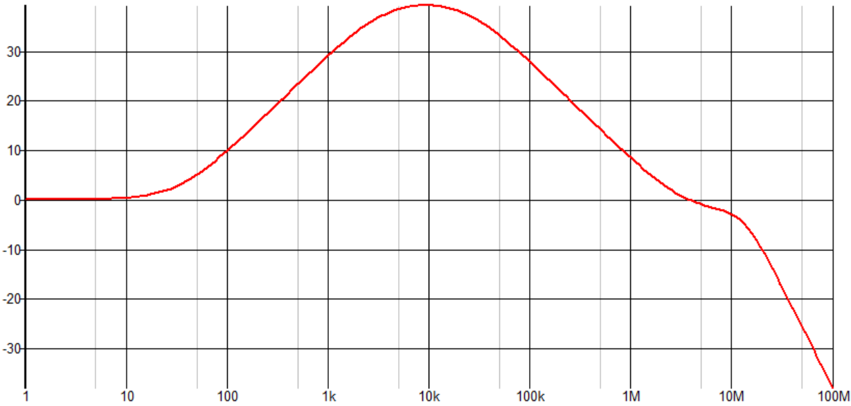

    I'll disagree, your results don't look right. Here is what I get:
    Your peak results are -29dB and it should be close to +40dB, and your highpass cutoff is too low at ~200Hz. Make sure you are using a wideband opamp (I use the NE5534) or an ideal opamp, and make sure it is properly powered.

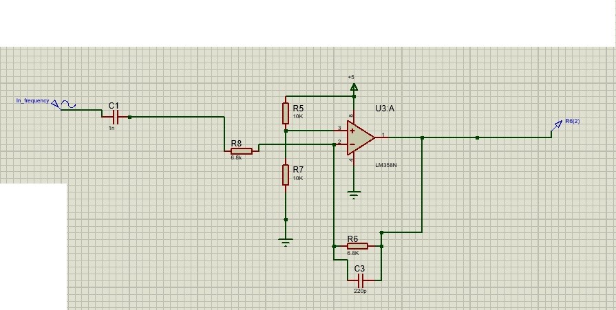

    Please see my schematic,
    Is C1 and R8 as High pass filter and C3 and R6 as low pass filter?

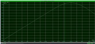

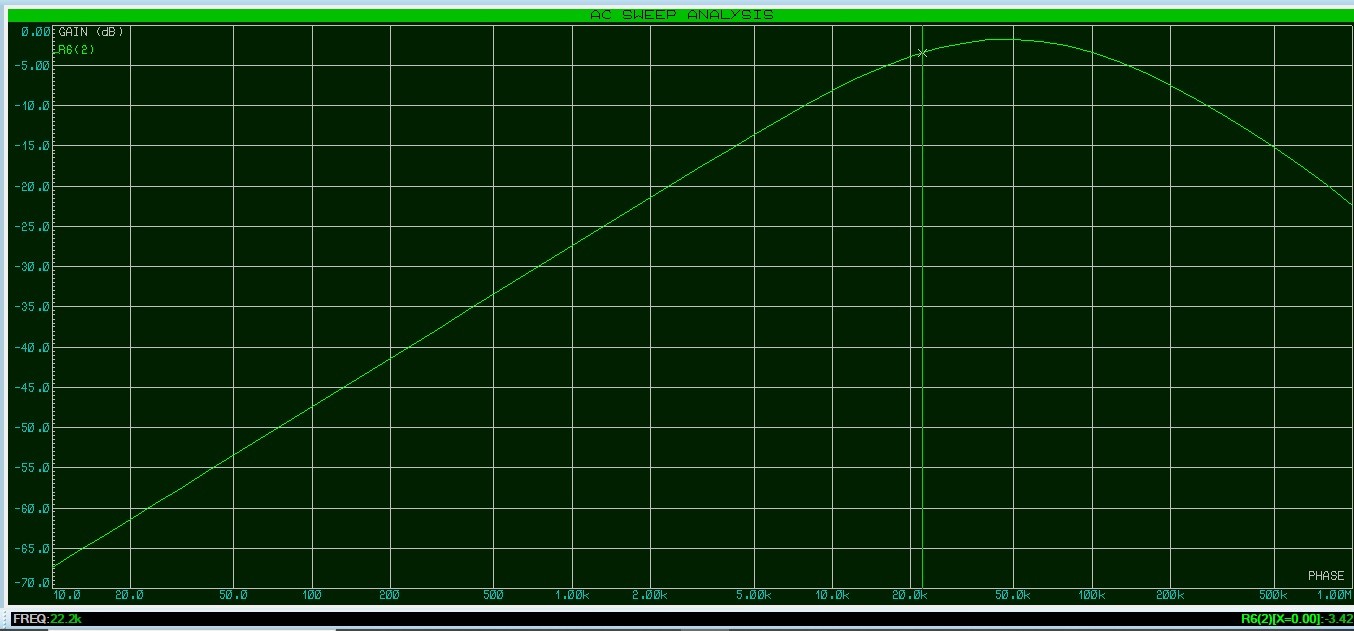

    I simulated it:
      Yes.
        I don't understand your schematic (bandpassmain.jpg) unless you are trying to build an energy-theft detector, or maybe PI. It is not what you would use for VLF. That's one of the problems with this thread, you have jumped around a lot of different topics so I often don't know what you are trying to do. It would have been better to use separate threads.

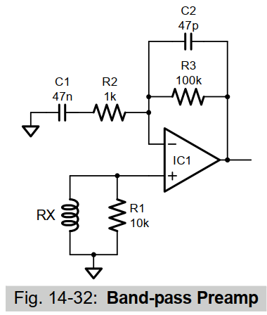

        Anyway, this is normally how I would make a VLF bandpass preamp:
        C1,R2 form the high-pass filter and C2,R3 are the low-pass filter. It would be a good exercise for you to put this in Spice and see how it works, and how to change the values to get the frequency range you want.

        About RX and R1, are they considered as high pass filter (LR)?
        • Practically, they don't affect the signal. Some detectors leave out R1, I prefer to include it to dampen potential oscillations.

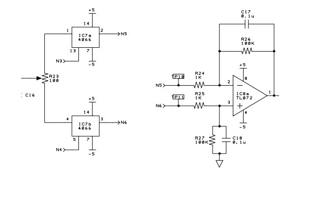

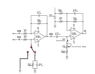

                      Dear Carl, i read your HHD articles, you mentioned that we can reach to one single sampling via removing R25 and C18 and R27, then connect pin2 of IC8 to ground.
                      I want to add a simple switch for single/double sampling on my HHD PCB.

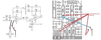

                      Do you think i can reach via following switch without removing R25 ( because i can not more edit on PCB)?
                      Click image for larger version  Name:	OneSampling2.jpg Views:	0 Size:	35.1 KB ID:	445008

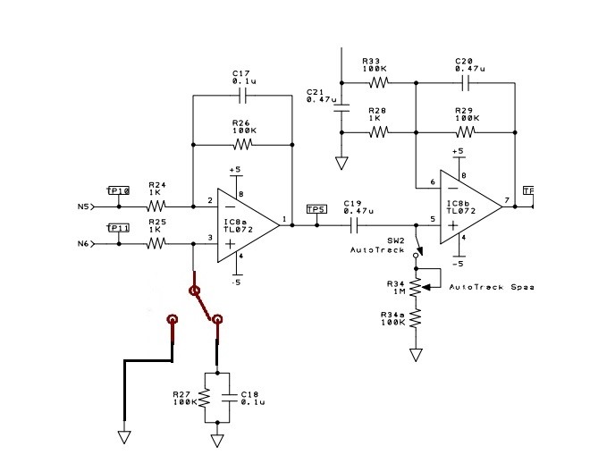

                        Ideally high inductance gives you more "transformer gain" but practically there is not much difference.

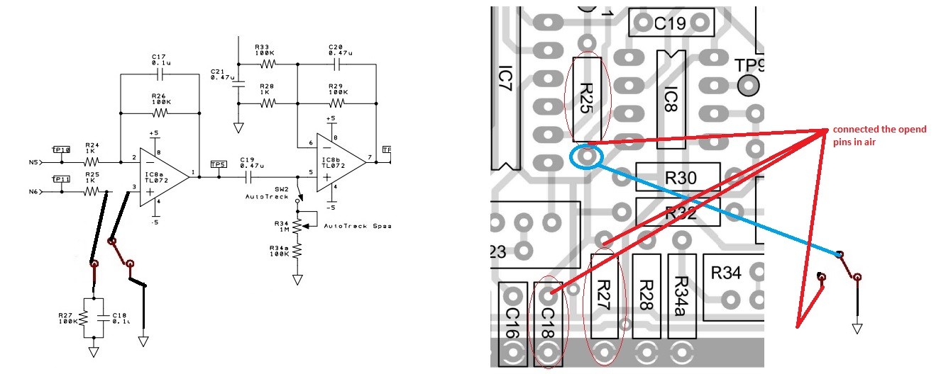

                        Please see, we have a limitation for adding switch between single/double sampling on pcb.
                        One a method on pcb is, remove one pine of R27, c18 and R25. Then, connect them ( the opened pins) together in air.
                        See attached, do you have better solution?
                        Click image for larger version  Name:	single.jpg Views:	0 Size:	118.8 KB ID:	445018
