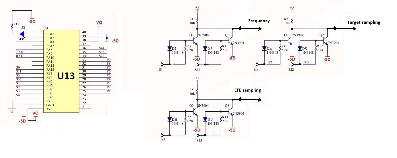

    But there is a big question. Please see your HHD schematic, i want to put both single and double sampling.
    Can you guide me what output from micro (N4) can acts single sampling?
    Other words, what output from micro can connect pin3 of IC8 to ground?
    It depends on the micro and also how you intend to create the pulses. Are you going to bit-bang them or use PWMs? There are a lot of ways to do this.

      Thank you for your supporting, dear Carl.
      My method for micro is based on PWM.
      • Then you have to use the pins that support PWM.
          Please forgive me, i can not understand.
          Please see, it is my micro and voltage level of both sampling is +-5.
          Can you tell me how can connect the EFE sampling to N4 (pin5 of 4066 switch) so that i can convert my HHD to single/double?

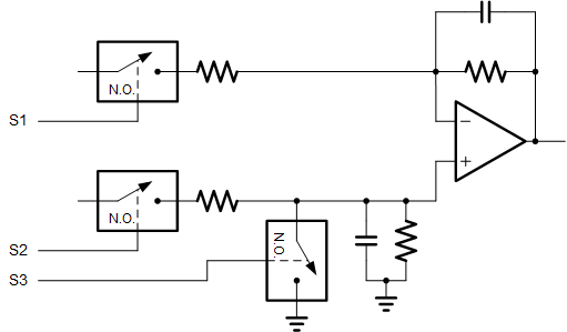

          • Probably you will need to add a third switch like this:
            Also, why are you driving each pulse with 2 pins (S1 and S11, for example)?

              Thanks.
              A friend helped me.
              I put code of target sample here.
              S0_OFF_TIME is TX.
              ALL_ON_TIME is sample width for all samples.
              //------------Code-----------
              TIM4->CCR1 = 36*200; // S1_1
              TIM2->CCR2 = 36*400; // S1_2
              TIM4->CCR1 = 36*(S1_OFF_TIME + S0_OFF_TIME ); // ON DELAY S1
              TIM2->CCR2 = 36*(ALL_ON_TIME + S1_OFF_TIME + S0_OFF_TIME ); // S1 PW​
              • Hello h9361,
                Instead of a third switch (CD4066), you could also use a FET switch like the J113. This would be easier to integrate into the circuit compared to an IC chip.​
                • JFETs won't work well in this case, where he wants to switch in a ground but the signal is bipolar.
                  • I would use one​ REED RELAY, nothing more efficient and simpler​.No changes to the code or anything else​.
                      Thanks, so i will use 4066.

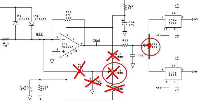

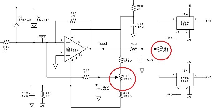

                      Dear Carl, as you know, i am re-designing HHD using Micro.
                      I want to remove R18 (offset) and R23 (trimmer). Do you have any suggestion for changing this to without trimmer?

                          So, do you think we can remove Offset adjustment without any problem?

                            • Hi h9361,
                              Yes, you can remove it. Simply leave the circuit board unpopulated and bridge the three holes of potentiometer R23 with a wire jumper.
                              Why do you want to remove the potentiometers? They are very helpful for correctly calibrating the circuit.​

                                Hi h9361,

                                Thanks dear GeoMax
                                I want to make SMD PCB.
                                As you probably know, for adjusting R18, i have to remove IC5, IC8, IC11 and IC12 and then connect pine 1 of IC8 to ground.
                                In this case, i can adjust R18 based on voltage of TP4.
                                Problem is on SMD model and we have a limitation. I can not remove this ICs from SMD, so i can not connect the pine 1 of IC8 to ground.
