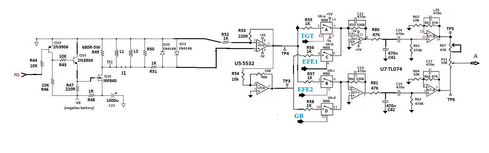

      Dear GeoMax,
      For adjusting R18 in correct point, we need to connect the DMM on TP4 (HHD PCB).
      The Correct value for R18 is Zero volt in TP4.
      But problem is that you can not see a static value in TP4!
      So, you can not adjust the R18 in correct point.
      For this, you have to stop Pulse frequency and two samplings pulse (removing 555 timer and 74hc221 ICs).
      Then you must connect out of IC8 (pin1) to ground!
      In this mode, you can see a static value in TP4 and you can easily adjust R18 for 0V in TP4.
      After adjusting, you can add the ICs in his locations and remove the conection of pin1 of IC8 to ground.
      • Hi h9361.
        Why don't you divide the preamplifier circuit into two stages? This way you'll get a higher sampling rate in the first amplification stage and better offset if you use a suitable operational amplifier. I recommend using an OPA1612AID. It's a very good operational amplifier. It's a bit expensive, but I think it's worth it. Geomax is right; you should post your final schematic here on the forum so you can get much more help from other forum members.
          Yes, that's what the documentation says: you should adjust R18 before you install R5 and the coil. You do not need to remove IC11 or IC12 for this. You only need to ground IC8-pin1 for adjusting the demod offset, and this is an adjustment that is not critical.

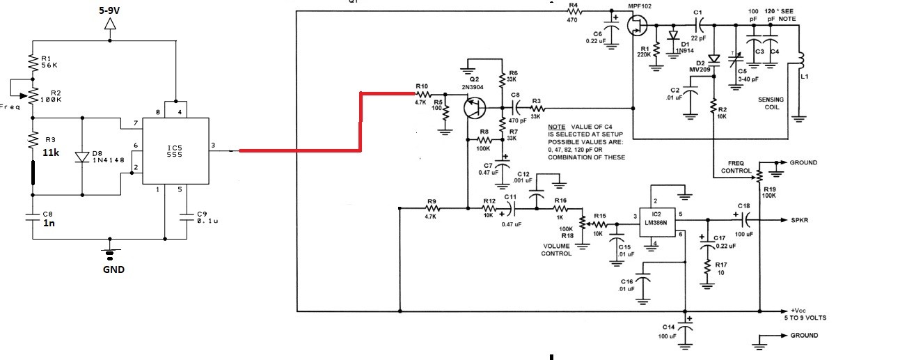

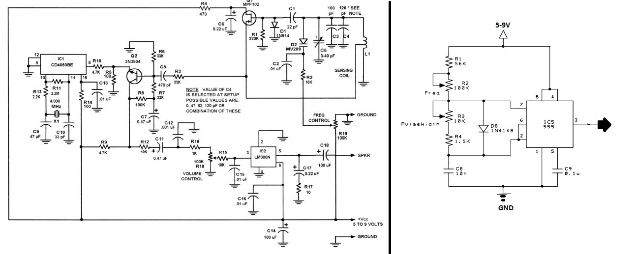

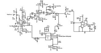

            Hello
            Dear Carl
            I hope you are in a good health.
            Please see the attached, it is a simple schematic metal detector.
            I need to use it in a specific project for testing but i want to replace its 4060 with simple 555 (7555) timer.
            Out of the 4060 is pulse, can i replace it with 7555?
            • I don't see why not.
                Thanks.
                I tried to calculate pulse width and duty cycle of 4060-output, my calculation is 8us and duty cycle is 50%.
                Is it true? because i want to set this adjustment on 7555 output.
                Please see it, do you see any error to this replacment (7555 to 4060)?
                • Probably that will work. It looks to me like the 4060 will provide a 125kHz square wave.

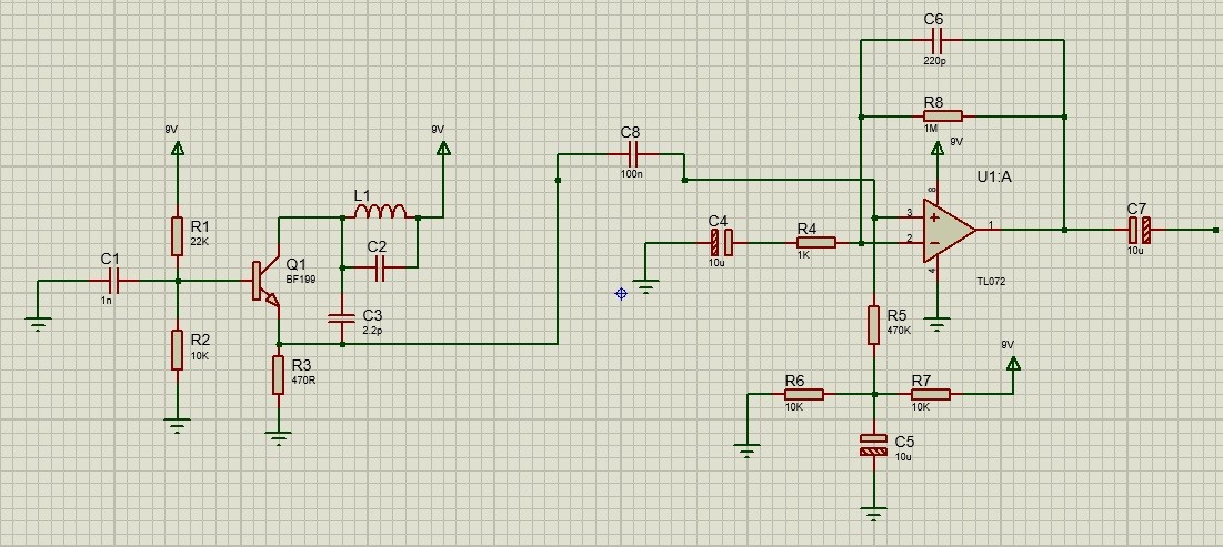

                    Hello
                    Dear Carl
                    I hope you are passing good days.
                    Now, i am working about a new idea, RF metal detecting.
                    This is a primary idea and i am playing and testing it.
                    For testing, i have designed a simple RF receiver in FM modulation ( my TX frequency is 300mHz with a pulse 400Hz audio as input).
                    Please see it, if possible. Do you see any error or any suggestions for improvement?
                    My main purpose is that i detect any small changing on audio tone (400hz).
                    since my transmitted audio is 400hz, i used 220p for 700hz filter.
                    Its final output goes to lm386.
                    Thank you.
                    • Is L1 the RX coil? Why is it part of an oscillator?
                        this is an FM receiver, L1 and C2.
                        This type in RF is called super regenerative receiver.
                        For RF, oscillator is used for Easier content extraction.
                        Do you think the schematic is true?
                        • OK, I see. As long as the circuit isn't actually oscillating then it might work. All I can say is try it and see.

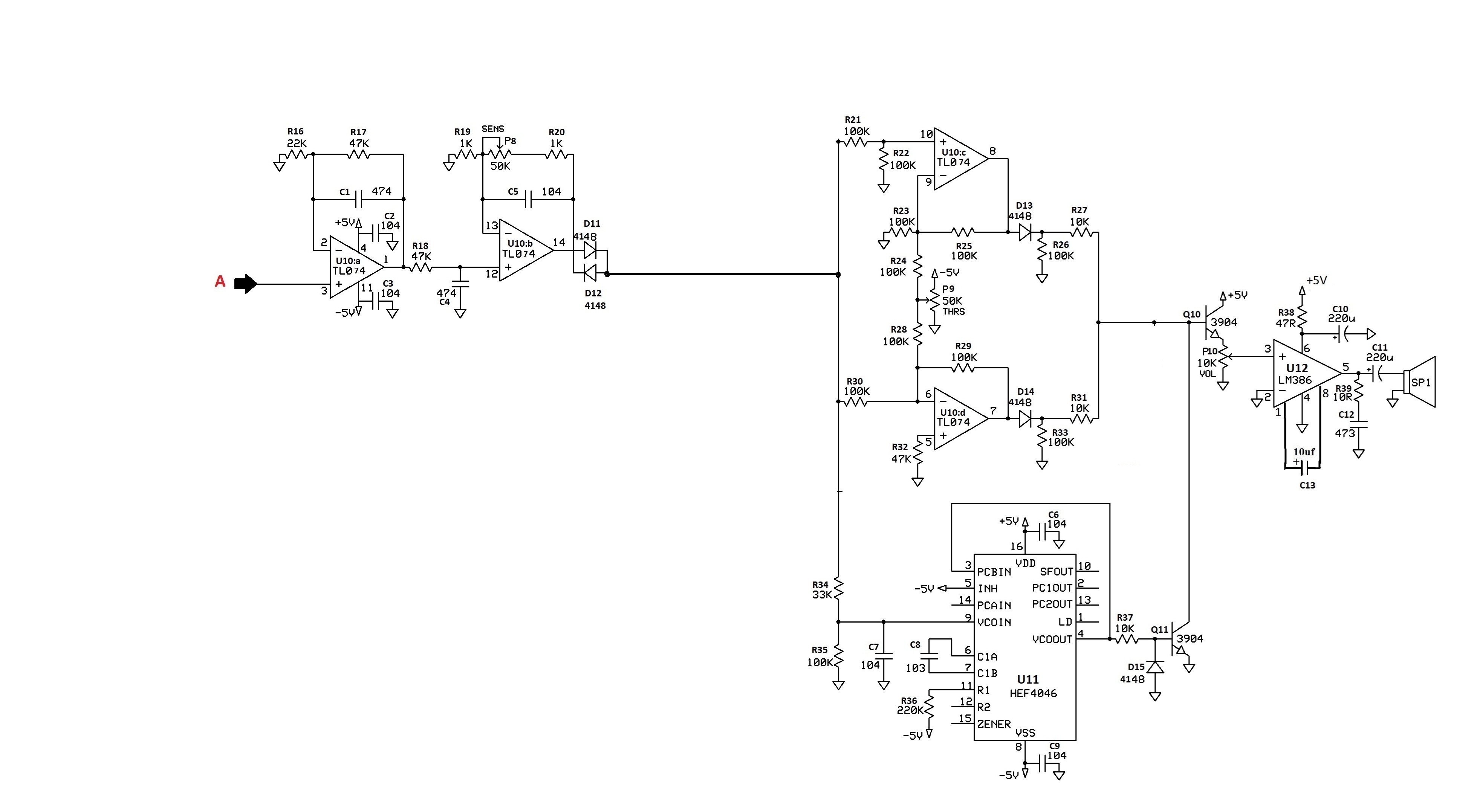

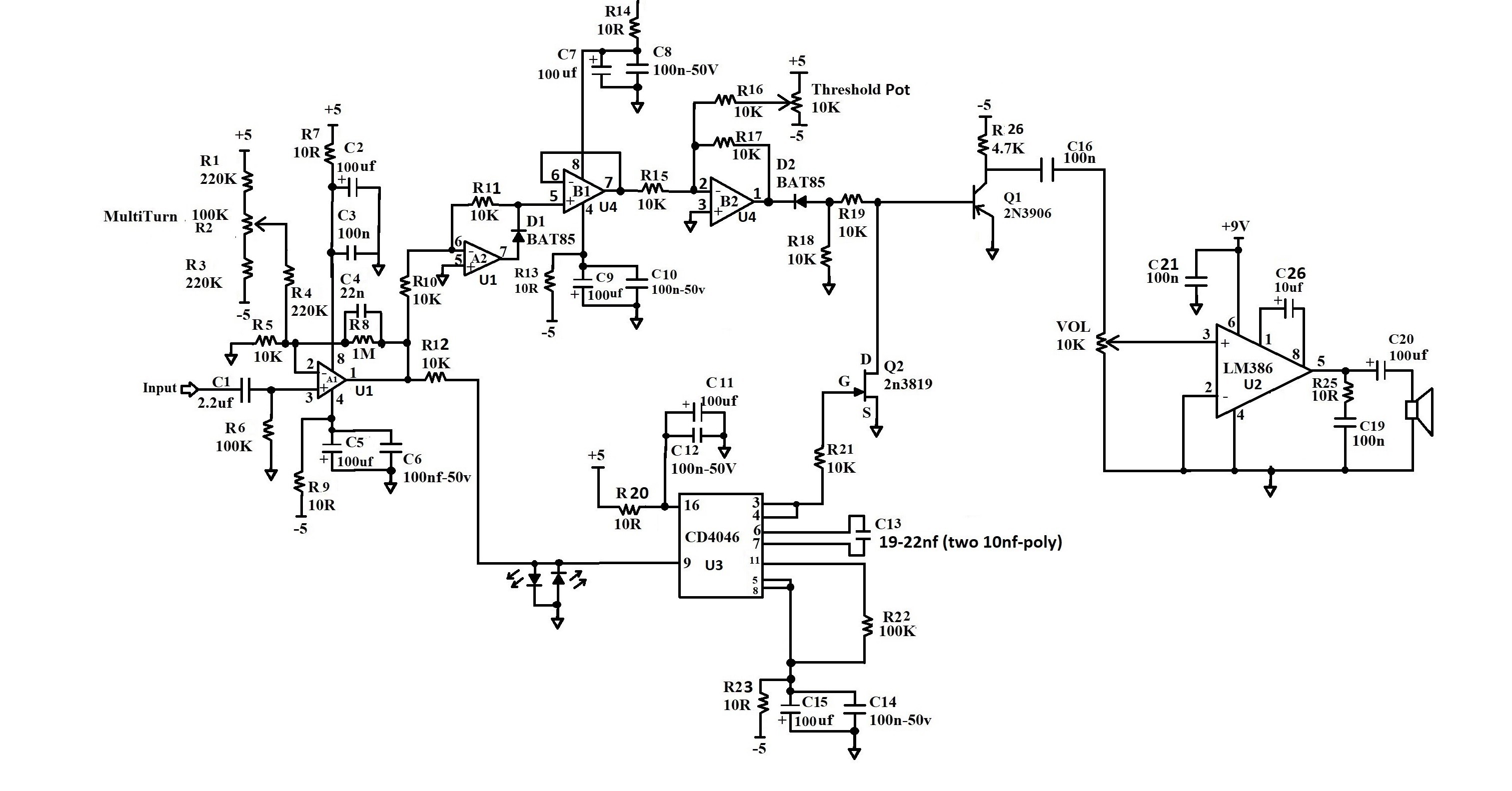

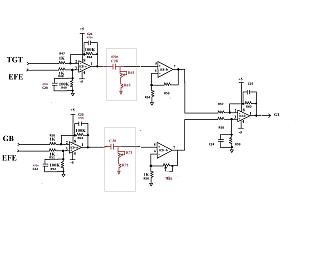

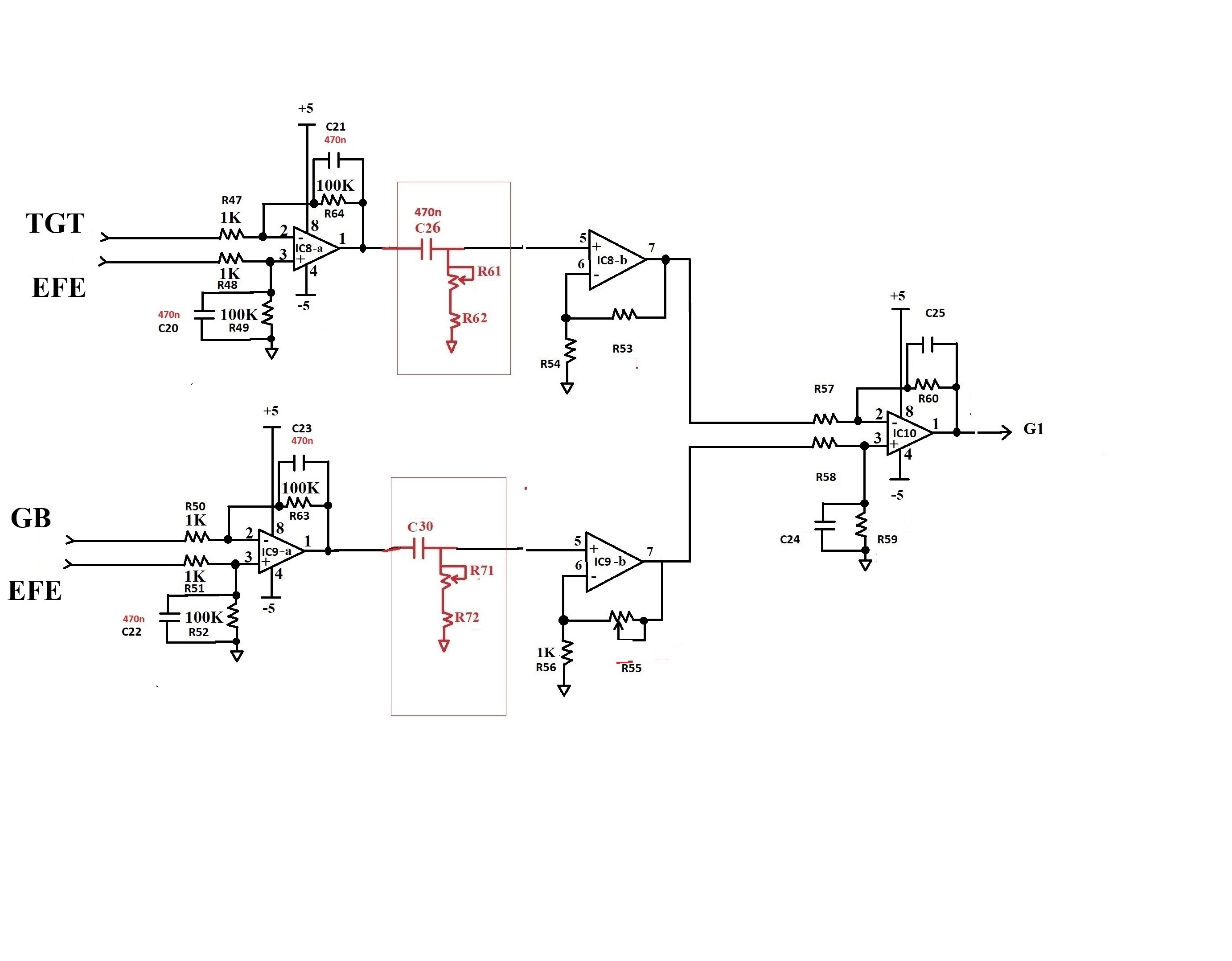

                            Hello Dear Carl
                            I hope you are OK.
                            As you know, I have already built HHD with GB. Please see following, it is my GB method (Subtracting GB).
                            Click image for larger version  Name:	oldgb.jpg Views:	0 Size:	279.2 KB ID:	453307
                            After that, i connected Mr. Mickstv's audio pcb ( following) to out of my GB (G1) . But before connecting the Mickstv's audio, we must adjust pin1 of U1 to 0V via R2 multi turn
                            Click image for larger version  Name:	MCK.jpg Views:	0 Size:	380.8 KB ID:	453308
                            After many tests, i adjusted my 4 delays at the best location.
                            As a result, My sensitivity is very very nice. I am using this PI for one year.
                            Now i decided to changed its structure, as two polarity for preamp like your bipolar-PI with the GB method (polarity GB, following):
                            Click image for larger version  Name:	newGB.jpg Views:	0 Size:	124.3 KB ID:	453309
                            Then, i connected the GB out to Mr.eduardo's Audio pcb. His pcb is like Mr. Mickstv but it has not any adjusting to 0V ( following):
                            Click image for larger version  Name:	newAudio.jpg Views:	0 Size:	429.8 KB ID:	453310
                            As a result, i have two schematics PI with the same sampling diagram,
                            1- HHD ( ( no polarity, with adjusting Offset for 5534) + subtraction GB + Mickstv's Audio
                            2- Like your Bipolar ( polarity preamp, without adjusting offset for 5532) + polarity GB + eduardo's Audio.
                            But i have very low sensitivity for Bipolar model ( number 2)!
                            I checked my damping resistor and preamp form, it is nice. I can not see any error because all of part is working but sensitivity is low.
                            I also changed preamp gain to 1000, no result. I also played gain of R65 and R66, increased it, no result.
                            Do you have any suggestion?
                              I suspected the audio circuit, so disconnected R18 (one pin) and connected it to my Subtracting GB output.
                              What is interesting is that my sensitivity is lower than its original!
                              My conclusion is that Mr. eduardo's Audio part has a problem and my low sensitivity is because of it.
                              Do you have any suggestion for testing or changing?
                              eduardo's audio part is following
                              • I designed this audio circuit for the Bipolar PI, which uses the battery's negative terminal as ground. Your current detector, which you're building, uses the battery's positive terminal as ground, so this circuit won't work for you without some modifications. First, D15 needs to be reversed for it to work with your current detector. You could also remove this diode. In any case, several modifications are necessary, including the supply for the LM386, etc. It's better to use the audio section of the GS5 Lite, since it uses the battery's positive terminal as ground, just like the detector you're building. That solution will solve your problem.
