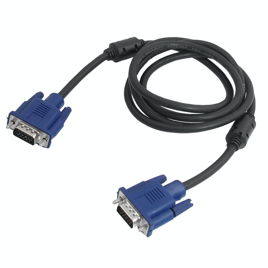

  • Originally posted by pito View Post
    SVGA Monitor Cable
    Thank you dear Pito
    • Does your RG59 have a solid center conductor or stranded?
        It is solid center.

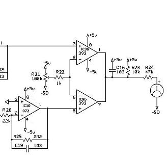

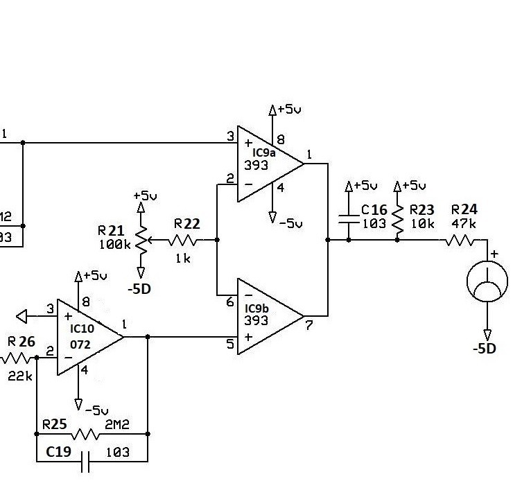

                            Hello
                            Dear Carl
                            I hope you are passing good days.
                            As you know, i am using the audio schematic (#339 post in this thread) for my HHD.
                            In addition, i added a DISC schematic for Fe detection (you can see its end part, output) and it works but its output is uV.
                            Now, i want to connect my DISC output to the audio schematic so that my audio generates a silent or cut off sound if the DISC pcb have an output.
                            Is is possible to guide me which points are better to be connected together?
                            ​Thank you.​

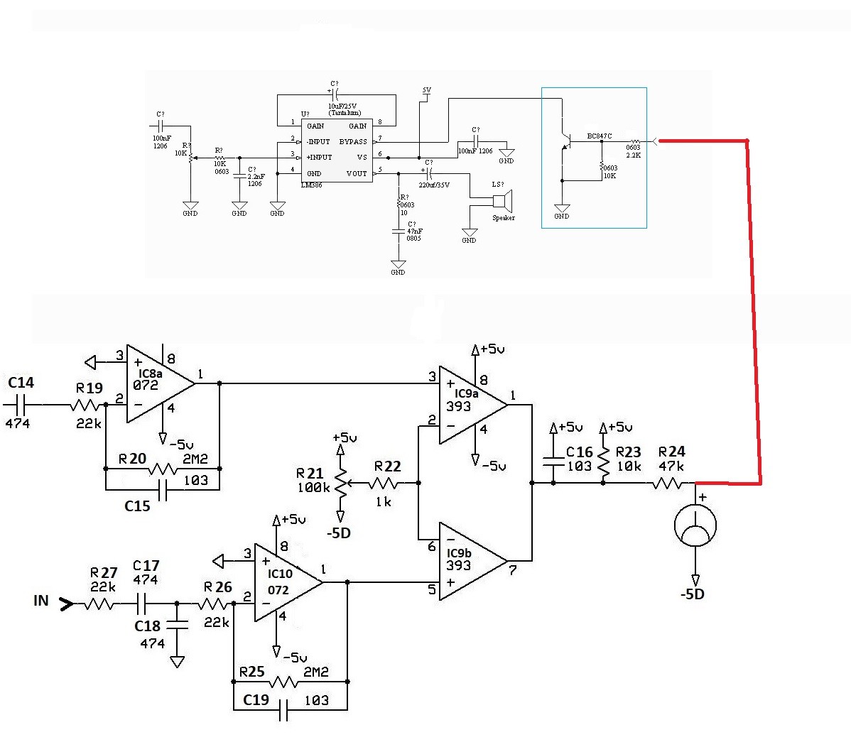

                              Hello
                              Dear Carl
                              Please forgive me for my question.
                              Is it possible to help me about the following problem (attached pic)?
                              I want to connect pin7 to ground if its below schematic has output (uV output).
                              The blue box is a simple method but i don't know its resistor values and connection point of the below schematic (red line) is true for active/deactive the bc847?!
                              I hope you accept to guide me, thank you.
