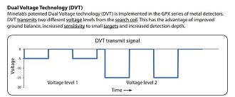

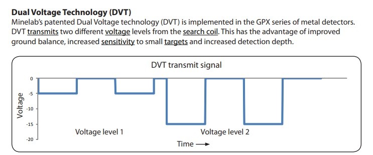

                              Dear Carl
                              Please read the attached picture, it belongs to Minelab method ( it used for increasing sensitivity to small targets).
                              Do you think i can increase sensitivity of my HHD to small object via increasing voltage supply to 15V ( off course, by changing 7660 to 7662 or LT1054) ?
                              • Minelab's DVT uses short high-voltage pulses combined with long low-voltage pulses to implement an improved ground balance. You can increase sensitivity by just increasing the TX voltage but power (heat) will also increase. You can also increase sensitivity by increasing either the TX pulse width or the TX pulse frequency, but again power (heat) will also increase. If you just want to find small targets (small gold nuggets) then you can decrease the pulse width and increase the frequency to improve sensitivity. I would try this before increasing the TX voltage. If you want excellent sensitivity to both small and large targets then you probably need a multi-pulse design.
