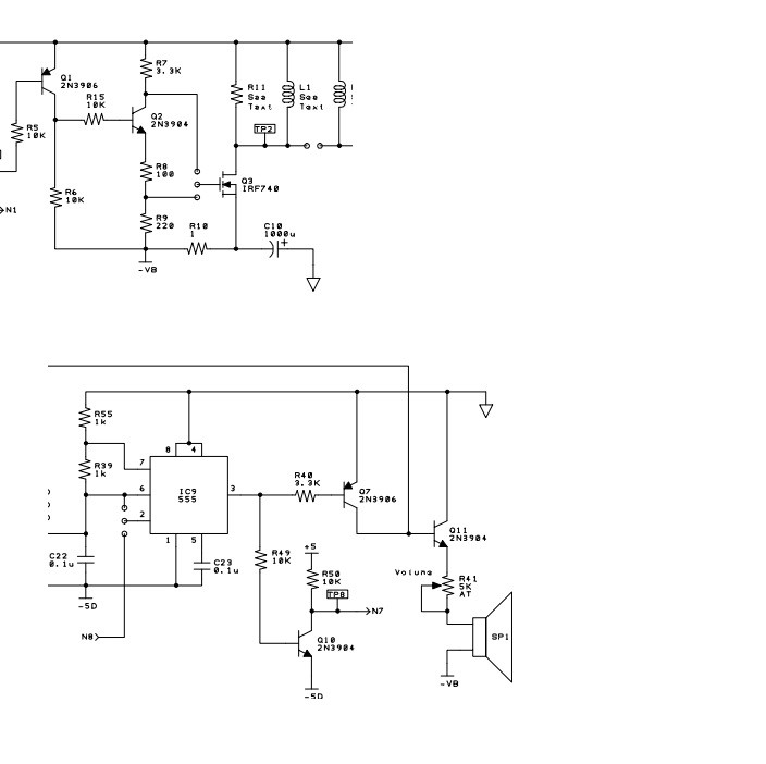

          So, do you think i only need to increase voltage my battery?
          I checked HHD (attached), only speaker and IRF740 parts are connected to -vb.
          I am going to use 15-16V for battery, have you any suggestion for change value of the part (connected to -vb) for this voltage?
          • Check the voltage ratings of C1, IC1, and C10.
