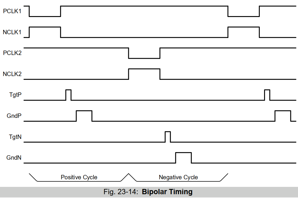

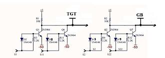

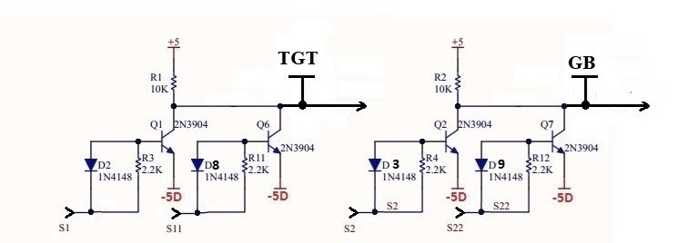

    However, according to post 688, your circuit does not have a bipolar TX so you cannot use this. You will need to use something like this:
      Click image for larger version Name:	image.png Views:	0 Size:	33.4 KB ID:	453535​
      Click image for larger version  Name:	image.png Views:	0 Size:	16.0 KB ID:	453536​

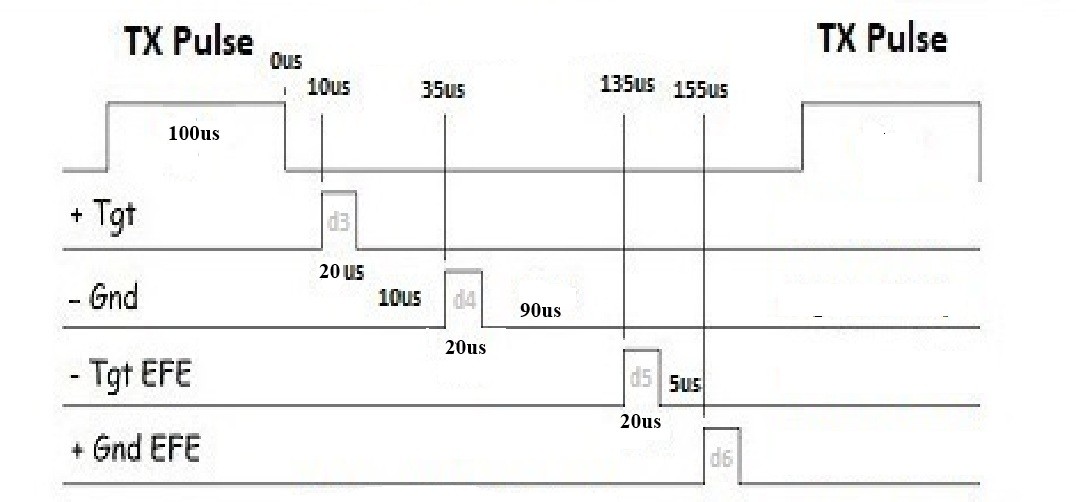

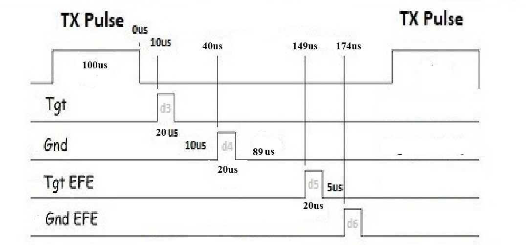

      I adjusted this timing, all sample width is 20us.
      Click image for larger version  Name:	diagram.jpg Views:	0 Size:	66.2 KB ID:	453538
      Ch1 = Tp5
      Ch2 = Tp6
      video1 : testing foil
      video 2 : testing Iron hammer
      I am using a small coil, a rectangle coil 10 * 5 cm.
      If i put hammer very closely to coil, i hear a two fast beep, this happen only for iron, not foil.

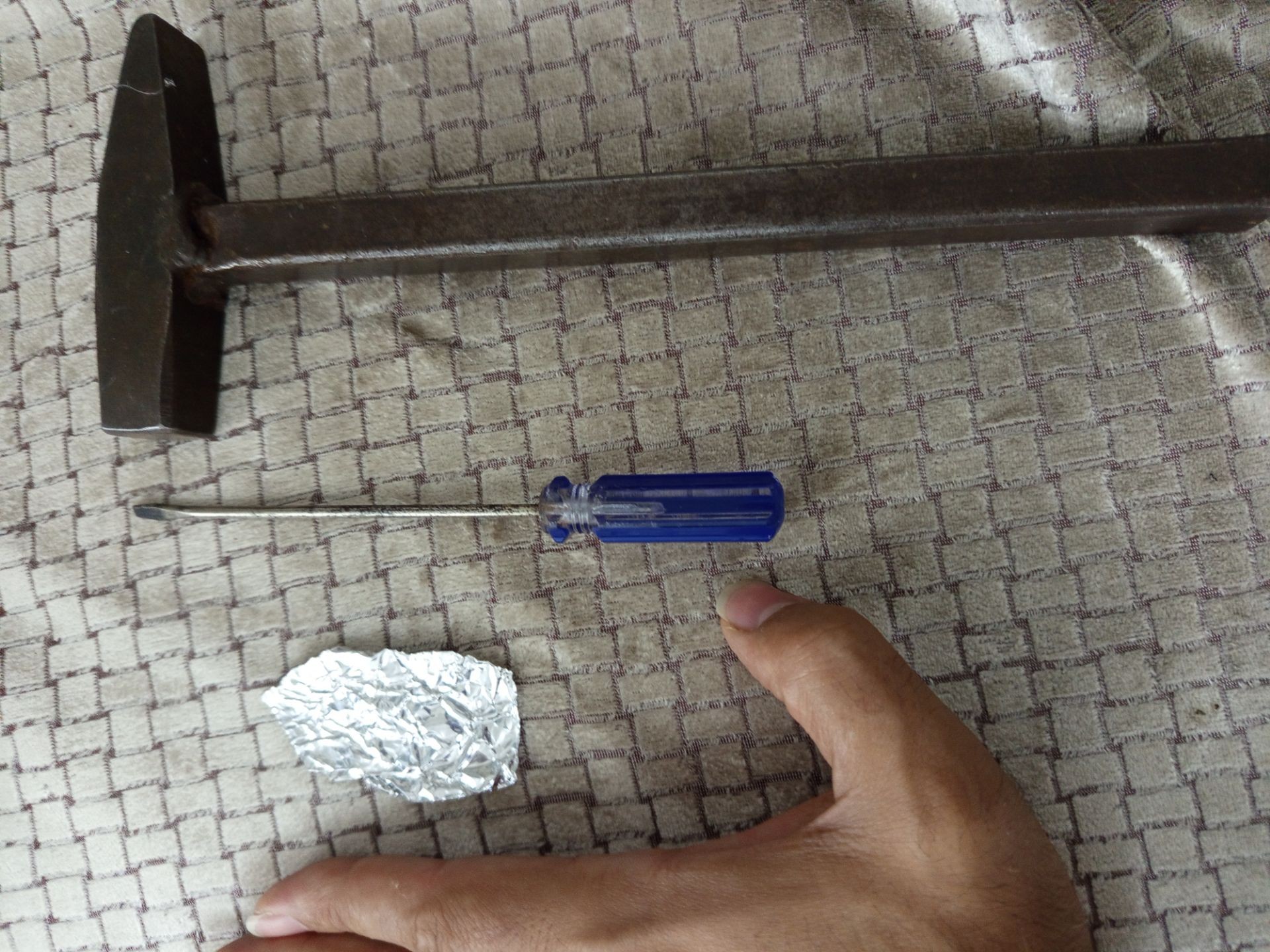

                • Show me what the foil looks like
                    I also tested with foil of smoke box.
                    • I still don't see the problem. The foil should have a very strong signal at TP5 and almost no signal at TP6. The hammer should be very strong on both TP5 and TP6. What I'm seeing looks like almost the same signal, always.

                        • No, it's not clear your demods are working correctly. Look more closely at your demod timing, I suspect there is something wrong.

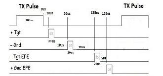

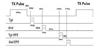

                            I again measured my timing on scope, this is my timing diagram.
                            Click image for larger version  Name:	timing.jpg Views:	0 Size:	65.4 KB ID:	453575
                            I am using micro and my level +5V is as follow:
                            Click image for larger version  Name:	level.jpg Views:	0 Size:	30.3 KB ID:	453576
                            As i told, my +5 is 4.1V. Can this lower voltage make this problem?
                            Can you tell me which of TGT,GB,TGT-EFE and GB-EFE play key role on correct timing for Demod?
                            I want to play with it.
