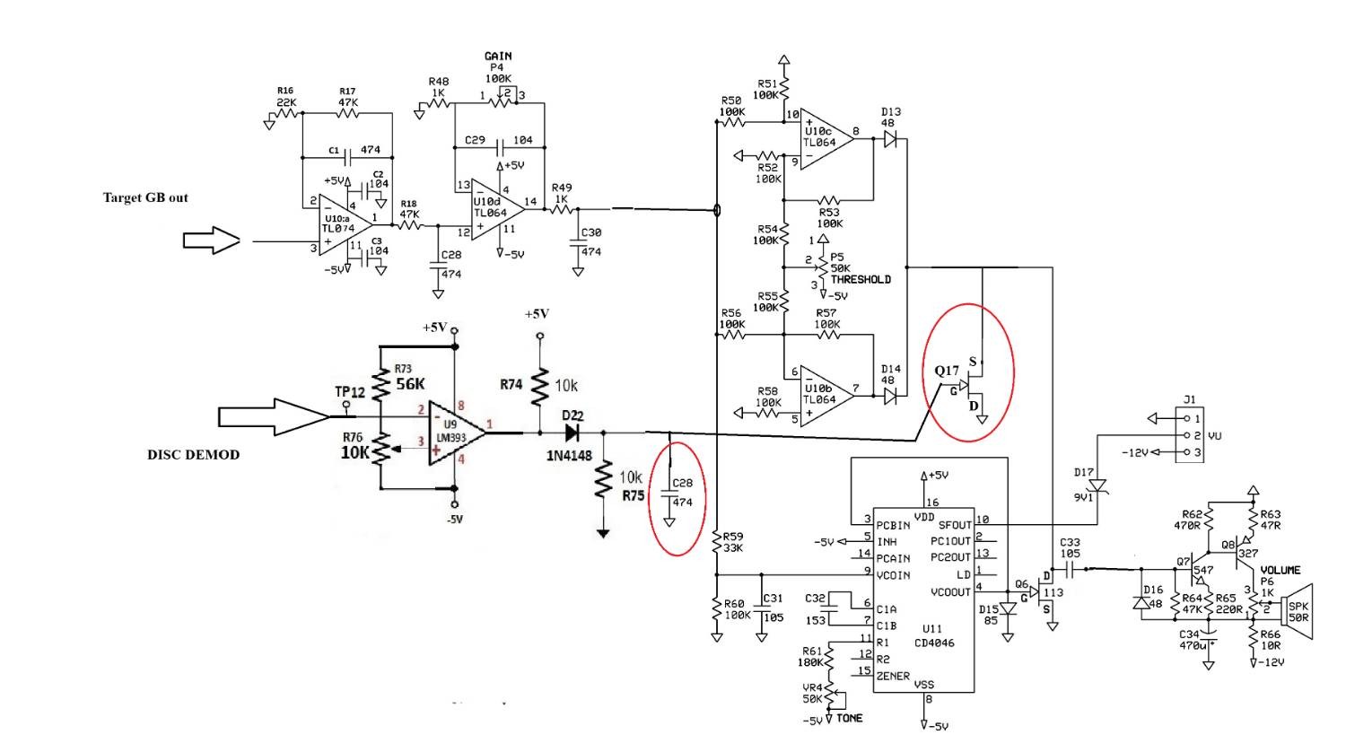

Threshold Pot doesn't work
I don't know exactly how the GPX sounds, but if you want to slow down Q17 try increasing R75 to maybe 100k. You can also add a parallel cap to ground, try different values. A big problem with this is that Q17 is NPN and will tend to turn off quickly due to the high gm-RL gain. An NMOS might behave better.
Also, you are missing the load resistors; R27 and R31 in post 585. Those are critical.
Thanks.Originally posted by Carl-NC View PostI don't know exactly how the GPX sounds, but if you want to slow down Q17 try increasing R75 to maybe 100k. You can also add a parallel cap to ground, try different values. A big problem with this is that Q17 is NPN and will tend to turn off quickly due to the high gm-RL gain. An NMOS might behave better.

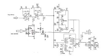

Please watch the gpx iron rejection,
I added the parallel capacitor and nmos. Please check nmos pins S and D is true?
Do you have any value suggestion for the parallel capacitor?
