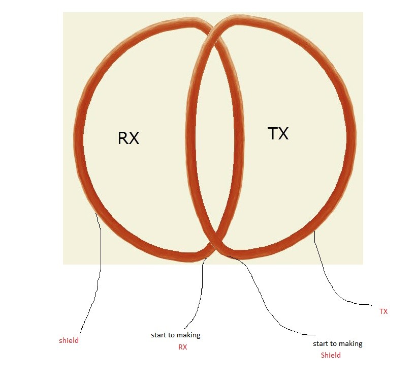

    I am using such wiring for making DD

    • Nulling a coil for PI and IB are done the same way: when you have proper IB ther should be NO SIGNAL on the RX coil, or at least a minimized signal. Your "No Target" signal in post 551 shows a huge signal, which means the coil is not nulled. It should be very small like the first signal in Fig. 26-15.
        Thank you.
        I can not understand fig. 26-15. Is that inside of your book?
        • Yes. You want to adjust the coil overlap until the RX signal is close to zero.
            Now, i tried, the best form is like follows

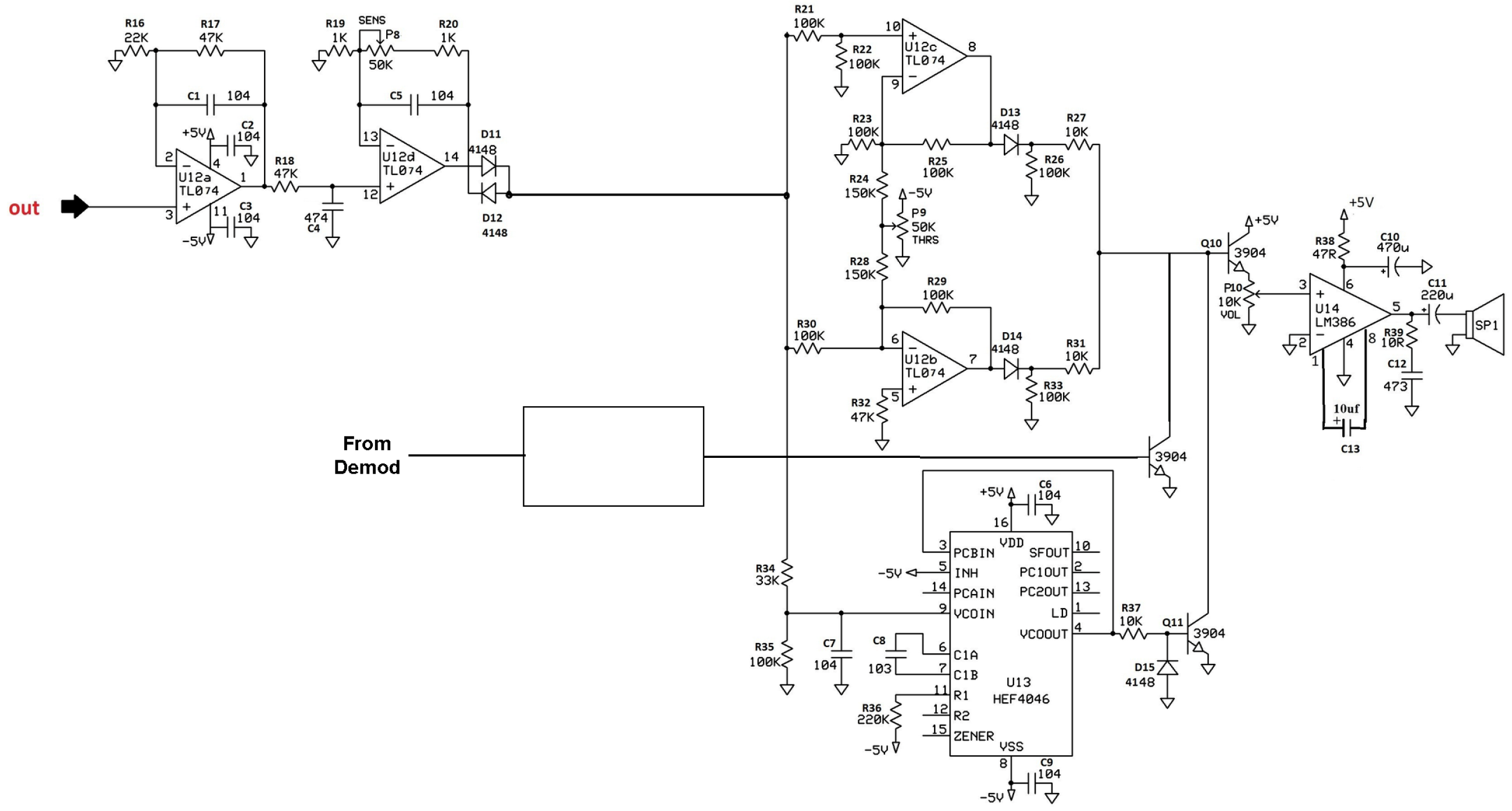

                Is it possible help me about adding your suggestion schematic for blanking audio?
                Thank you.

                  • It looks like you are getting decent results. Now you can add the demodulator and figure out what timing gives you a reasonable signal. After that, figure out what you need to do with it to blank the audio or use a low tone. I can't tell you how to do this because I have not done it myself.

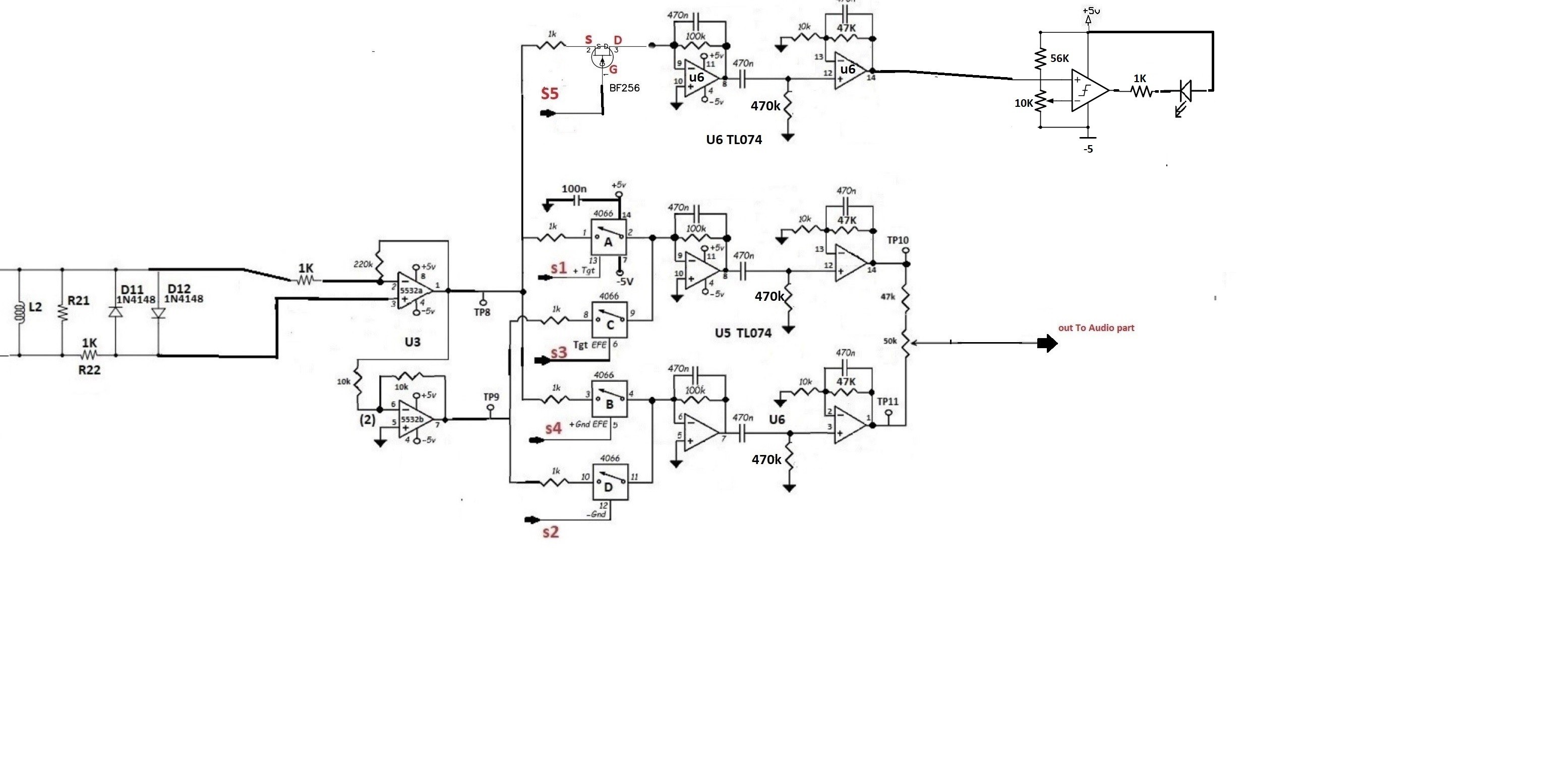

                      But for starting to real test, can you give me a primary schematic in order to adding inside the box (attached)?
                      In fact, i have manually built TX+preamp+DiscDemod on a small board.
                      Now, i want to play next part schematic (blanking, inside of box).
                      I have a proposal, i hope you accept it. Please suggest me your initial or proposed schematic for the box but its output is a simple led for only Iron detection.
                      Then, I will play it and will find the best result (best sample).
                      After finding the best result , finally we (with your supporting) change its led output to 2n3904 for blanking.
                      I hope you accept it, i am ready to test or to play all of your suggestion.
                      Thank you.
                      Click image for larger version  Name:	demod.png Views:	0 Size:	651.6 KB ID:	443891
                      • The simplest solution is to place a comparator after the demod stage and have the open-collector output drive a series resistor and LED (connected to +5V).

                          Is that correct?
                          In my schematic, ground is +VB.
                          Do you think i should connect pin4 of lm393 to gnd (+VB)?

                          • Yes. You may need to reverse the inputs depending on whether iron gives a high signal or low signal. I would use -5V for pin 4.

                              Today, i tested the LED shower (my DISC schematic is based on #567 post), but i have not any reaction for ferrous or non-ferrous on led. I think the changing is very very very low and lm393 can not show.

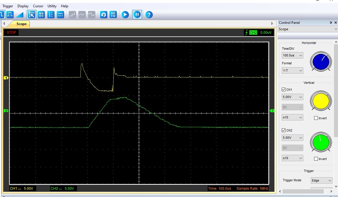

                              First i adjusted my sampling as follow:
                              Click image for larger version  Name:	1.jpg Views:	0 Size:	132.0 KB ID:	443977
                              And i checked my Demod output as follow:
                              Click image for larger version  Name:	2.jpg Views:	0 Size:	133.6 KB ID:	443978
                              No reaction with LED.

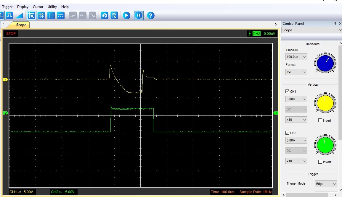

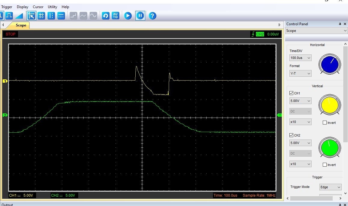

                              Again, i changed my sampling so that my demod output is a tringle:
                              Click image for larger version  Name:	3.jpg Views:	0 Size:	131.1 KB ID:	443979
                              Click image for larger version  Name:	4.jpg Views:	0 Size:	133.9 KB ID:	443980
                              But no result with LED.
                              No matter how hard I try, my output shape doesn't get any better than this triangle.
                              I am sure that my LM393 is true. My LED will turn on if i change pot (lm393).
                              • Show me the waveforms for TP8, U6-pin8, and U6-pin14 with no target.
