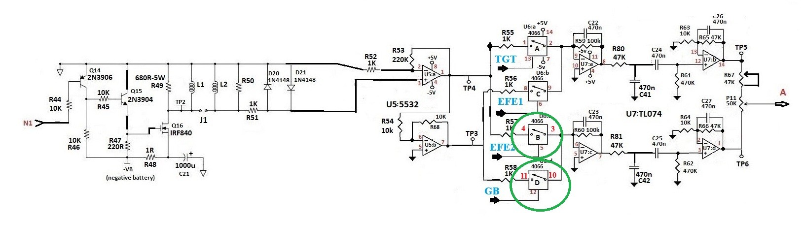

          • Your timing settings might be incorrect, or the connections to the CD4066 synchronous demodulator are likely wrong. At point A—with the GEB potentiometer set to a mid-range position—high-conductivity metals should produce a response opposite to that of low-conductivity metals. In my opinion, you should check point A first, just as Carl suggests, before looking for the problem in the audio circuit.

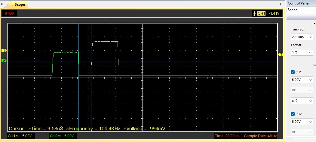

              TGT = 10us
              GB=10us
              EFE1=320
              EFE2=340
              All sample width is 20uS
              I attached scope for GBdelay (9.5)
              My testing targets are a foil and Iron hammer.
              My coil size is 10cm, it is small for testing.

                          Please see my 5532 inputs,
                          my input signal is connected to pin3 (+), whereas Mr. eduardo1979​ advice me to change it. It should be connected to (-).
                          Do you think this problem is because of it?
                          I read Ivconic's posts, he had my problem too (his post).

                            I checked my PCB more and more, the only difference was 4066 pins (3,4,10,11).
                            I attached final schematic.
                            Click image for larger version  Name:	newGB.jpg Views:	0 Size:	129.2 KB ID:	453523

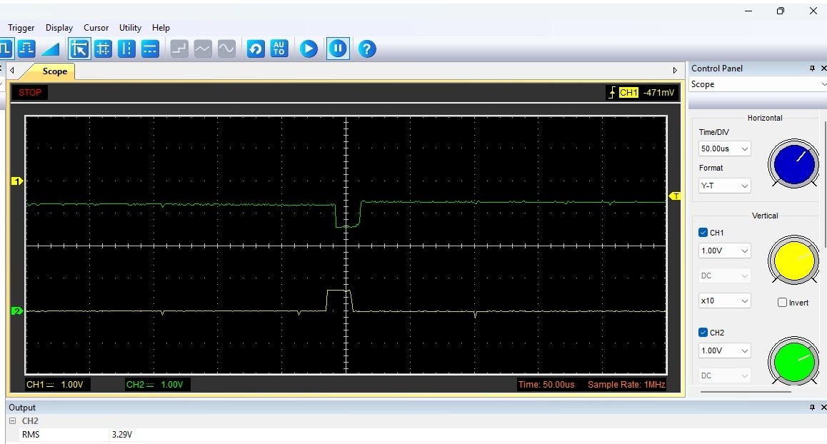

                            See following, it is U7: pin8 and pin7 output when Iron and foil are in front coil. Both target form is the same.
                            Ch1 : U7: pin 8
                            Ch2 : U7: pin 7
                            Click image for larger version  Name:	iron1.jpg Views:	0 Size:	130.0 KB ID:	453525

                            • Your videos show that both sides are doing the exact same thing. One side should do this:

                              My guess is that your demod timing isn't right. What are you using to test GB? Because those videos tell me that GB can't possibly be working.
                              And, no, whether the preamp is inverting or non-inverting won't make much difference.
