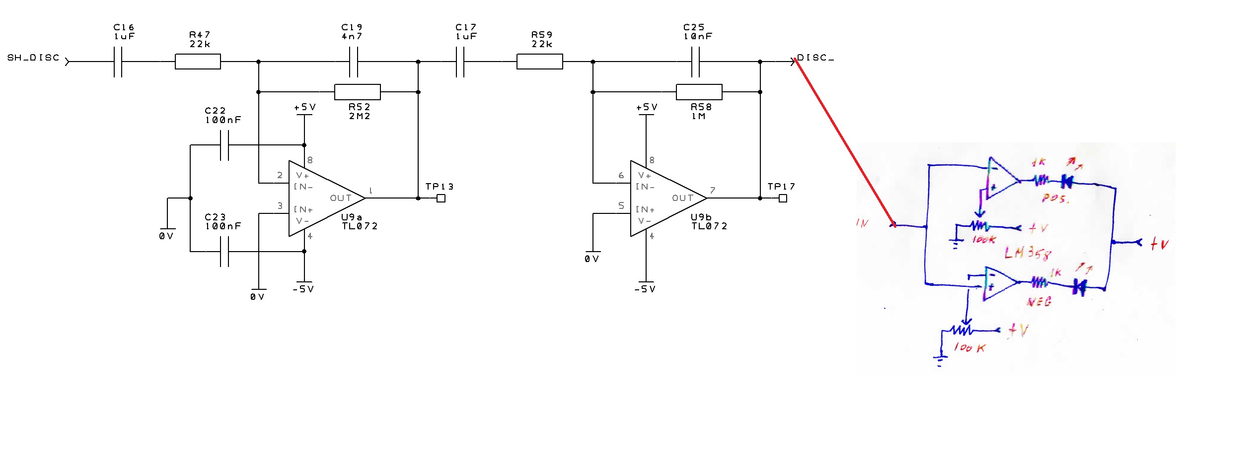

      I want to add only its DISC part. I don't want to reject Iron, just want to show it via a simple LED.
      Do you think it works?

        Is it possible to share me wave form at TP17 (DISC_OUT)?
          [ATTACH]57569[/ATTACH]
          The blunt answer to your question is "no".
          May I make a suggestion? ... Instead of phishing for information, why not buy the book and read it, and preferably build the Voodoo circuit.
          You will then understand why adding true ferrous/non-ferrous discrimination to a PI is not as simple as you think.
          As Carl has already said:
          If you have not successfully built the Voodoo circuit as it is designed then trying to convert HH+GB into a Voodoo-like hybrid will be exceptionally difficult. Build Voodoo first, get it working, and learn how it works.

            • An image of the waveform will not help you. Your approach of attempting to add ferrous/non-ferrous discrimination to and HH+GB combination is basically flawed.

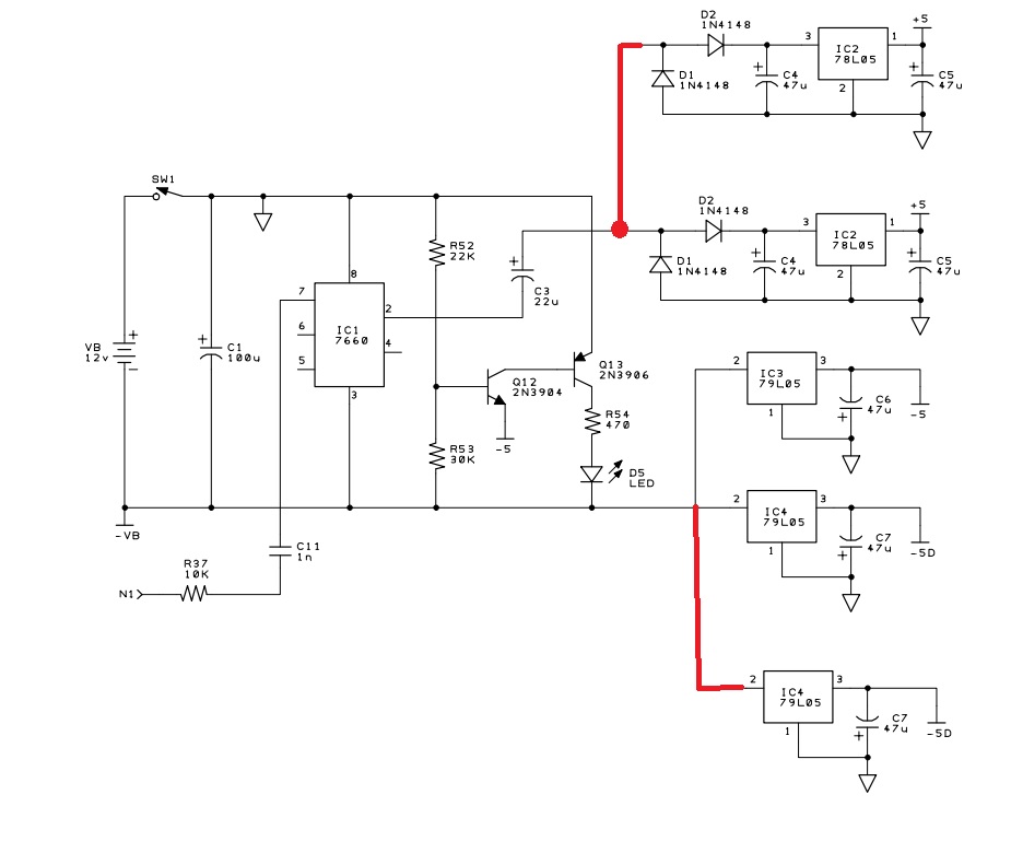

                  • Hello
                    Dear Carl
                    I'm going to develop HHD by adding some ICs.
                    I think power of HHD may can not generate adequate current.
                    So, i want to generate a separate +-/5V for the ICs.
                    Please see attached, do you think it's correct?
                    • The top 7805 should connect directly to the other 7805 (no diodes). You should also check your power budget to make sure the 7660 can supply the additional current.

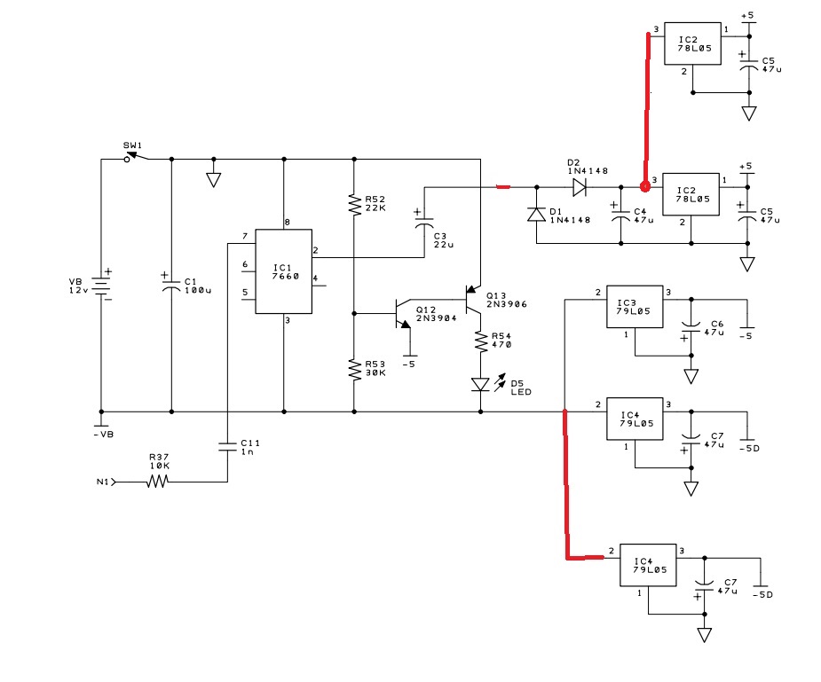

                        Thanks.
                        Is that correct?
                        • Yes
                          • Thank you.
