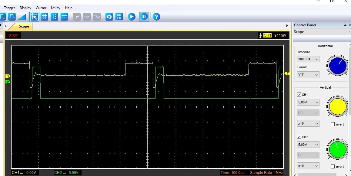

    I checked all voltage +5/-5 on scope, it is clear without any noise.

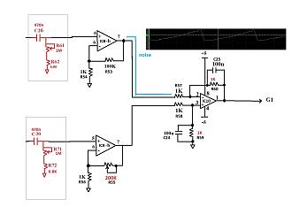

    After a lot of trying, i could find my noise path.

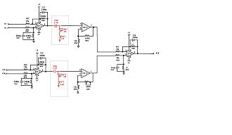

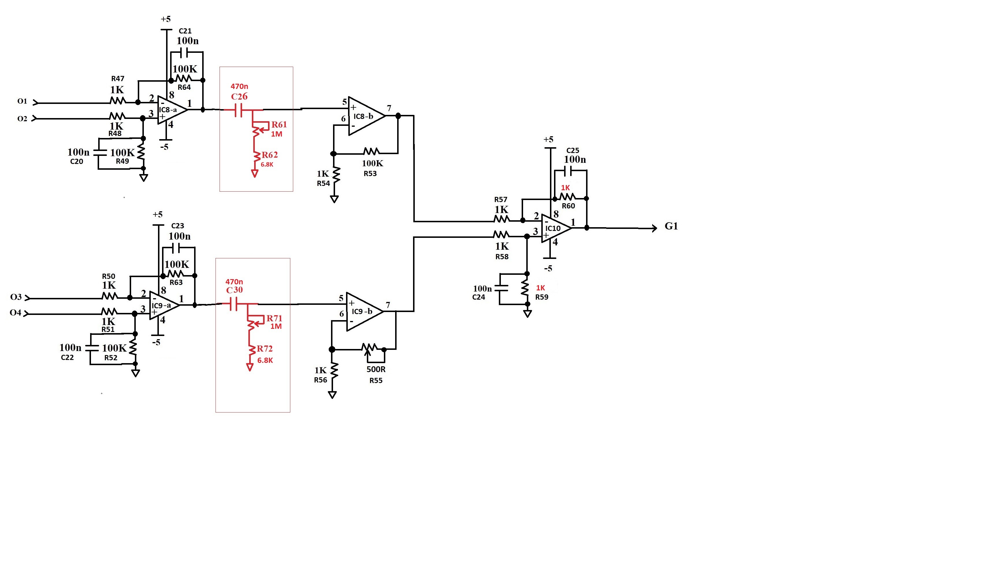

    First, please see my schematic (attached).

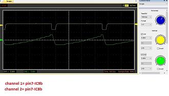

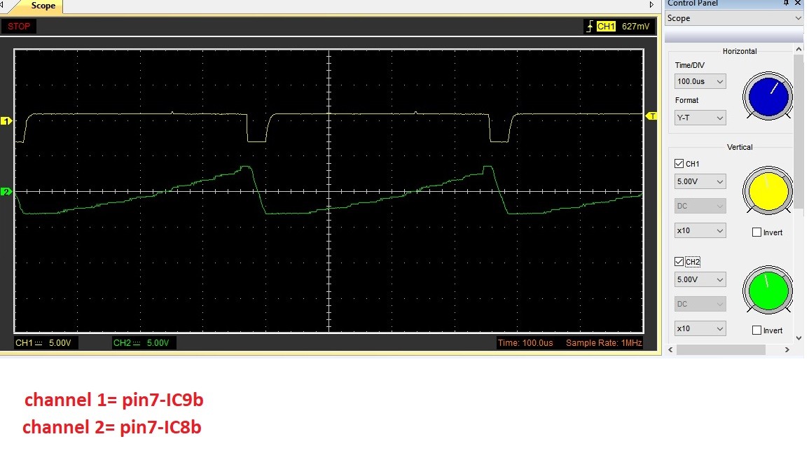

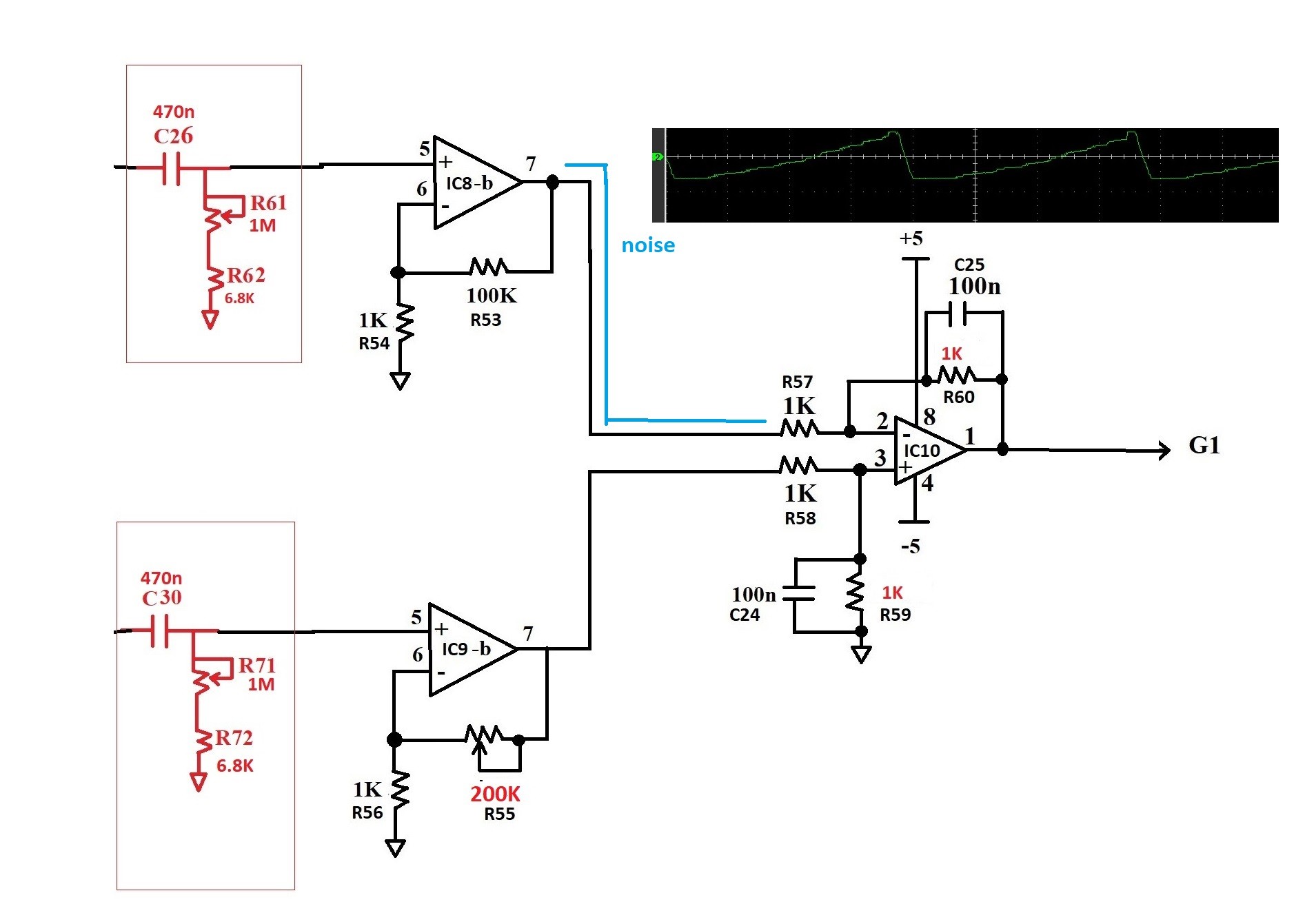

    I have a noise (incorrect signal form) only in IC8b-pin7 (my main channel).
    I checked its last path (IC8b-pin5), no noise and it is clear.
    I also checked IC9b-pin7, no noise. If you see in scope, it is pulse form, it is because of my gain pot.I increased it in last position, maximum gain. If i decrease the gain, it will be a clear line, no pulse. In my scope, channel 1 is IC9-pin7, channel 2 is IC8b-pin7.
    I think gain of IC8b is high, do you think i should decrease R53 value?
    (for better understanding, i show my noise path with blue line)
    I measured all result without connecting coil.
    Thank you
      IC8 has a gain of 100 so you will need to increase the oscope sensitivity to 50mV/div to get an equivalent measurement. Did you do that? I suspect you will see the same problem and that it is just a normal integrator waveform. This means you either have too much gain in IC8 or not a high enough integration tau.

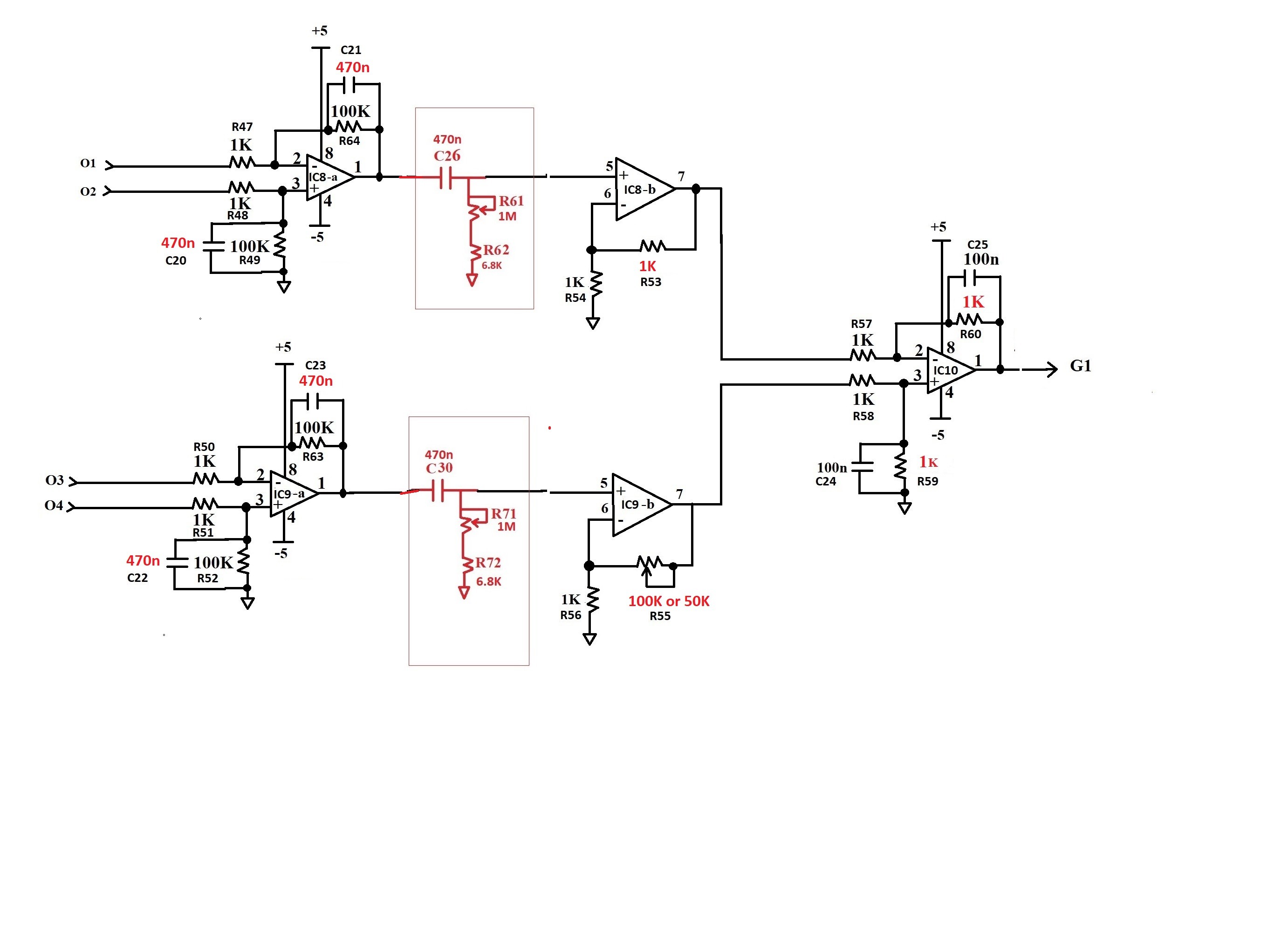

        About tau, is your mean that i should play (increase gain) with R64-R47/R49-48 (attached)?
        I forgot to tell you, my frequency is 2.6KHz.
        Click image for larger version  Name:	GBmain2.jpg Views:	0 Size:	304.1 KB ID:	414484
        • R64-C21 and R49-C20 set the tau of the integrator. Try increasing C20 and C21 to 470nF (also C22,C23), your ripple should decrease but your target response speed will be slower.

            Do you think i should also increase or decrease C22 and C23 (GB channel)?
            • Yes, the ground channel needs to match the target channel.

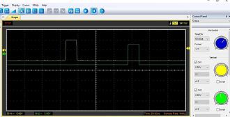

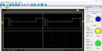

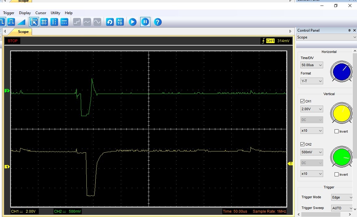

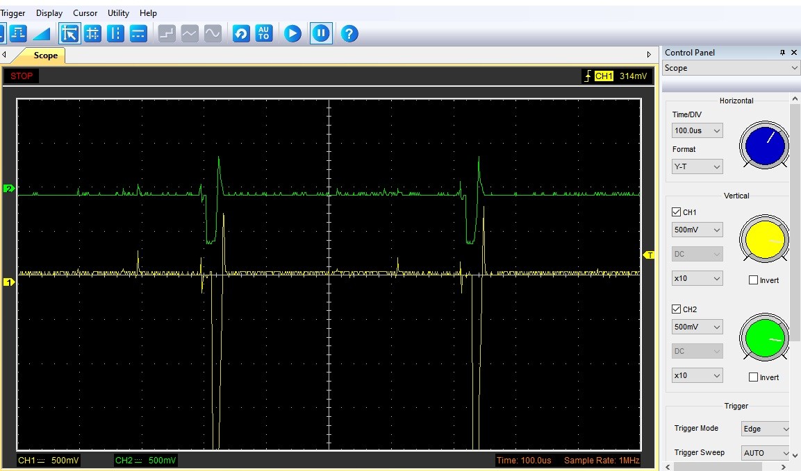

                After changing TAU capacitors, my main channel output (IC8-pin7) is good form.
                In addition, gain of my main channel also was high and i changed to 1.
                But see my ground channel form, do you think it is normal?
                I measured results with a connected coil over ground (free metal)
                Click image for larger version  Name:	scop.jpg Views:	0 Size:	134.0 KB ID:	414511
                I change my ground channel gain (GB pot), you can see its form in follow

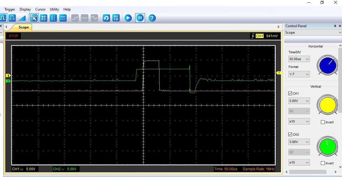

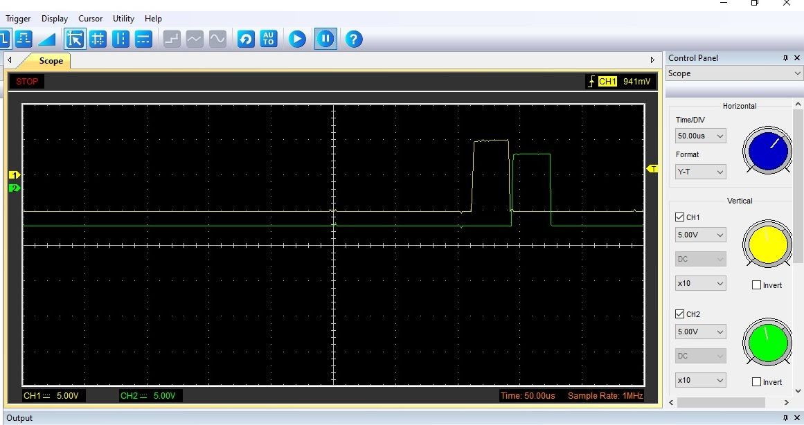

                  Now, see my Delay chart as follows,
                  TP4 and Del1 (main delay)= 8uS

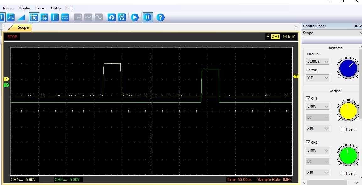

                  Del1 and Del2 (GB delay)=4-5 uS
                  Del2 and Del3 (first EE)= 150uS

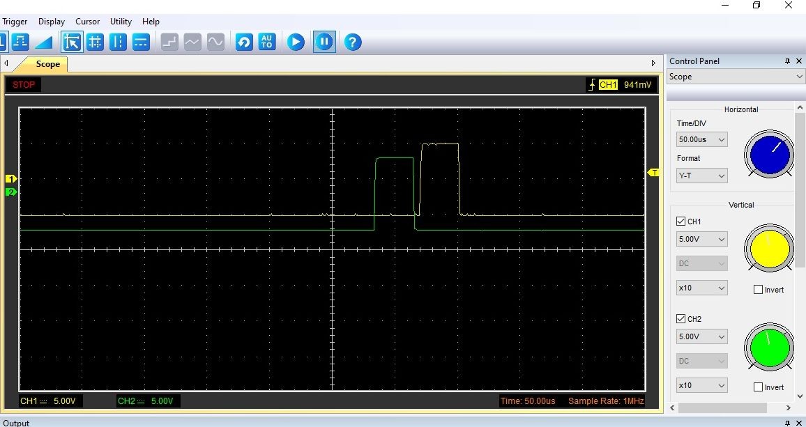

                  Del3 and Del4 (second EE)=10uS

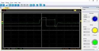

                  But my GB pot is not working. The only model that it works, i increased Del3 and Del4 (both EE delay) so that Del4 went out of my time period (over next TP4 pulse).
                  See it, it is my Del4 (second EE) and next TP4 pulse.
                  All of my measurement was based on a 45cm coil (litz, i tested the coil over GPX5000 and works very nice). But my HHD-GB work very nice if i change my coil to 8cm with inductance 500uH.
                  Do you have any suggestion for testing and solving my GB problem?
