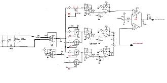

    That circuit is used in VLF detectors, the signals are different in a PI detector. You will need to add the demodulator and then find out how that signal behaves with ferrous targets, non-ferrous targets, and ground. This includes changing the demod timing to see how that changes the signals. You should be able to find something that works well enough on at least some targets. Then compare the iron signal to the GB signal and figure out how to combine them to blank the audio. They are both motion-mode signals so you may not even need to combine them, I don't know.
    Thank you.
    But the new demod is connected to pi preamp. I think we can not see tx-on ( pulse) because Iron increases tx-on pulse. Do you think it is better to use an independent preamp?
    Since both are motion, do you think i only need to add opamp after the demod for iron reject pot?

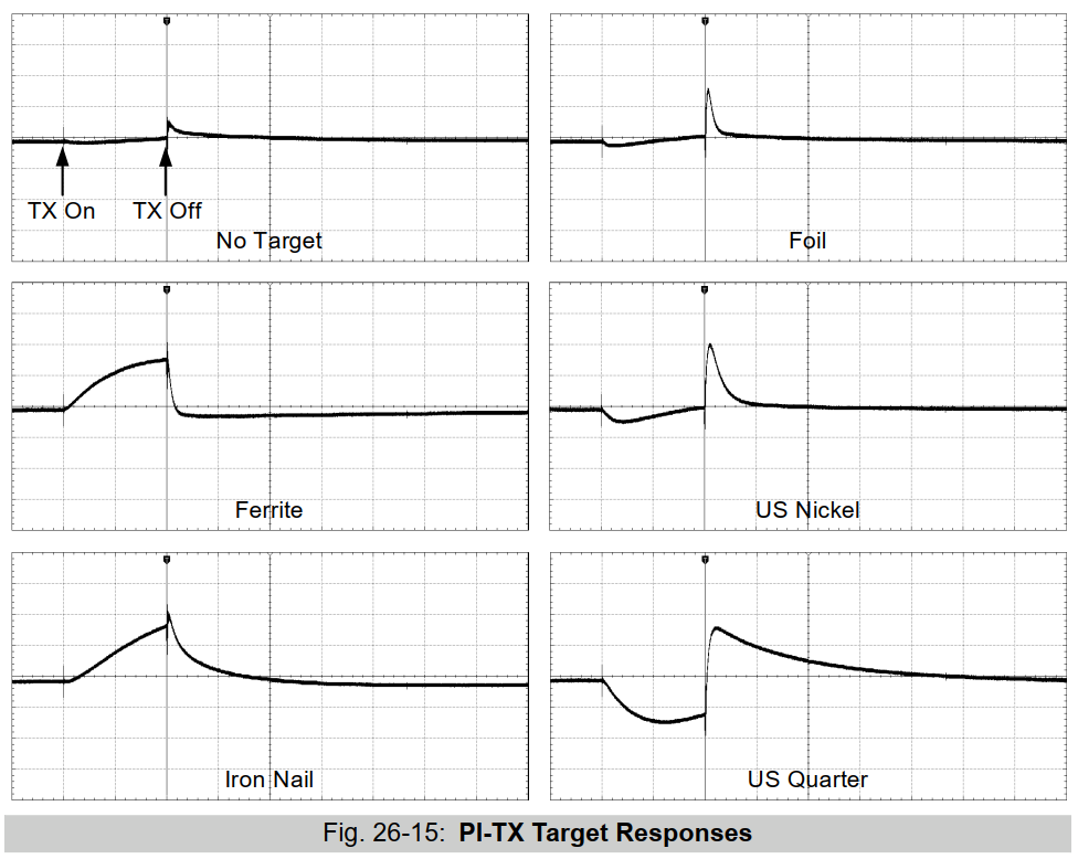

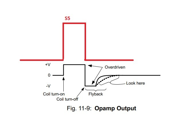

        Please consider tp4 form scope in HHD, can you show me which point is TX on? Is the DISC sample (S5) true from preamp output ?

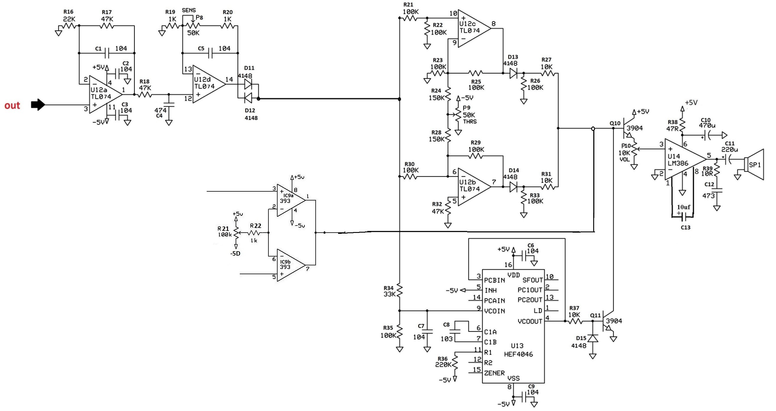

        I want to build the above schematic with lm393 comparing but do you think i can connect its out to the 2n3904 that you added for blank audio?
        I think out of the lm393 is -5V.

          • If you use a DD coil then the waveform at TP4 will look like those in post 512. The TX-on and TX-off are clearly labeled. You will need to determine where to sample with S5. Inverting or non-inverting preamp does not matter, you can design the other circuitry for either polarity. The LM393 has an open-collector output (see the data sheet) so it can directly clamp the audio without using an extra NPN.

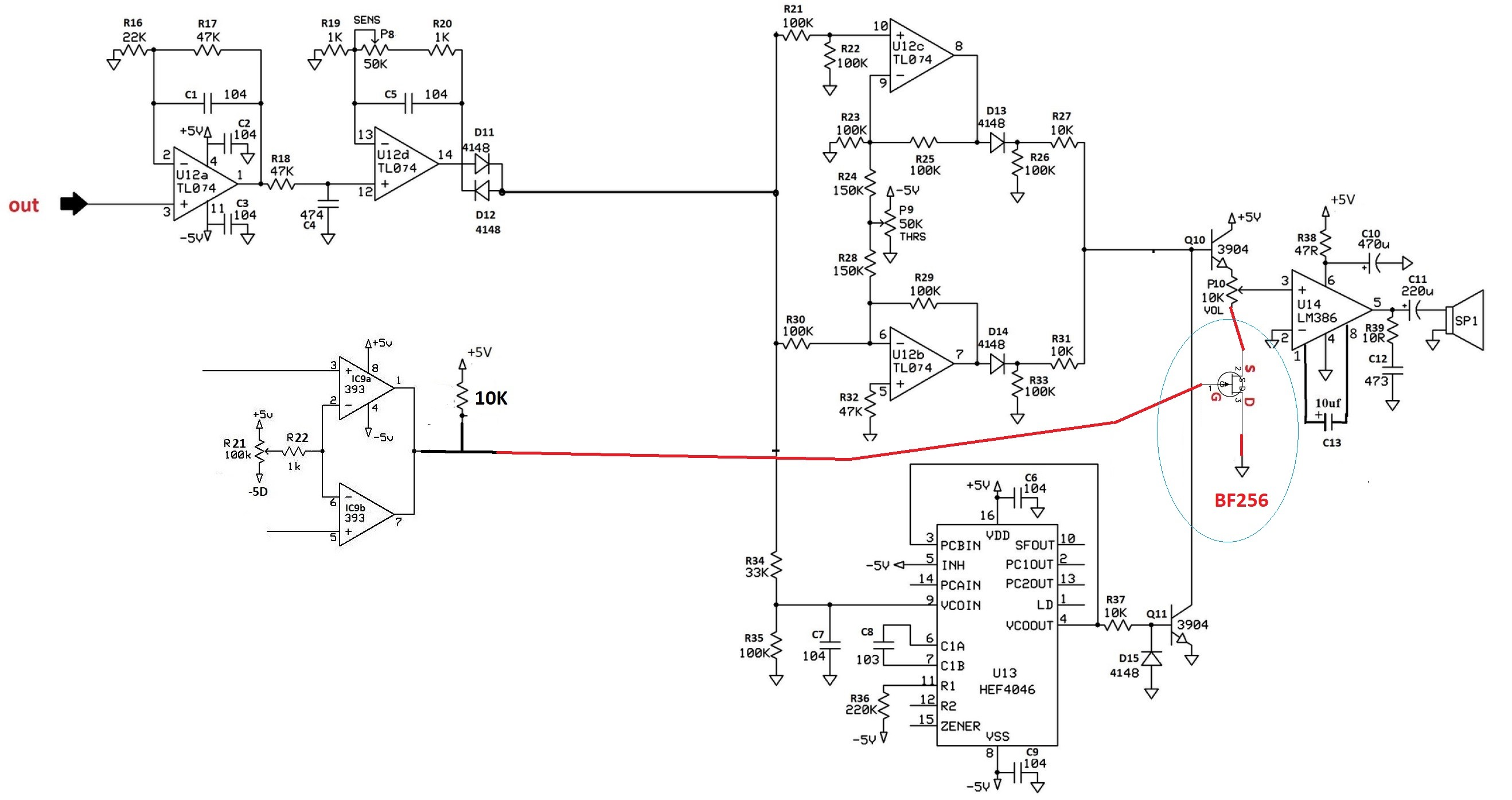

              Please see attached, the LM393 connection to my Audio for blank, is it true?

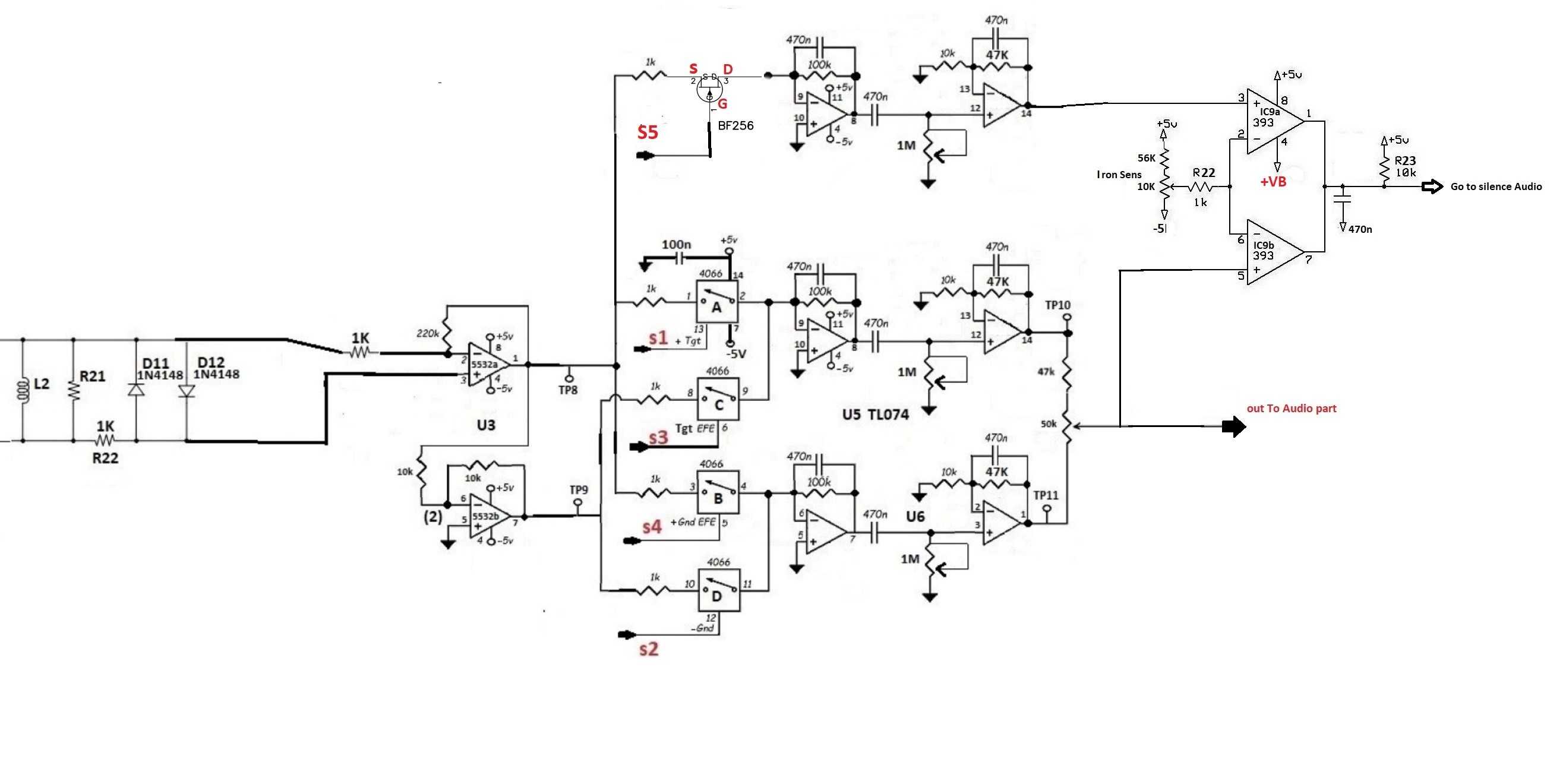

              About the added demod, do you think i can use BF256A or BF255A or BF245A instead of 4066 ( shown in following picture)?
              If yes, Do you think the pins are true?

              • Yes, you can directly clamp with the LM393 but it needs to be powered from +5V/0V instead of +5V/-5V.
                Yes, a JFET switch can be used. I prefer to place the S on the ground node but in reality most JFETs have interchangeable D and S.

                  I set power of LM393 to +5 and 0 ( in my schematic, ground is +VB like HHD).
                  Since all channels are set by +5 and -5, do you think the ground (+VB) is OK for my schematic?

                  • I don't know, you may need to add resistors and clamp diodes. This is a very experimental circuit, you will need to build it and see what it needs.

                          I added a pull-up resistor on the open-collector comparator outputs to +5 so the comparator output will be -5V or +5V.
                          Please see schematic #518 post. As you see, the LM393 has two inputs (DISC and GB channel demod).
                          Can you tell me LM393 output voltage if the two inputs are high? +5 or -5?!
                          In fact, the 2n3904 must act only both input of LM393 are high. So, i do know which of +5 or -5 is considered as high for its final out.
                          Do you think it is need to add the diode before 2n3904 (follows)?

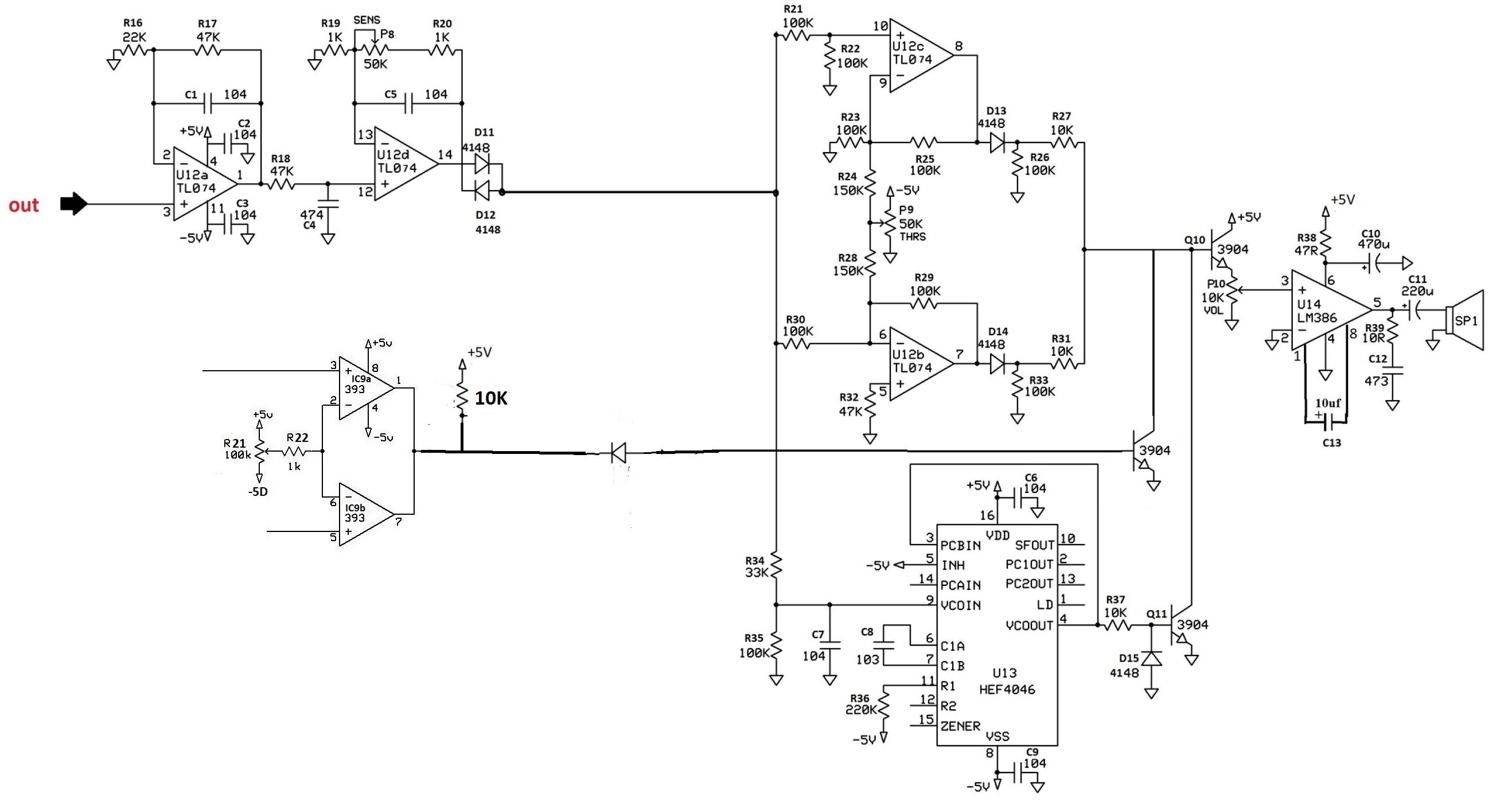

                          Click image for larger version  Name:	a1.jpg Views:	0 Size:	293.3 KB ID:	443055
                          • The data sheet tells you how the comparator works:
                            "The output consists of an open drain NPN (pull-down or low side) transistor. The output NPN sinks current when the negative input voltage is higher than the positive input voltage and the offset voltage."
                            Probably you will need a series diode on the base of the 3904.

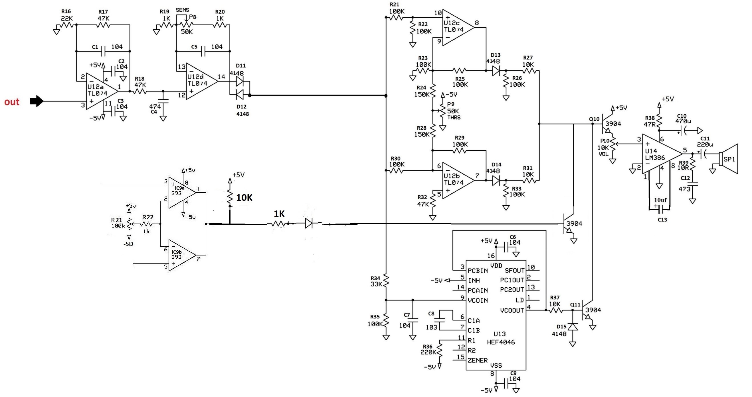

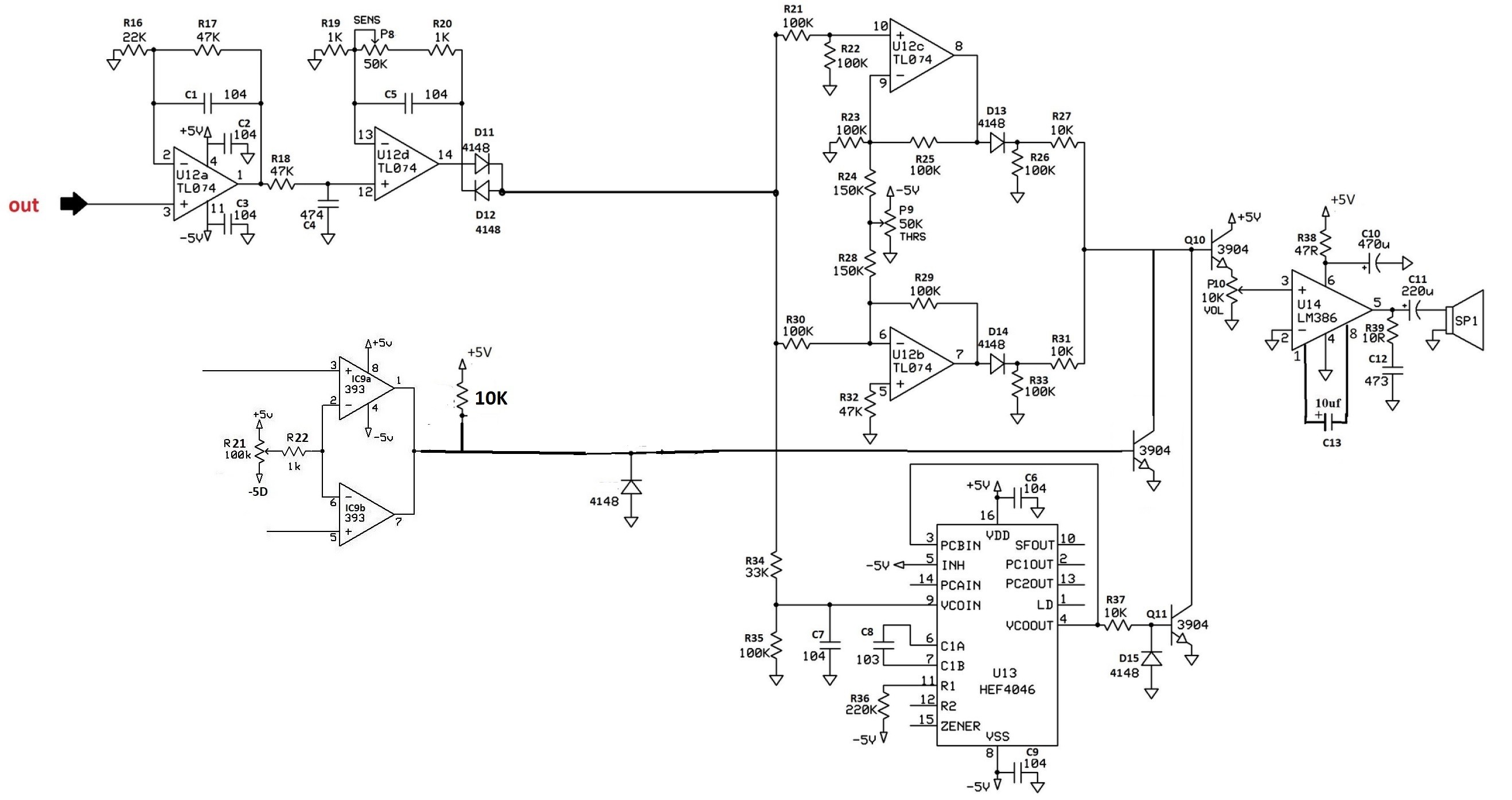

                              Do you think the added diode to base of 3904 at post 522 is correct or the following (diode + 1k resistor is true?

                              • #524, not #522.
