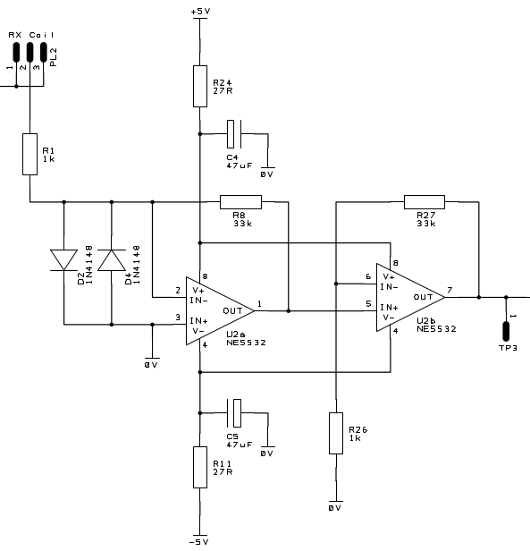

Today, i decided to make a new HH1,Rev.D for my brother. After building, i tried to set TP4 to zero,
For this, i always remove IC5, IC11,IC12 and IC8, then connect pin1-IC8 to ground using a jumper. After that, i uses R18 to reaching zero.
But today i faced to a strange, Voltage TP4 is -3V and my R18 has no any affect to the voltage. I checked more and more value of parts and i'm sure that all of them is correct. I checked the R18 multiturn using DMM and it's working. Do you have any suggestion for checking?
Thanks.
Thanks for your replying.
R13 is installed.
By removing IC6, TP4 voltage is zero. With it, it's 3V.
R18 itself is correct and its resistor is varying, but it can't vary tp4 voltage.
Voltage of both TP2 and TP3 is 0.021.
I also checked Pin6 of IC6, voltage of the pin and TP4 is identical.

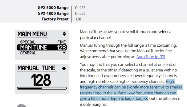

Time that i'm researching about GPX5000 Gain and its multi frequency method.
Please see the video.
I think maximum gain of GPX is 40-70us (according to the video).
I think also there is a direct relationship between GPX timing and its frequency.
Other words, its frequency will be changed if you change its timing.
For exp, its frequency will be changed if you changed its delay from soft to normal!
It seems that each timing works the best over a specific range frequency!
The video shows that normal timing can detect higher depth if frequency is decreased.
For this reason, GPX supports up to 5KHz!
Of course, i hope i understood correctly

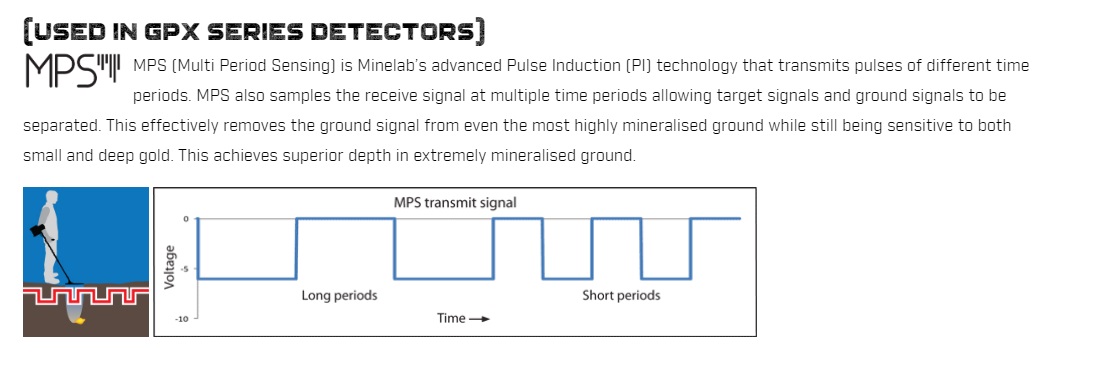

As I recall, the GPX has 1 long pulse followed by 3 short pulses. Woody only shows the 3 short pulses. You can increase the frequency of HHD but you will also need to decrease the pulse width in order to have time for the EFE sample. At 10kHz you have a total of 100us so maybe 20us for TX and 80us for RX.
Thanks.
I think your means is the attached.
Many people believe that GPX has a vey high sensitive than nugget. Other words, they claims that the machine can detect very high depth only with coil, instead of using frame. The only logical thing that reach to my mind is that its Gain (pulse width) and its frequency.
I talked with Woody, he told me "28us to 40us on small pulse in normal mode."
