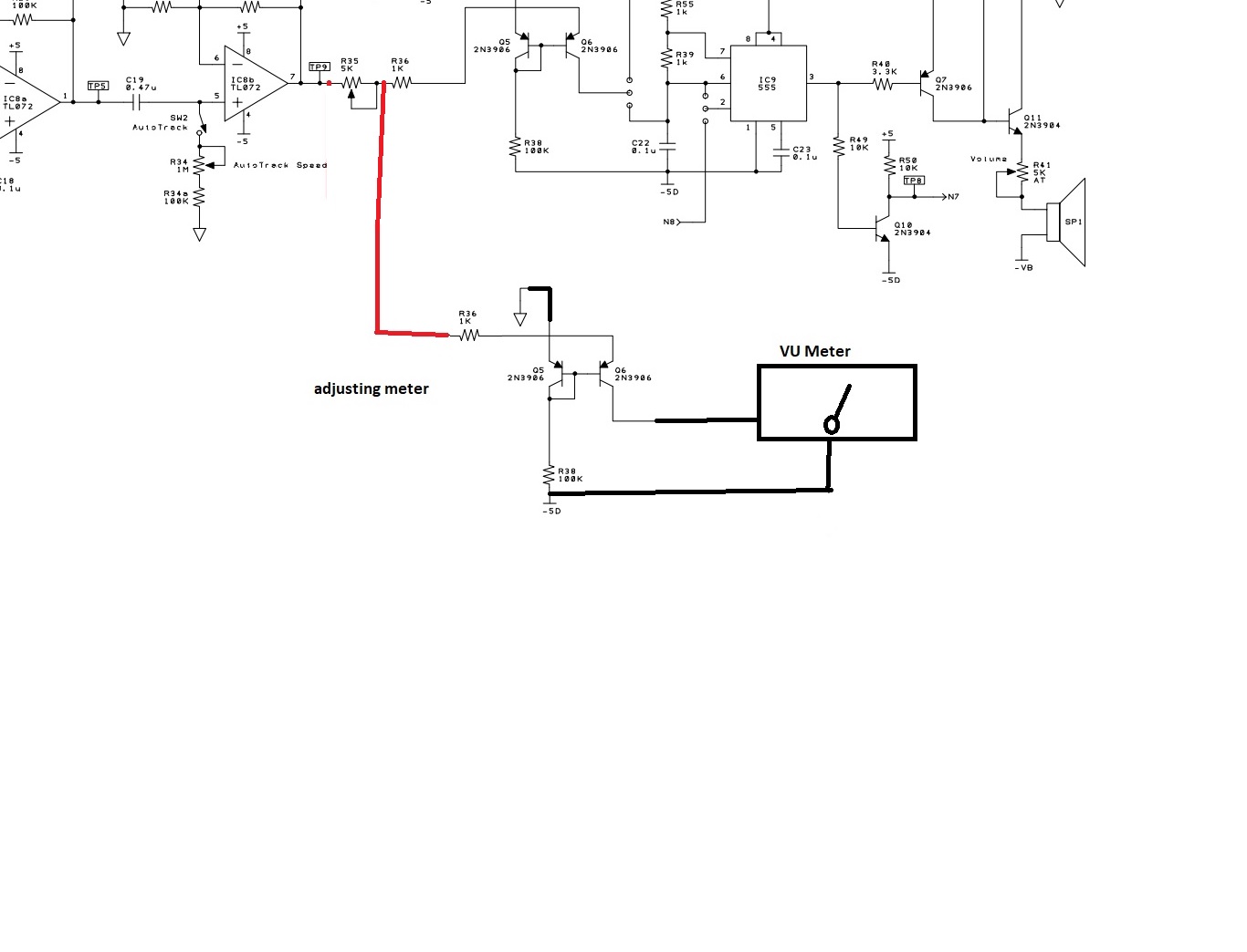

Dear Carl
I hope you are passing good days.

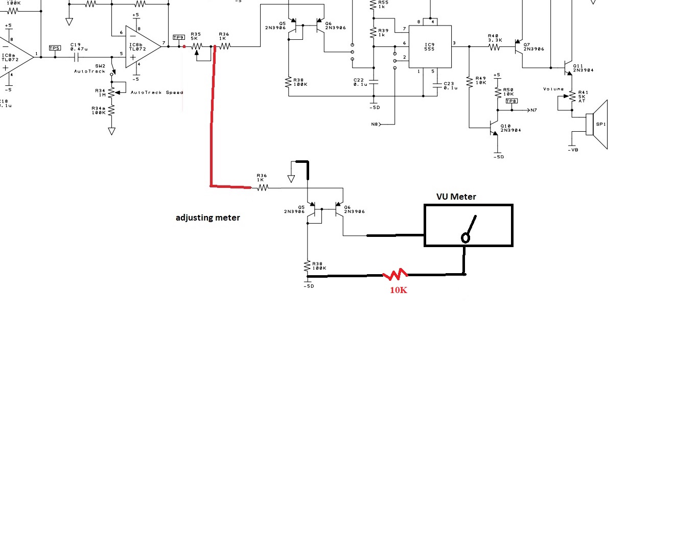

If you remember, you helped me to add a VU meter over my HHd (attached).
As you know, most of VU meter is ranged 300 or 500 uV.
I have a problem with it. As soon as receiving signal, the needle of meter always goes to endpoint.
I think voltage range of signal is much bigger than 300 or 500uV.
My question is, do you have any suggestion to convert output signal to 300 or 500 uV range?
Thanks dear Carl.Originally posted by Carl-NC View PostIncrease the value of R36 (the one that drives the meter) until it does what you want. You might also need a resistor in parallel with the meter, I would start with 10k.

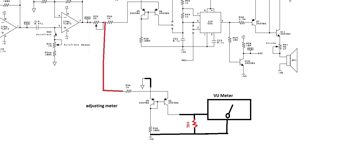

Please see attached, do you think position of the 10K is correct?

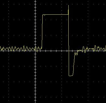

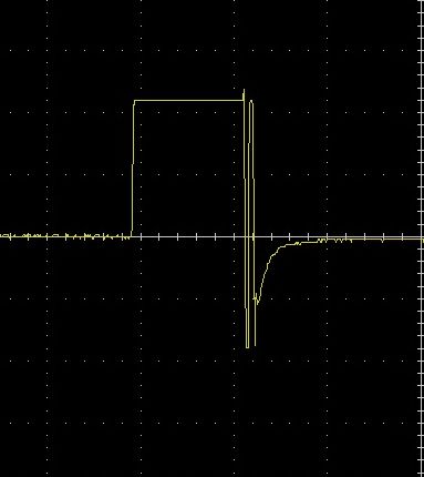

As you know, i have built a concentric coil.
Today, i tried to add a shield (graphite or foil) to both inner and outer coil but i had a problem.
As soon as connecting shield to ground (+B), my TP4 will be broken.
This is TP4 without shield
And this is with shield connection
Do you think it's normal for concentric coil?
