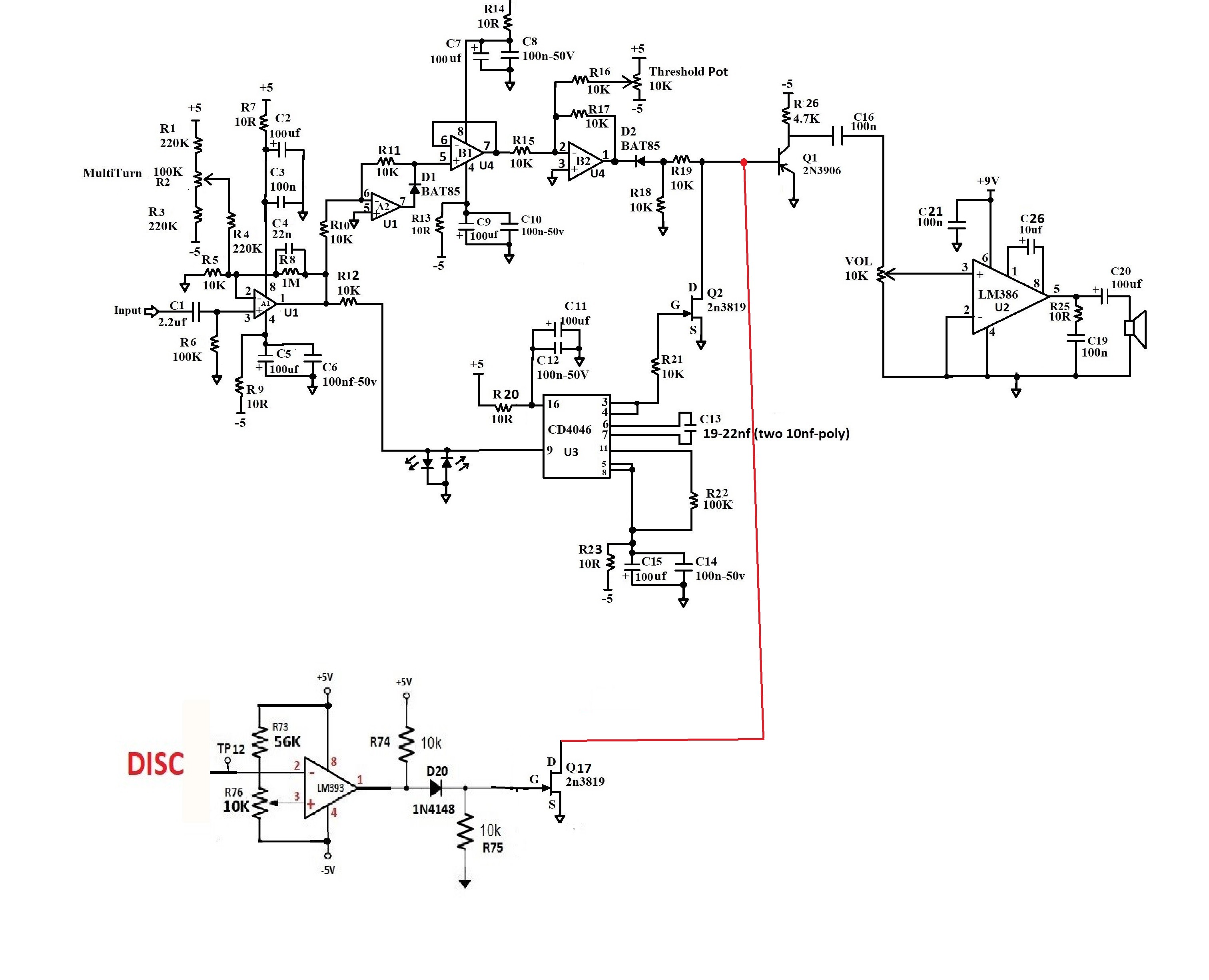

    Is the attached true?
    Do you think the pins S and D of Q17 is correct?

    • Remove D20 & R75. Q17 is OK.

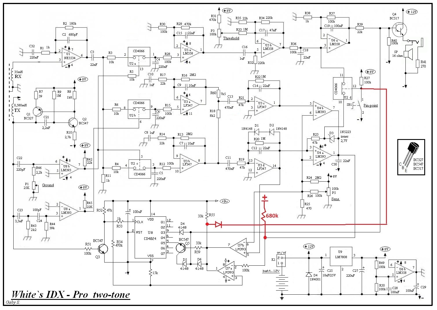

        Dear Carl, i want to design PCB of IDX pro (two tones).
        So, i checked Mr. Walter's two tones PCB. He used the Red diode and it is connected to U2in12.
        Do you think i need to put it on my PCB?
        Another question, a friend recommended me to add a 680K resistor (red 680). Do you think it is better to add it?

        • Without a lot of study I can't be sure of how that circuit works, so I can't offer any feedback.

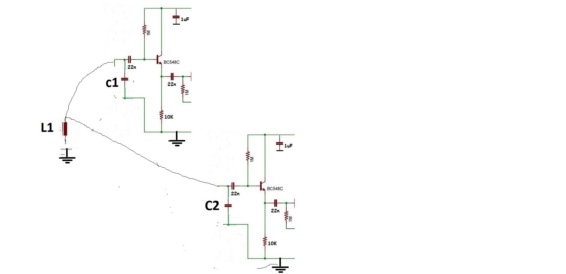

              Hello dear carl
              I have a basic question about resonance frequency.
              I read your book and you only pointed to multi frequency only via a overall diagram. I have a request, for better understanding.
              Please see attached, there is a coil(L1) and i want to connect it simultaneously to two TANK capacitors (C1 and C2).
              Consider following
              L1 = 1mH
              C1= 10n
              C2= 22n
              As a result,
              L1 + C1= 35khz
              L1 + C2 = 23khz
              My question is, do you think this connection can simultaneously receive both 35 and 23 khz?

                The answer is: neither one nor the other frequency. The two capacitors are connected in parallel, therefore the resonant frequency is different!

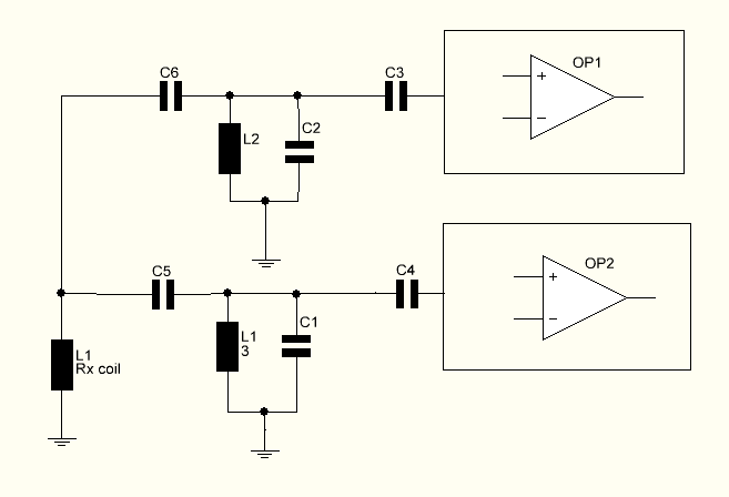

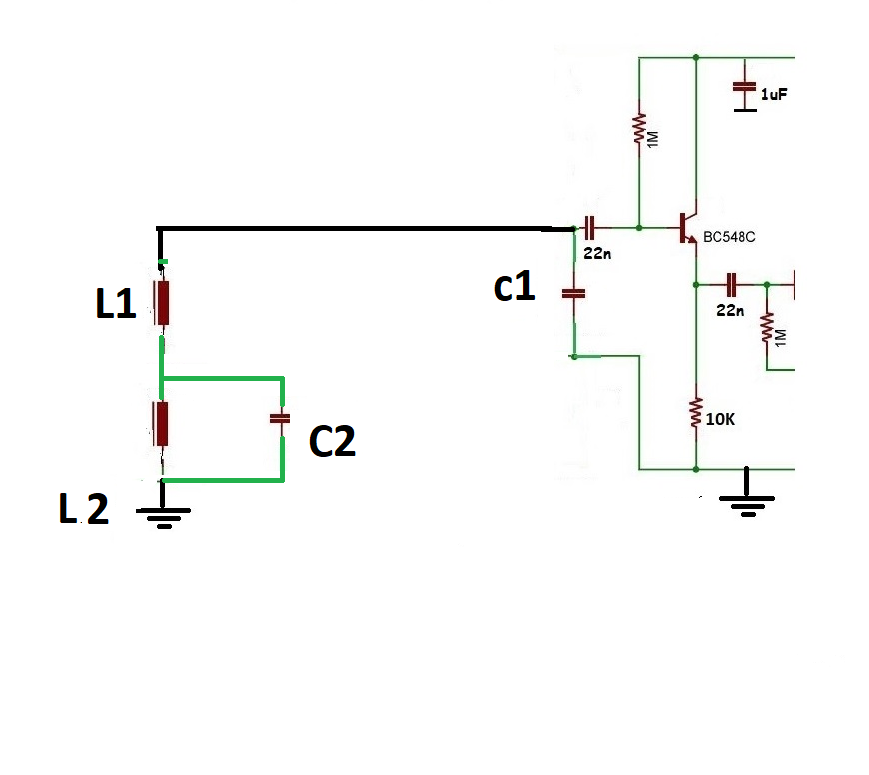

                          I had a talk, some suggested me coupling mode.
                          F1=L1+C1
                          F2=(L1+L2)+C2
                          This model can receive two frequencies Simultaneously.
                          Is it possible to tell me your opinion?
                          Thanks.
                                Are you wanting an RX coil that can receive 2 frequencies, or a TX coil that can generate 2 frequencies? What you show cannot oscillate, it has no feedback mechanism. Otherwise, I have no experience trying to do what I think you want to do.
