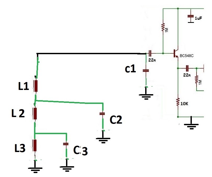

    Are you wanting an RX coil that can receive 2 frequencies, or a TX coil that can generate 2 frequencies? What you show cannot oscillate, it has no feedback mechanism. Otherwise, I have no experience trying to do what I think you want to do.

        I want to receive only two or three frequencies at the same time.
        Please see attached, this is named as coupling mode (Tap).

        I have a question, which of the following is true?
        Calculation 1
        F1=(L1+L2+L3)+C1
        F2=(L1+L2)+C2
        F3=L1+C3
        Or
        Calculation 2
        F1=(L1+L2+L3)+C1
        F2=(L2+L3)+C2
        F3=L3+C3​​
        • I suspect it's not so simple, and I don't know without either building the circuit or simulating it. But you can do that, so I suggest you put it in LTSpice and find out what happens.

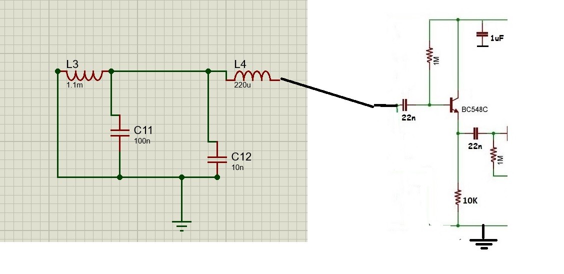

            I have a another question. Please see again schematic of #618, do you have any suggestion for making a bandpass filter?
            For exp, i want to only receive from 5Khz to 30Khz range. Suppose that we have two coils ( inductor) and two resonance capacitors.
            First Tank is tuned to 5Khz and second is tuned to 30Khz. But i do not know how to draw a bandpass for this range via this coils and resonance capacitors.

              • Something like this maybe...

                  Please check attached. Do you think the bandpass (from 15Khz to 107Khz) is true?
                        Again, I don't know without simulating it. It will also make a difference whether L3 and L4 are coupled (also polarity) or decoupled.

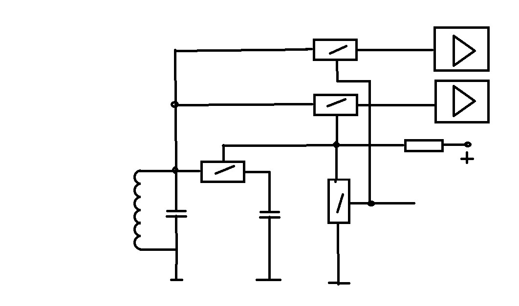

                            • All multifrequency designs I am aware of use a wideband RX coil and either do narrowband filtering in the preamp(s), or with filters after the preamp, or use narrowband demodulators. I don't know of anyone trying to use narrowband RX coils.
                                Suppose that L3 and L4 are separated (independent ).
                                Generally, do you think it is better to be used coupled or decoupled?
