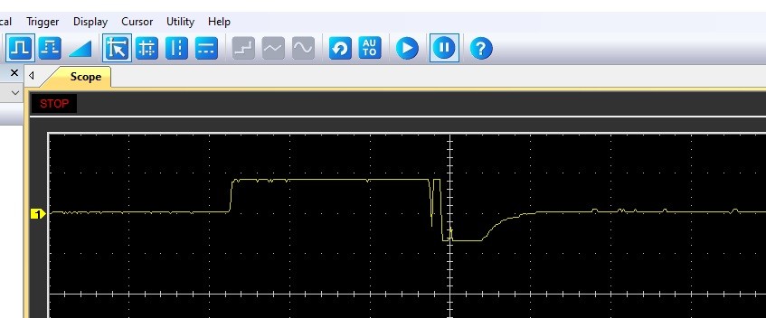

          Click image for larger version  Name:	VLF.jpg Views:	0 Size:	50.8 KB ID:	444082
          Do you think this is because of gain of two preamp (My DISC gain 220, HHD gain 1000 )?
            Yes
            Sorry
            Finally i could find the problem.
            RX shield was problem.
            Now it works very nice.

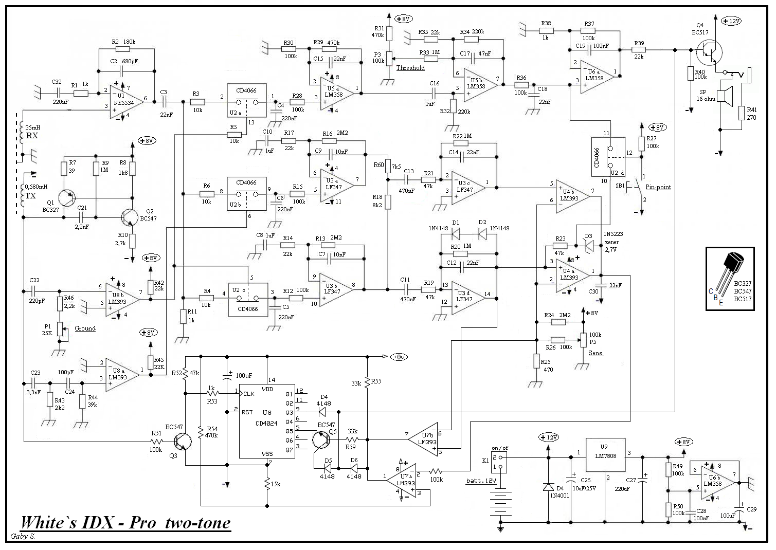

                  Yesterday, i had a talk with a member of Russia group. He sent me a version of IDX with VCO Audio (attached).
                  But no one answered my simple question about this because most of them has built its simple one tone version.
                  My question is, please consider that i adjusted DISC pot so that it has removed Iron.
                  In this case, Does the VCO (4046) produce an different tone for Iron or it is silent (not any audio)?
                  Is it possible to see the schematic and tell me your opinion?
                  Thank you.
                  • It looks to me like it will blank the audio.
                      Thank you.
                      So, i have to build the two tones model (attached).
                      Before designing its PCB, is it possible to check it for any error?
                      Thanks.

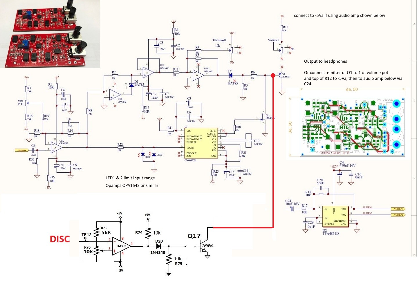

                        Dear Carl
                        I already built Mr. Mickstv's Audio.
                        I want to connect my IRON output (LM393) to it for blanking audio.
                        Please see it, do you think this connection is true for blanking?

                        • I doubt it, but I also don't see how this speaker driver works.

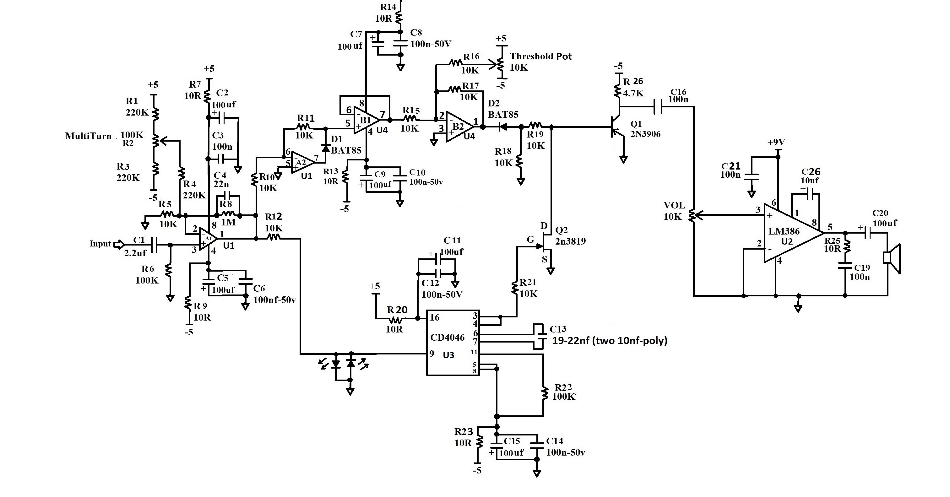

                            Now, i am using this schematic (Mr. Mickstv) with LM386.

                              Dear Carl
                              Please see #598, it is the same Mickstv's audio schematic with lm386 (audio driver).
                              I already built it for my HHD and it works nicely.
                              Now, can you tell me which point i can connect to collector of 2n3904 (out of my Iron DISC) for blanking audio?
                              Thank you.
                              • I think you will need to replace the 3904 with a 3819 and put it in parallel with Q2.
