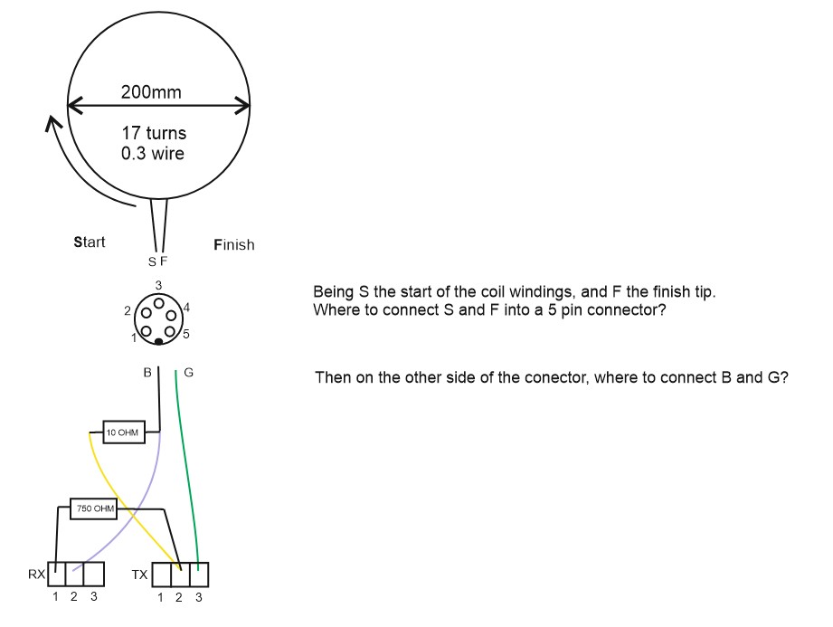

    i did found this one, regarding coil connection to pcb.

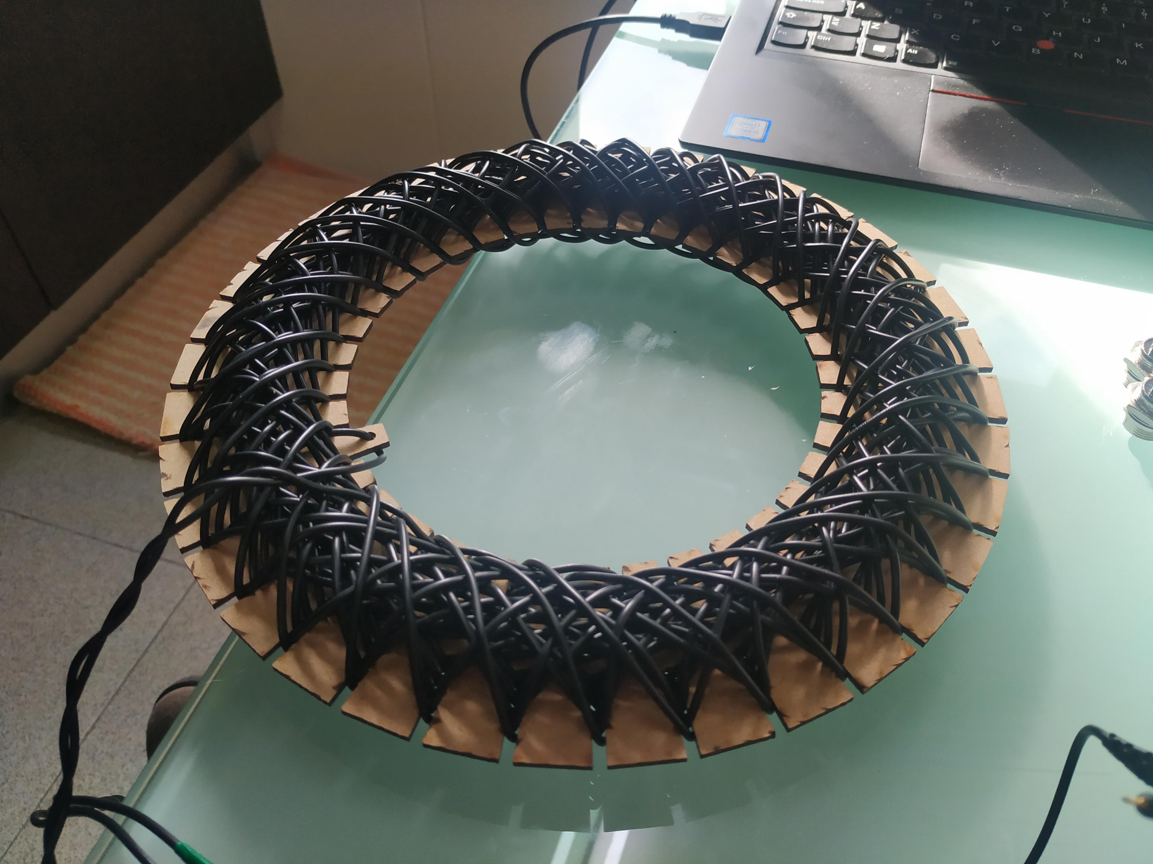

    i intent to make a homemade coil, so far i get to this sketch, following your video. However, i'm not sure how to join S/F/B/G.
    Can you help this NEWBIE?
    Much appreciate for you time.

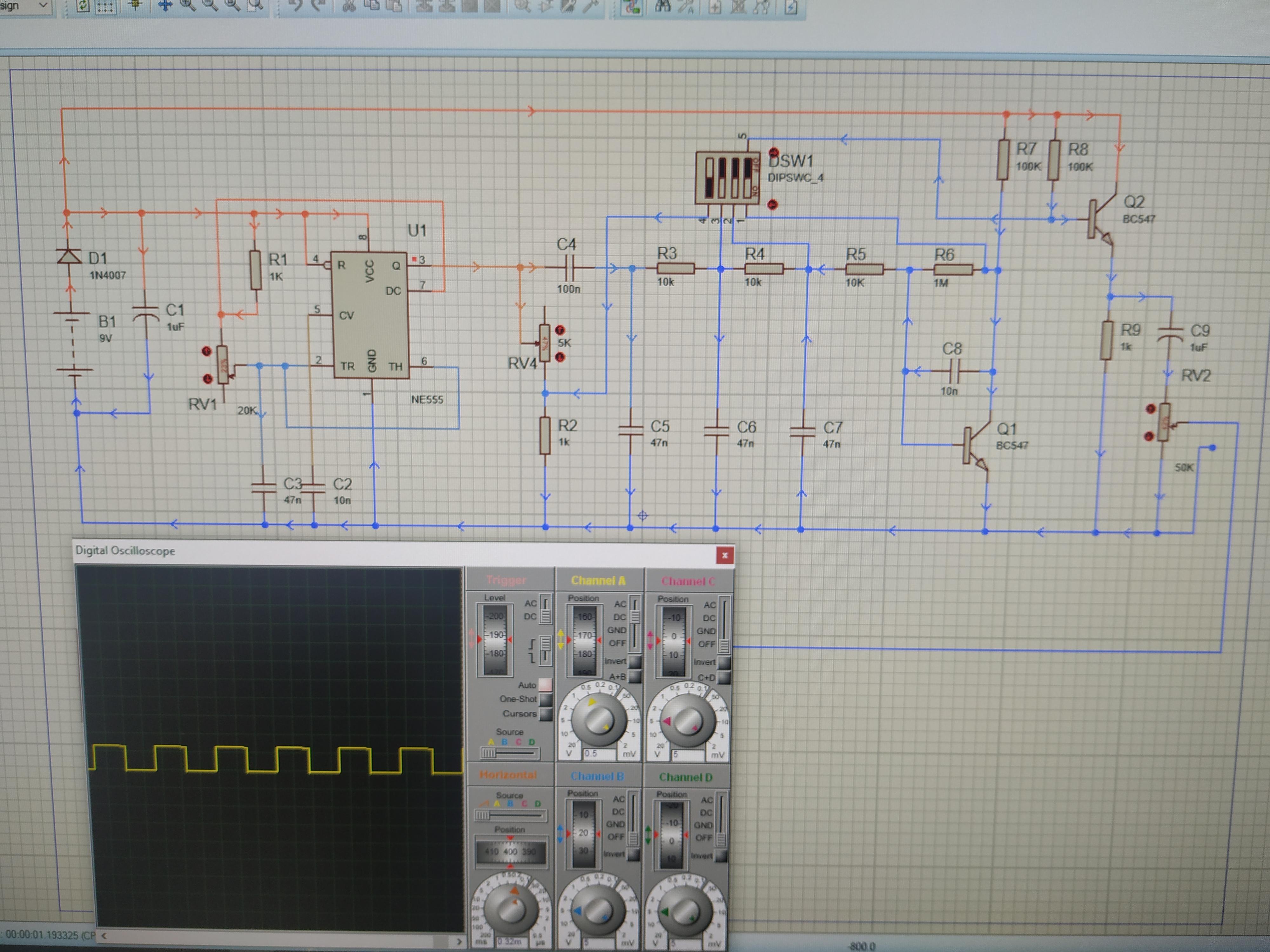

                      You can make a simple square wave oscillator from a 555 timer circuit or a single opamp. Lots of info on the Internet for this.
                      I was able to draw this scheme.
                      I Will try to out this in to a proto-board or so.

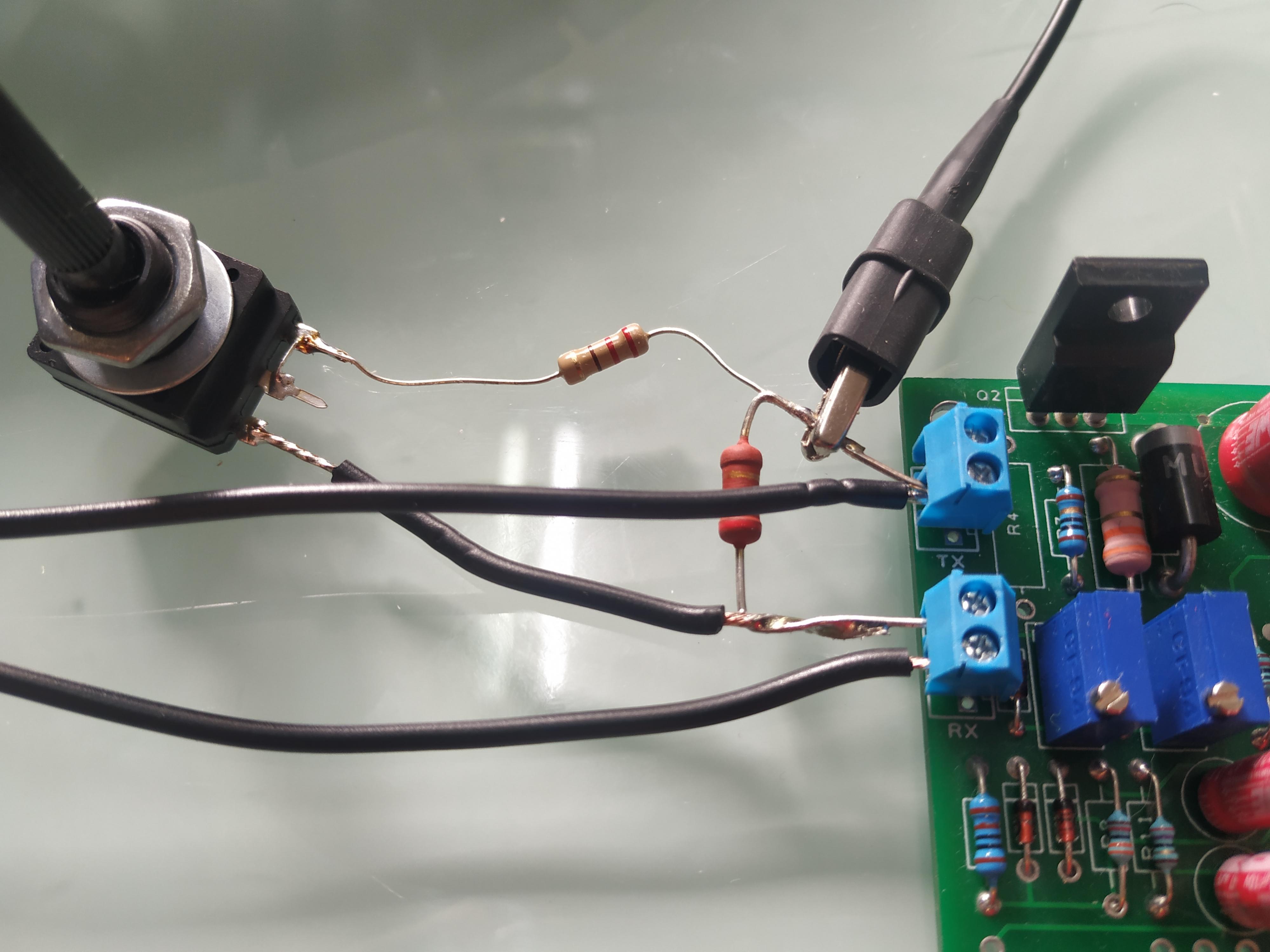

                      • Hi everyone,
                        i'm still stuck on this step 4 of the minipluse plus.
                        i started 5 units pcb, i wantend to build 5 minipluse plus. Along the way, 1 unit 79L05 was soldered backwards and still aside, It can be fixed later.
                        i was able to do step 1, 2 and 3 on the others 4 pcb's.
                        however i'm frozen at step 4.
                        i bought a hantek 6022be digital oscilloscope to help me out. it's not a great machine but i could afford.
                        the think is i don't have a large money fund to buy a decent one and a signal generator to proper calc the coil inductance and determine the damping resistor R4.
                        so i dig Surfdetector videos, (thanks's surfdetector!), and i built a damping jig as he described.
                        i also built a basket weave coil, according other threat's in this forum.

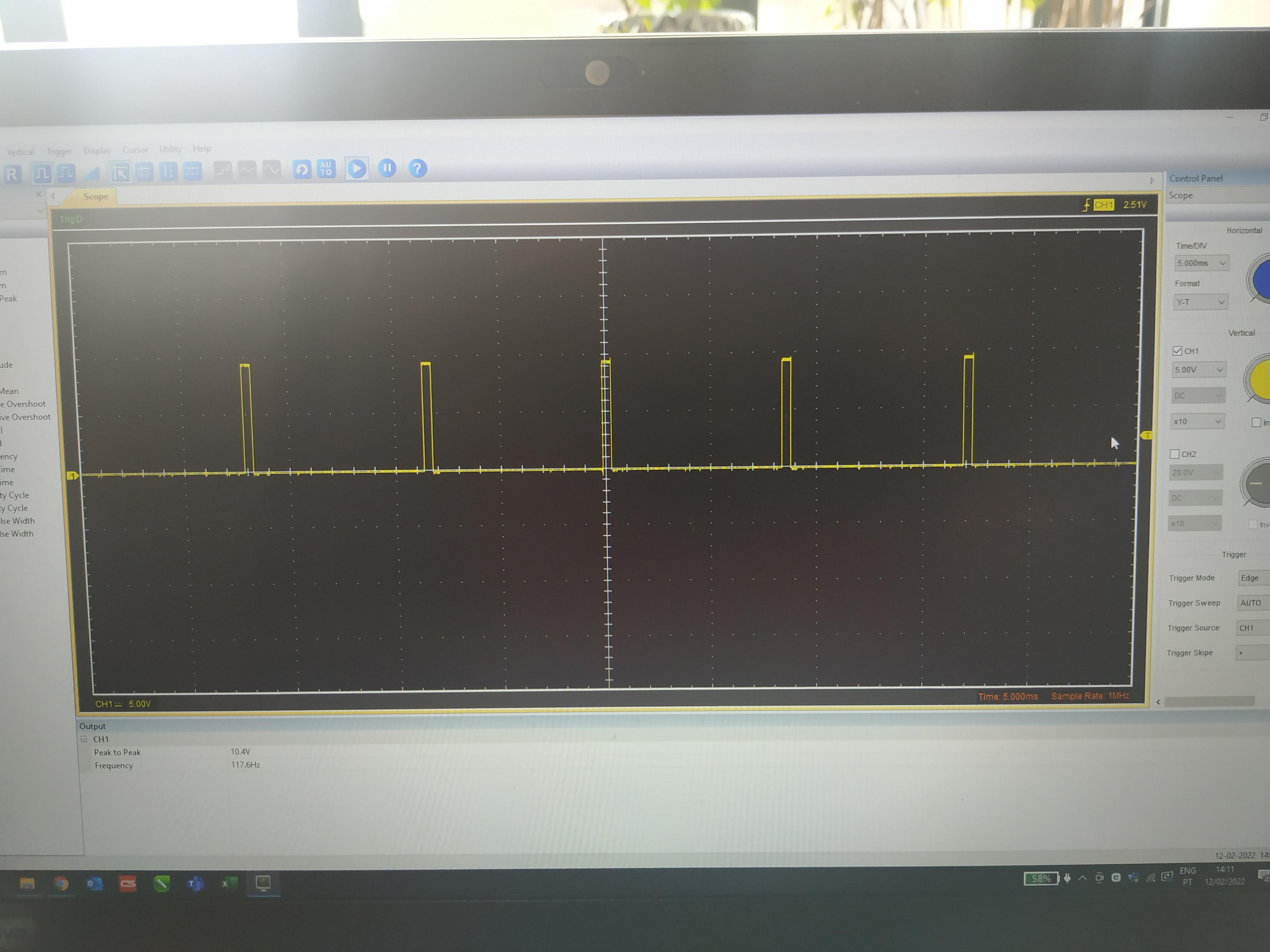

                        but i not reading the 350V flyback on my scope.
                        my probe and scope software is set to 10X, but peak to peak i only see 10,7V. and kind of a square wave trought the damping jig.
                        i toke some photos but i computer is crashing when i try to upload them.
                        is there any "check" i can make to see what is wrong with my step 4?

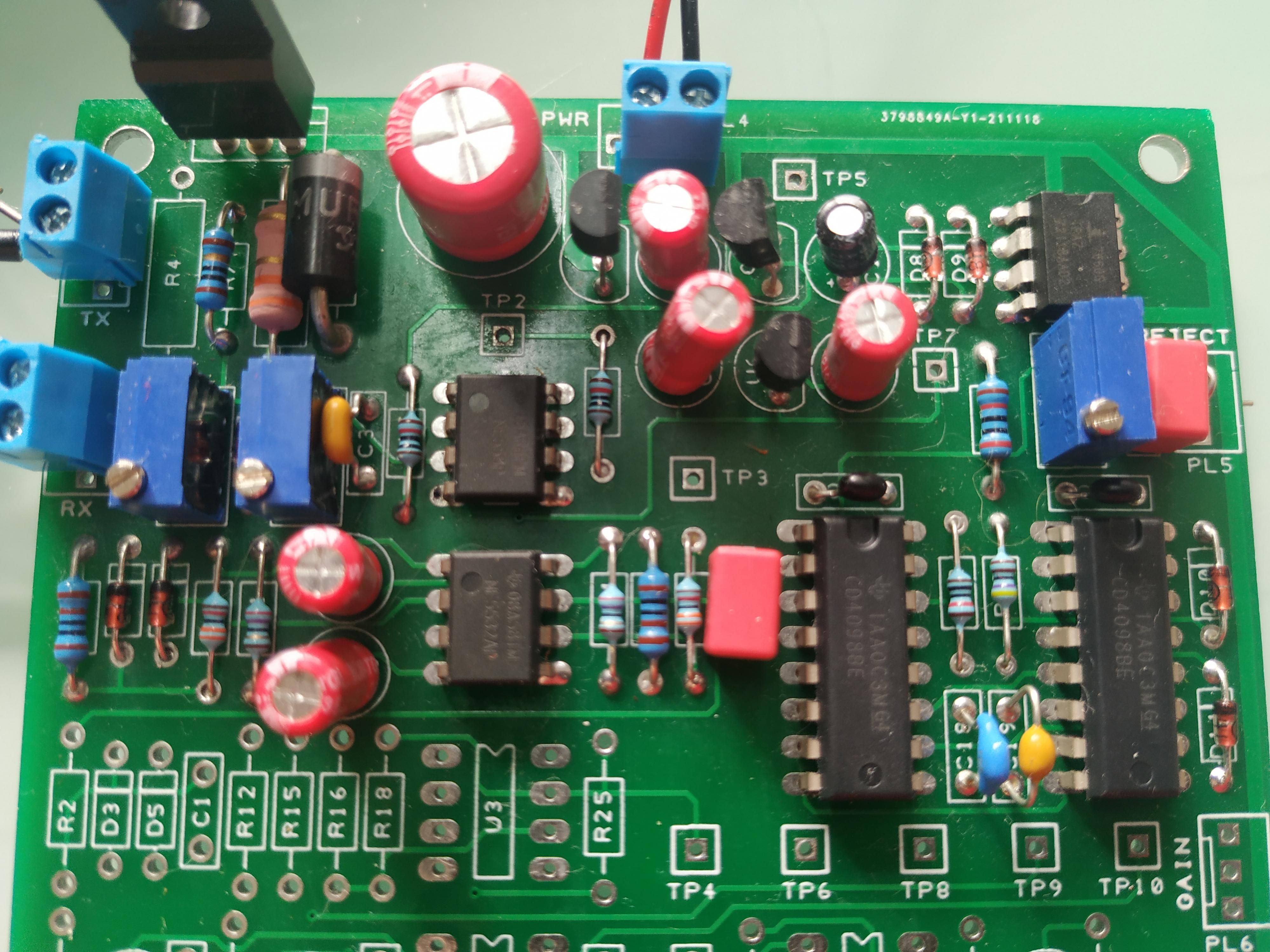

                        • Originally posted by Coolmakina View Post
                          Hi everyone,
                          all parts checked and they are as spec, except that i have installed IRFS840B instead of IRF840....could this be the cause?
                          • IRFS840B should be fine.
                                Unless they are bad.
                                Seen a v?deo teste where testing with mult?meter set to diodo i shouldnt see voltage going trougth g and a of the MOSFET. Mines are ****fting voltage both ways. I think i Will replace them..
                                Any others ideas?
