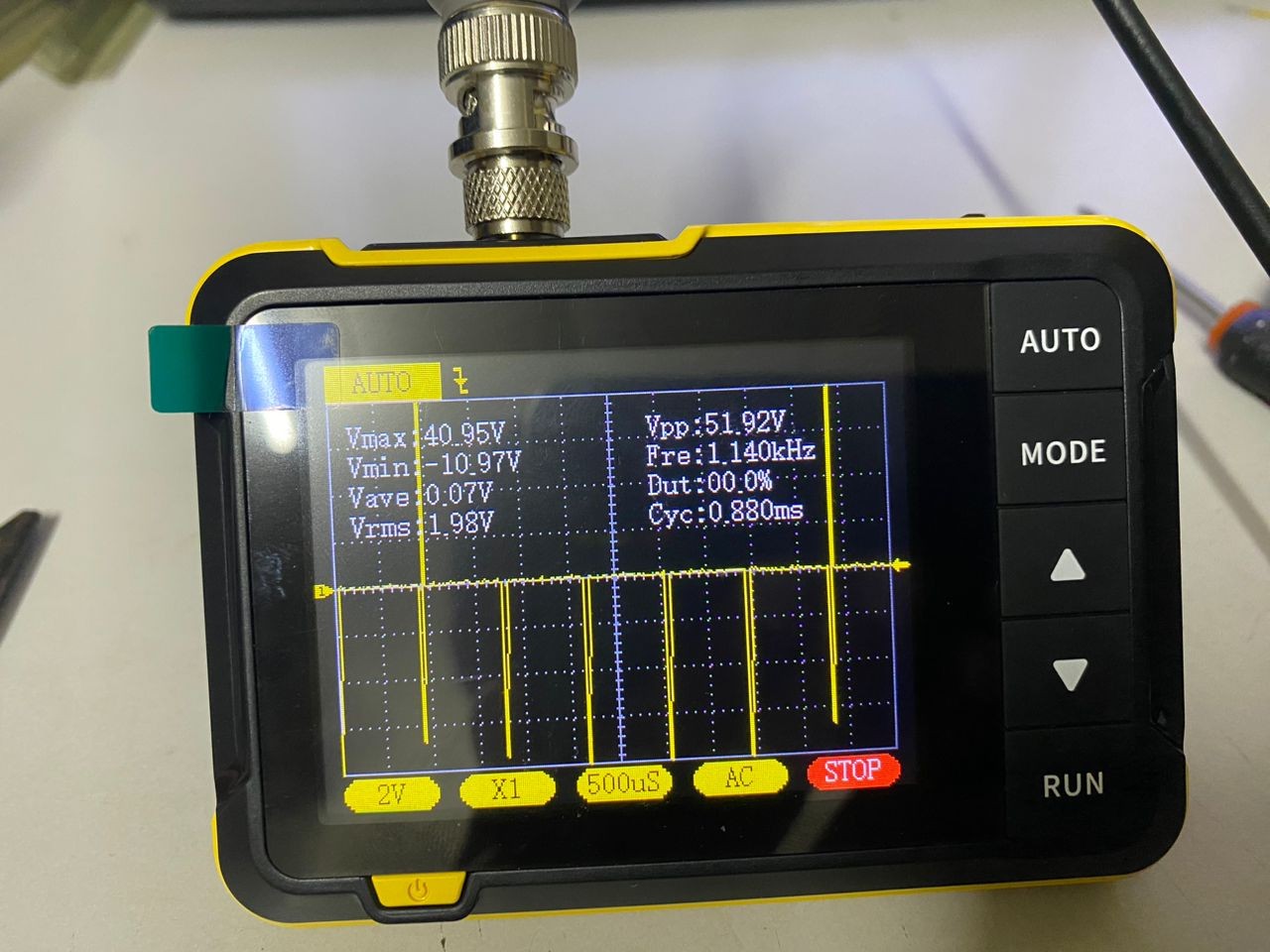

          • Originally posted by paku View Post
            Can someone explain how to test coil using this scope
