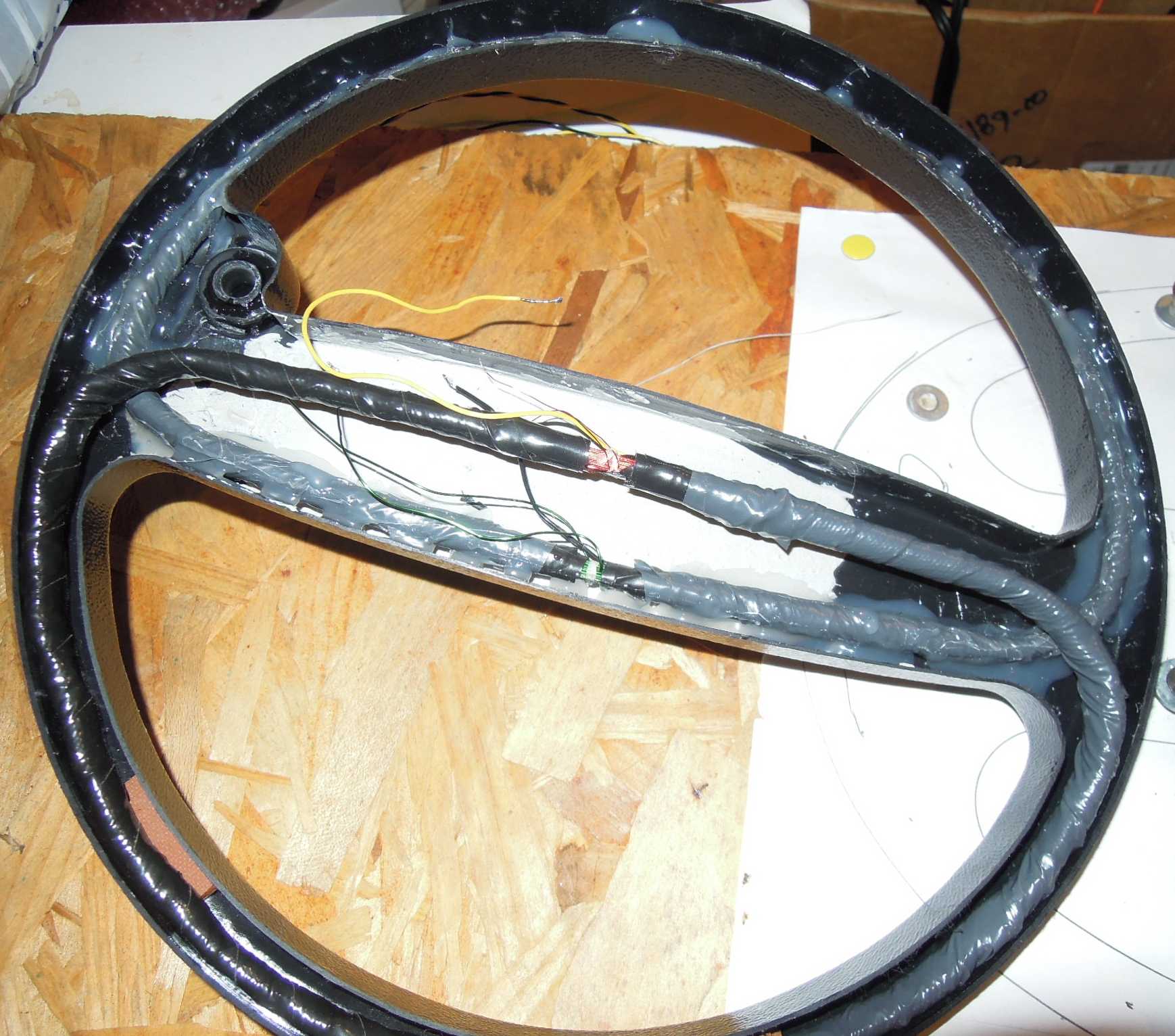

            Oh man, those are some cool coils - if I may ask - are the coil shells still available or did you get them from Hays? & the center tapped coil - is that an approach to have tx & rx coils? I'm familiar with center tapped transformers but those are a different beast...

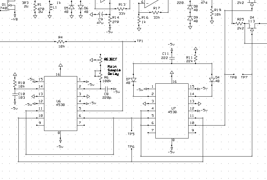

            Making a fast one is a little tougher. I'm not sure if the one shots used on MP will allow
            very short delay times?
            Not sure what this means - one shots?

                  The center tapped coil allows a fast TX (as you drive only one side) and low noise on the RX
                  (as you use a differential preamp).

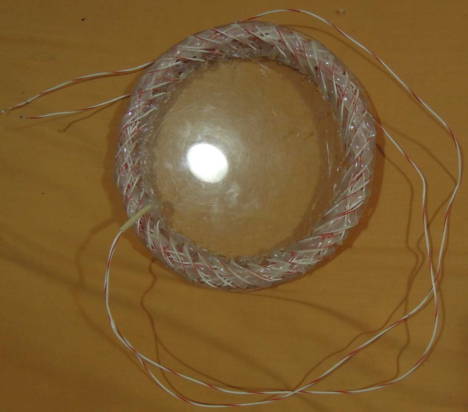

                  You can make an easy basket coil using a jig saw to cut the circle and then just drill holes.
                  I made this one;

                  The one shots I was talking about are the 4538's on some PI's they used 74HC221's which had
                  a minimum pulse width;

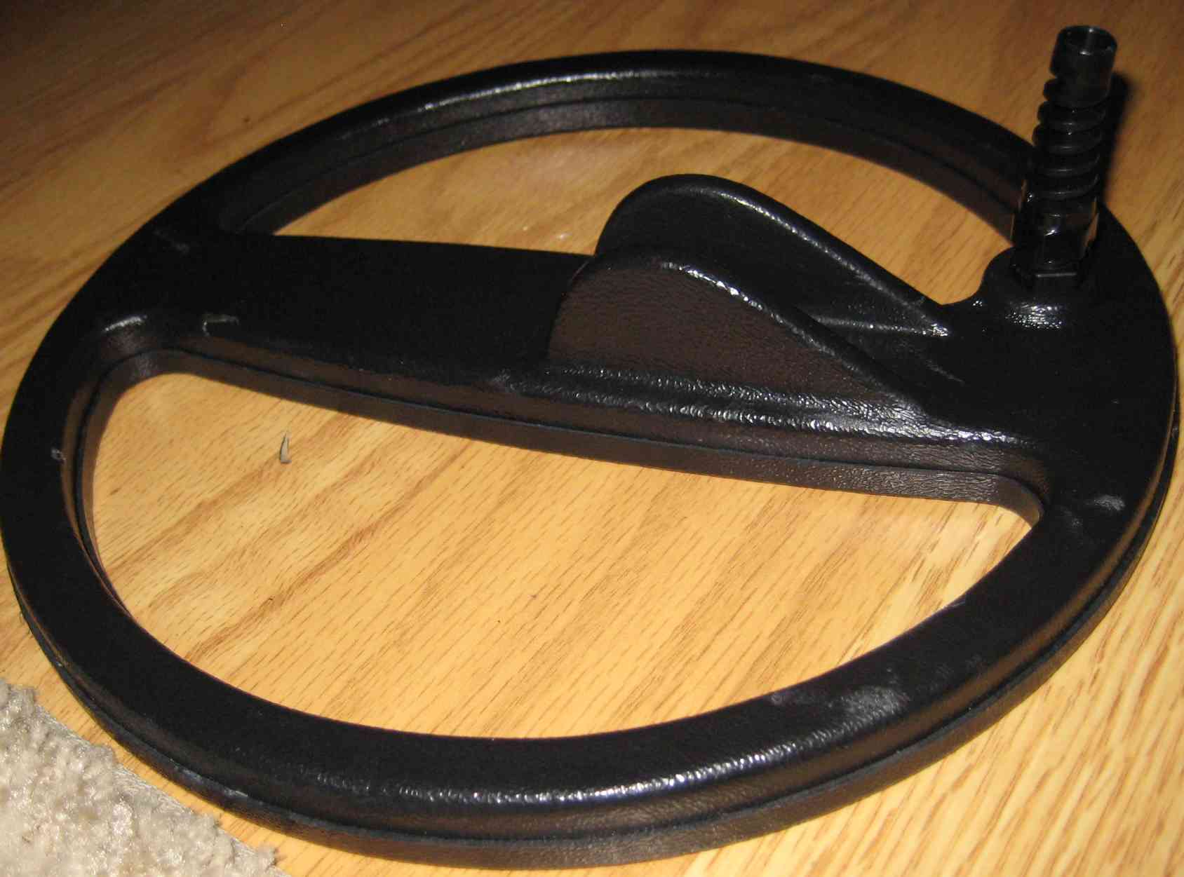

                    I just remembered DBFlowers sells housings too. I got a couple 9" with covers off of him.
                    https://sites.google.com/site/dbcoil...10-inch-shells
                    This is one of his housings;

                      I just remembered DBFlowers sells housings too. I got a couple 9" with covers off of him.https://sites.google.com/site/dbcoil...10-inch-shellsThis is one of his housings;[ATTACH]31437[/ATTACH][ATTACH]31438[/ATTACH]
                      Thx! - these are nice, now I know where to get one, I think the 9" would be the first one I would try
                        I made this one;
                        [ATTACH]31435[/ATTACH]
                        OK, I'm in! I want to make one of these, might as well go for the "gold" and take a shot at building a nice fast self shielding coil right off!
                        If you have any sources of specific instructions, patterns, howto's that would be great - from what I could tell from the coil building posts, they seemed to assume someone already knows the basics of building these and knows how the form should be made, what materials are used, how to actually correctly wind it, etc.
                        It appears this coil is too big to fit in one of the pre-made DD coil shells, am I right on that? If so I'm guessing the most popular way to enclose it is via fiberglass work.
                        I did read that if someone is going to enclose it in fiberglass they use lexan for the form. I would really like to find the specifics on how to make the form, how to wind it, how to fiberglass it and include the pole mounts, etc.
                        I will continue searching for all this as well...
                          OK, update on the basket weave coil build info - I am becoming obsessed with building one of these LOL so I am putting together specific info and specifically for the MPP - when done I will put in a PDF complete with test results, measurements, etc.
                          I have found fragmented info on the form build and fiberglassing it. I believe I will be able to put together a layman's howto to build this for the MPP project.
                          The one thing that still eludes me is how specifically to wrap the wire on the form. I have found where folks have wound it wrong and had bad results, but have not found step by step of how to wind it correctly, could use some help on this...
                            Have a look in this thread on how to make the form and how to wind it (look around #111);
