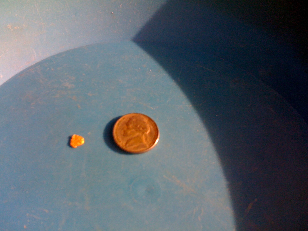

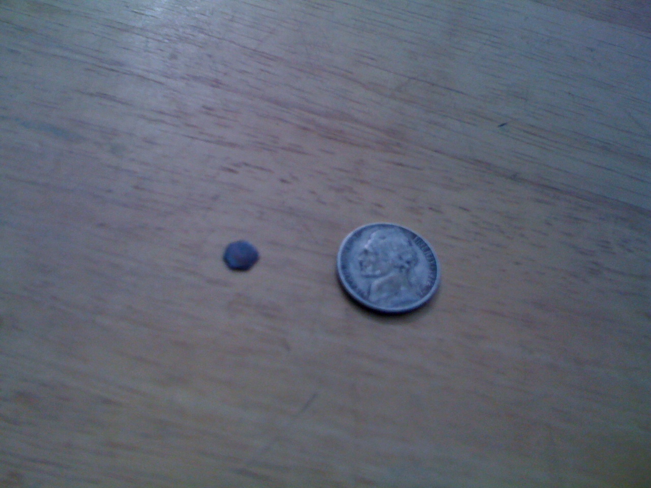

                    • I recently received a .22 gram flat gold nugget as a thank you, & tried it out as a test target on my MPP - got some interesting and different results than expected:
                      Air tests with delay at shortest, sensitivity at most sensitive, SAT about at project spec -
                      1) target oriented parallel to coil, repeatable target signal in center of coil - distance of about 2.5" 6.35cm
                      2) target oriented parallel to coil, repeatable target signal when right over coil winding at edge of coil - distance of about .75" 1.14cm
                      1) target oriented perpendicular to coil, repeatable target signal in center of coil - distance of about .25" .635cm
                      2) target oriented perpendicular to coil, repeatable target signal when right over coil winding at edge of coil - distance of about 1" 2.54cm
                      I repeated the above with a test lead target I made to be reasonably close to the gold target in physical dimensions and got about the same results.
                      The good thing is that - this is the smallest gold & shortest TC target I have had a target response from.
                      It's interesting how the target response is reversed based on the orientation - and that the response is stronger right over the coil windings for the perpendicular target. When scanning the ground this would have the effect of two target signals.
                      The down side is that when I adjusted my MPP to be reasonably stable while scanning over mineralized ground (much lowered sensitivity & much faster SAT) I could not detect the little nugget.
                      So I guess I'm back to wanting GEB on my MPP, I'll reread Davor's & other's posts on GEB & think on it for a bit & see what it will take to try to add GEB to my MPP...
                      Each target is next to a US nickel (coin)

                      • If you imagine looking at a cross-section of the coil windings, with the magnetic field lines circling around the cross-section, you can see why the parallel target is strongest at the coil center, and weakest at the edge. And vice-versa when the target is perpendicular to the coil.
                        What are the diameters of the gold and lead test targets?
                        By the way, do you have the names of the Gold and Lead images swapped over? The lead target looks gold in color, and the gold looks lead colored.
                        • Hi KRinAZ
                          That is good results for a such a small target.
                          Qiaozhi my view shows gold color for the nugget. The lead has a dark blue color with the nickel a blue hue. Must be different browsers. I am on Goggle Chrome.
                          Have a good day,
                          Chet
                          • gold color for the nugget. The lead has a dark blue color with the nickel a blue hue.
                            Me to.

                              • Originally posted by Chet View Post
                                Have a good day,
                                Chet
                                What?
                                I'm sure they were the other way round, and I checked it more than once. Must have had too much wine.
