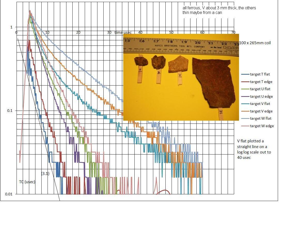

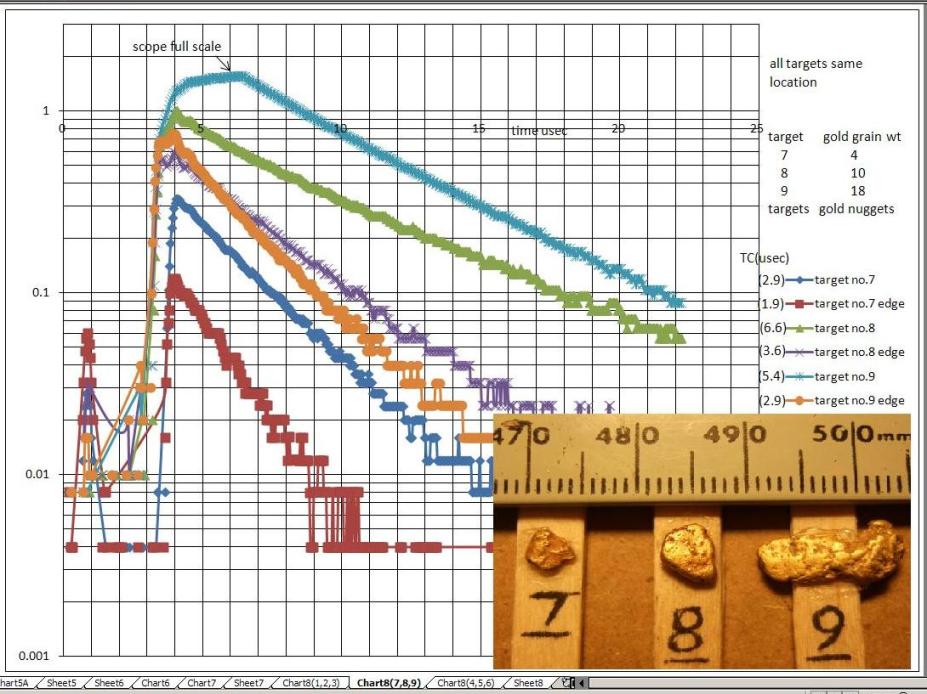

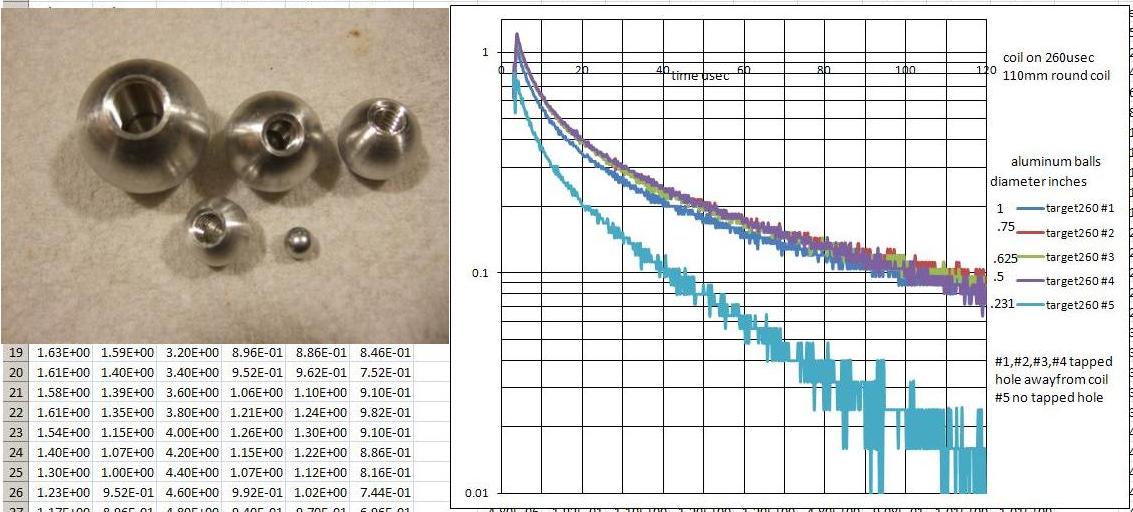

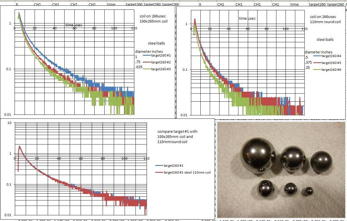

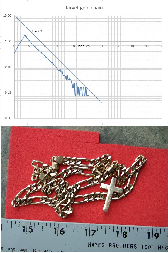

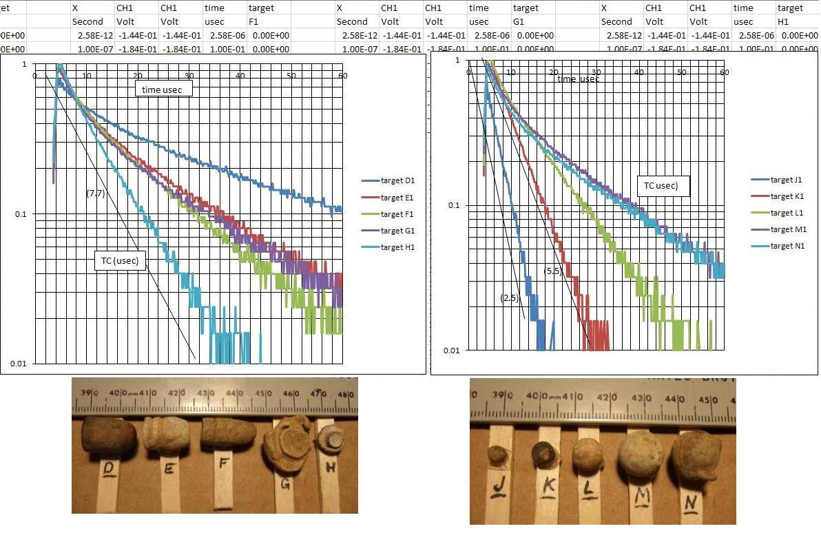

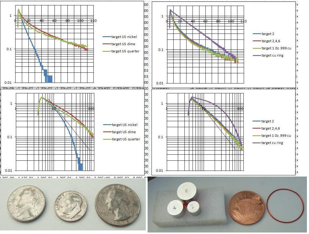

          Some pictures from other threads.(gold chain) need to scan down to see ruler for size, exponential decay TC=3.8usec.(coins, al slugs, cu coin ring) US nickel TC=10usec, wire ring TC=24usec exponential decay, the rest not. (steel balls) not exponential decay. (aluminum balls) not exponential decay. (ferrous) most, exponential decay after 10usec. (lead bullets) smaller, exponential decay, larger not. (gold nuggets_2) exponential decay, orientation effects TC. I don't remember having Tx on time or shape effecting TC for targets with exponential decay, maybe it can. Tx on time and shape does effect target decay for targets that don't have an exponential decay. If we are going to make a simple chart, need to define what the chart should look like. I think most larger targets don't have an exponential decay.

            How you calculate/conclude on TC?
            Par example, as I understand TC of target No. 7 is about 10 not 1.9 as stated.
            Can you explain a little more?

              One of two ways. Time between amplitude of 3 and 8 for 1 TC or time between 5 and 100/3(3 TC 1/20 or 5%), hope it's right. I usually draw a line on the chart parallel with the target in Excel where I can move it and get a closer reading.

                Thanks. For my understanding it is time between switch off and lower point of (back EMF) voltage drop. So I should correct myself for target No. 7 (gold nugget 2) - this way TC is about 6 not 10. OK, probably I will never touch some field in theory.

                  One time constant is the time for the signal to drop to 37% of it's value. 100 to 37, 8 to 3, 1 t0 .37. The signal should have an exponential decay, straight line on a lin-log chart.
