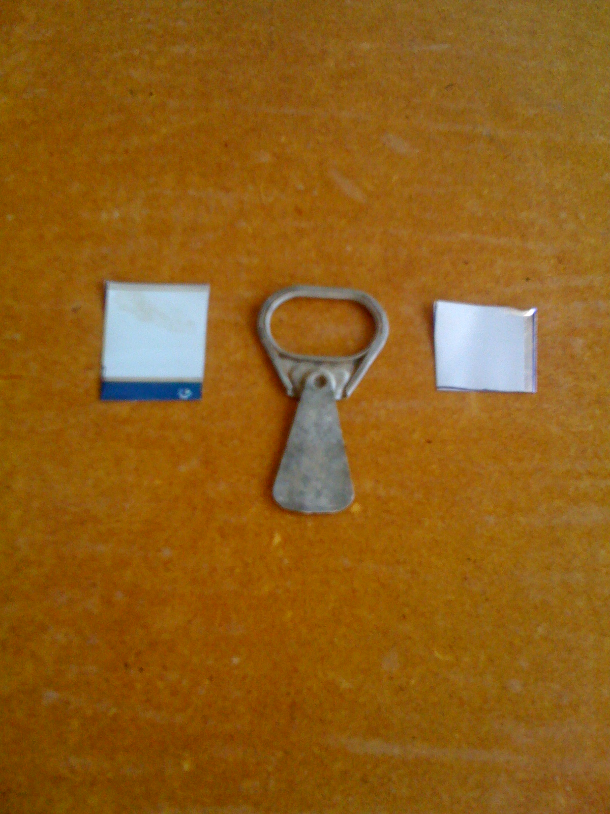

    OK I'll do that, & oops, I made a .75" square piece, now just realized you asked for .25", I'll have that test result tomorrow...

      Hi Dan, ok, I cut a 1/4" x 1/4" section from the (thin) side (not from an end or close to as the can is thicker there) of a Bud Lite can, I get a good repeatable signal at 6", faint but there at 6.5". FWIW I use the "X" method to discern repeatable target signals from - ground effect, etc, - so for me a good repeatable signal that I have "X'd" is one that gives a consistent signal for usually 6 or more passes.
      • 6" is an excellent result especially for a sample laying on clean ground.

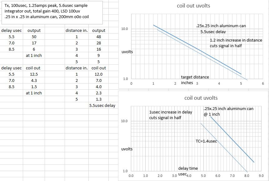

          I agree. I had charted the .25x.25 aluminum can awhile back. Charted more data to get a feeling what it might take to detect it at 6 inches. Not the same as KR's MPP but should give an idea of the variables. Both charts show a TC of about 1.4usec.

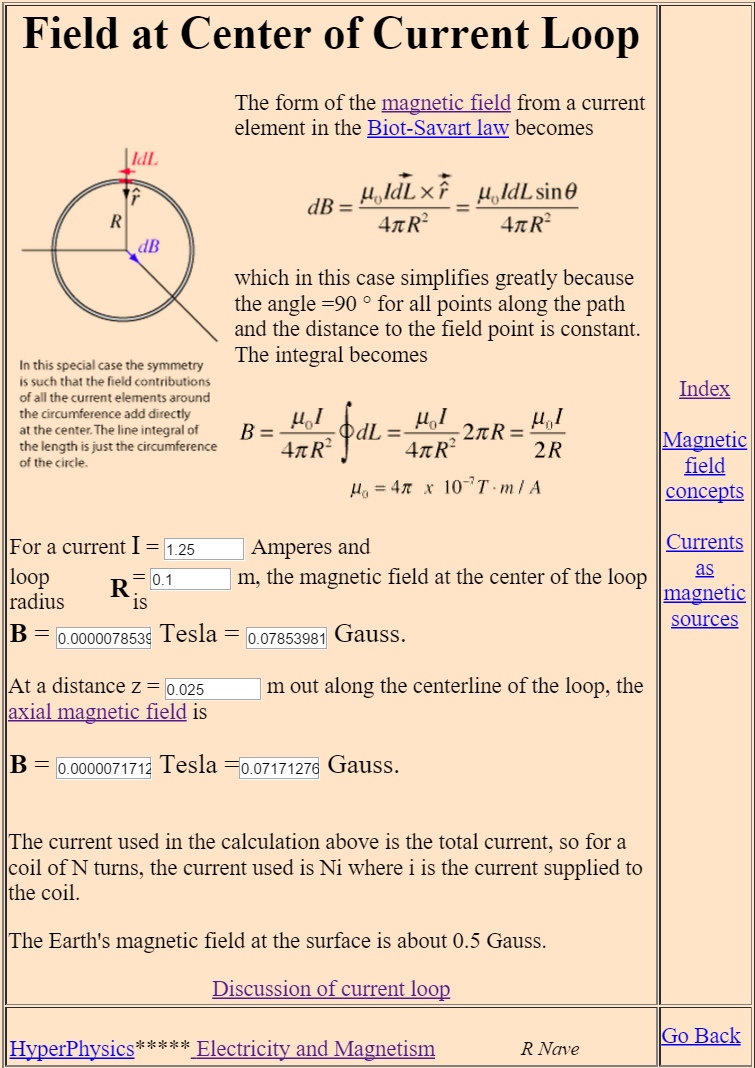

          • Field at axis of current loop
            Practical calculator

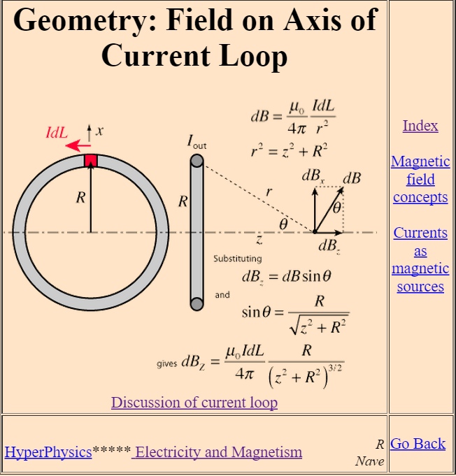

                  • Originally posted by Monolith View Post
                    Thanks for the calculator. I need to enter twice the distance for the calculated field vs distance slope to match the measured target vs distance slope. Calculate 4 inches for target at 2 inches, calculate 8 inches for target at 4 inches.
                      That makes sense, as the calculator gives the primary field strength at the calculated distance. The secondary field, the one generated by the eddy currents in the target, then has to travel back to the RX coil.

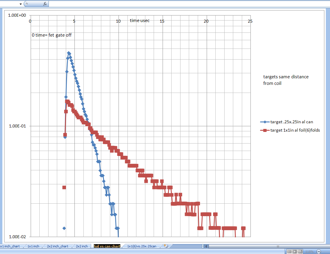

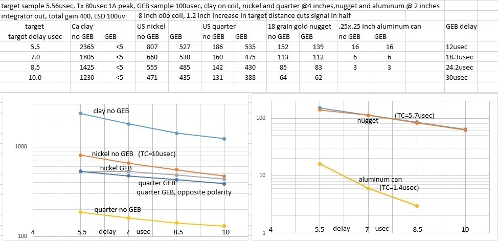

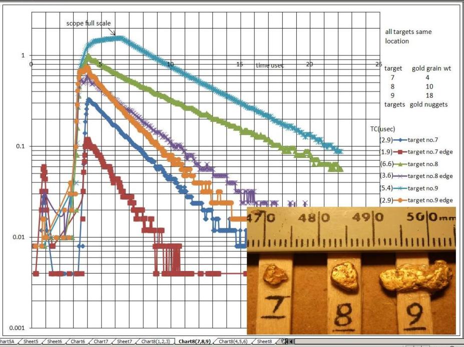

                      • Reply #274 I charted amplitude vs delay time for a .25x.25 in piece of aluminum can. Added more targets, California clay, US nickel, US quarter, 18 grain nugget and piece of aluminum can. Included a chart of gold nuggets I did awhile back. The TC's varied between 1.9usec and 6.6usec. The piece of aluminum can decays faster than any of the nuggets I tested. The nugget and aluminum can decay faster than clay. Adding GEB reduced the nickel, increased the quarter and did little to the nugget and aluminum signal strength. For the shorter TC targets 5.5usec or 7usec delay would be better.
                        • Good stuff Green! Looks like that 1/4 X 1/4" target is a pretty good/tough target. The gold nugget info is especially good too as it gives real world stats on what nuggets really do. I'd be interested to see how 4, 10, and 18 grain pieces of lead compare to the gold nuggets.
                          regards,
                          Dan

                            • Originally posted by baum7154 View Post
                              regards,
                              Dan
                              http://www.geotech1.com/forums/showt...get-simulation
                              Should be some info for different targets in gold nugget simulation. If you don't see what you want I'll try to add some more.
