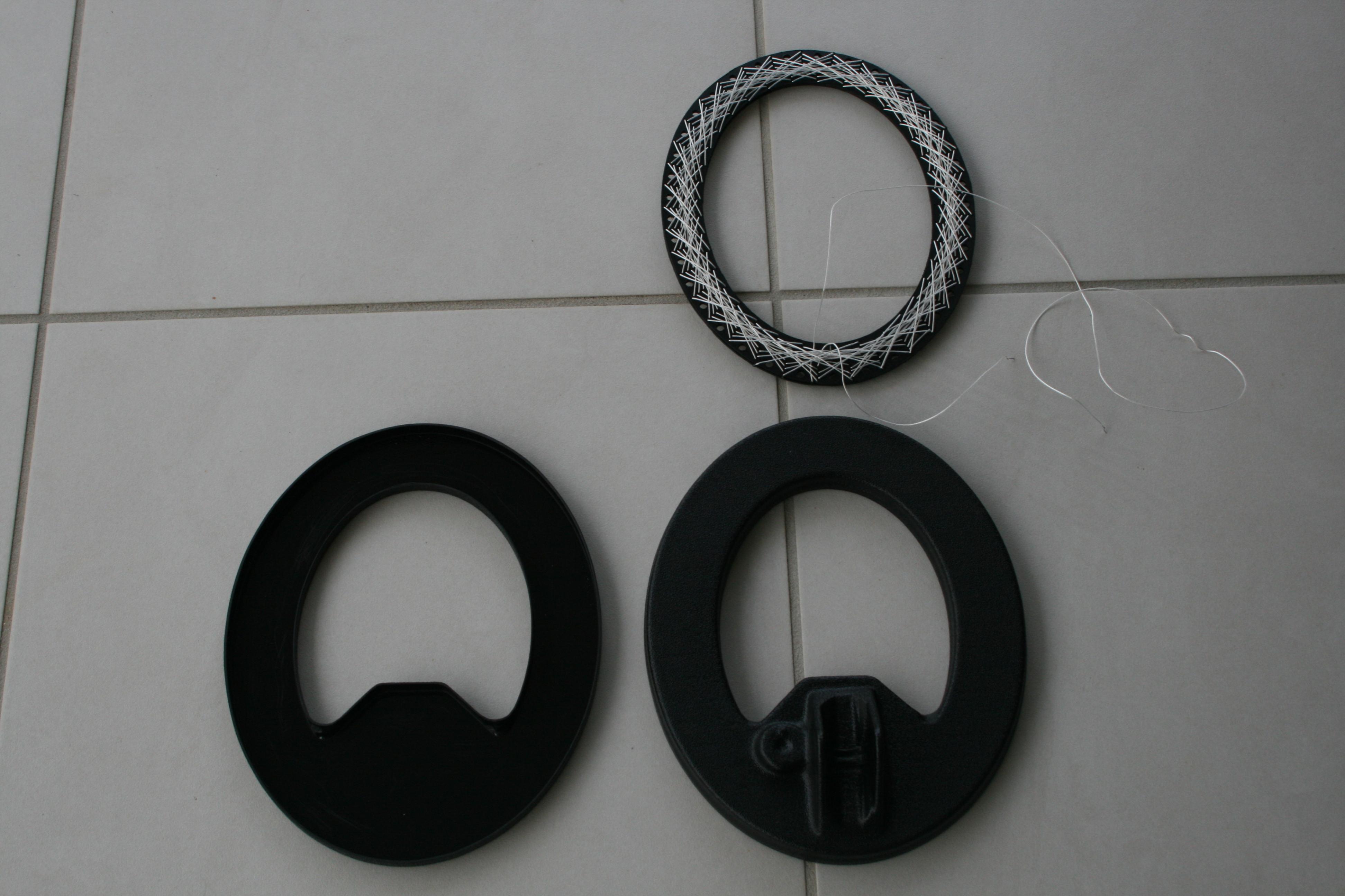

                        Since this is my first post I believe it is appropriate to introduce myself briefly. My name is Jacob, I’m Dutch but now living in North Queensland, Australia. I’m interested in the electronics side of metal detecting and that’s how I ended up at this site. I’m member of the local metal detecting club and my aim is to build my own PI gold detector with performance that can compete with commercial detectors.
                        I just completed the Mini Pulse Plus and will use this design as the base platform trying to further develop and improve, which was the intention of the MPP project (all credits to Qiaozhi and others who initiated this project).
                        My approach is to focus on each of the building blocks individually and see if there opportunities for improvement. I read post of the many bright people here on this forum which helped me a lot. I hope I'm able to contribute also.

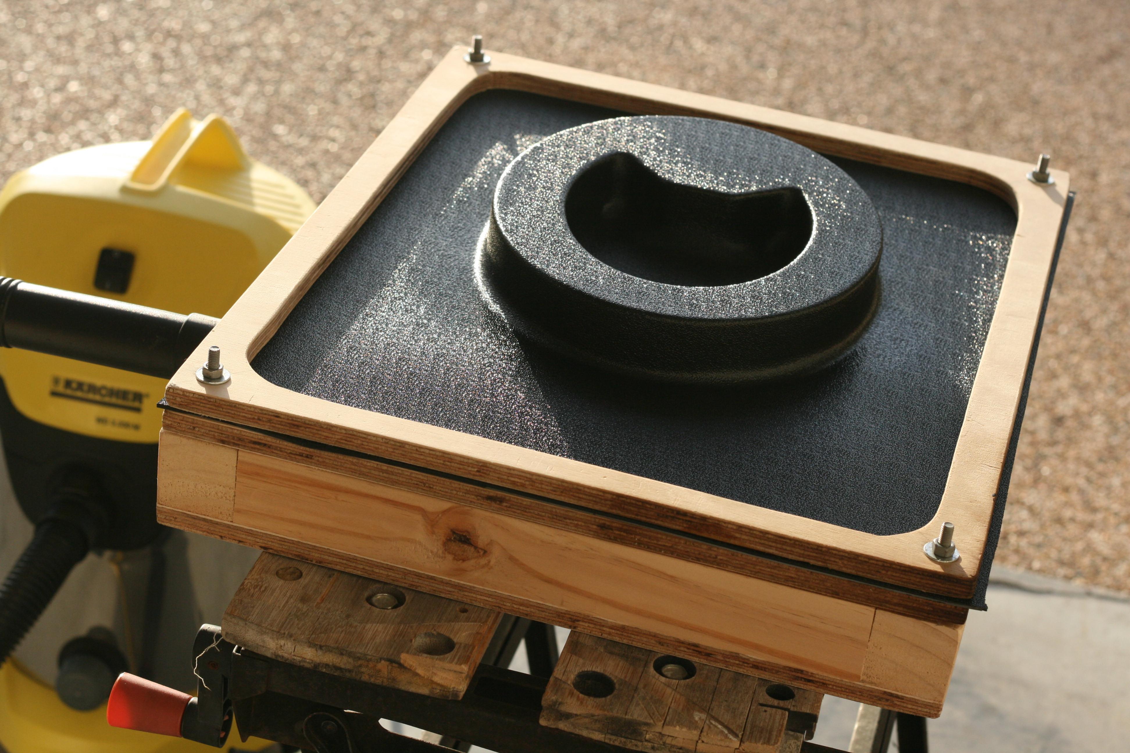

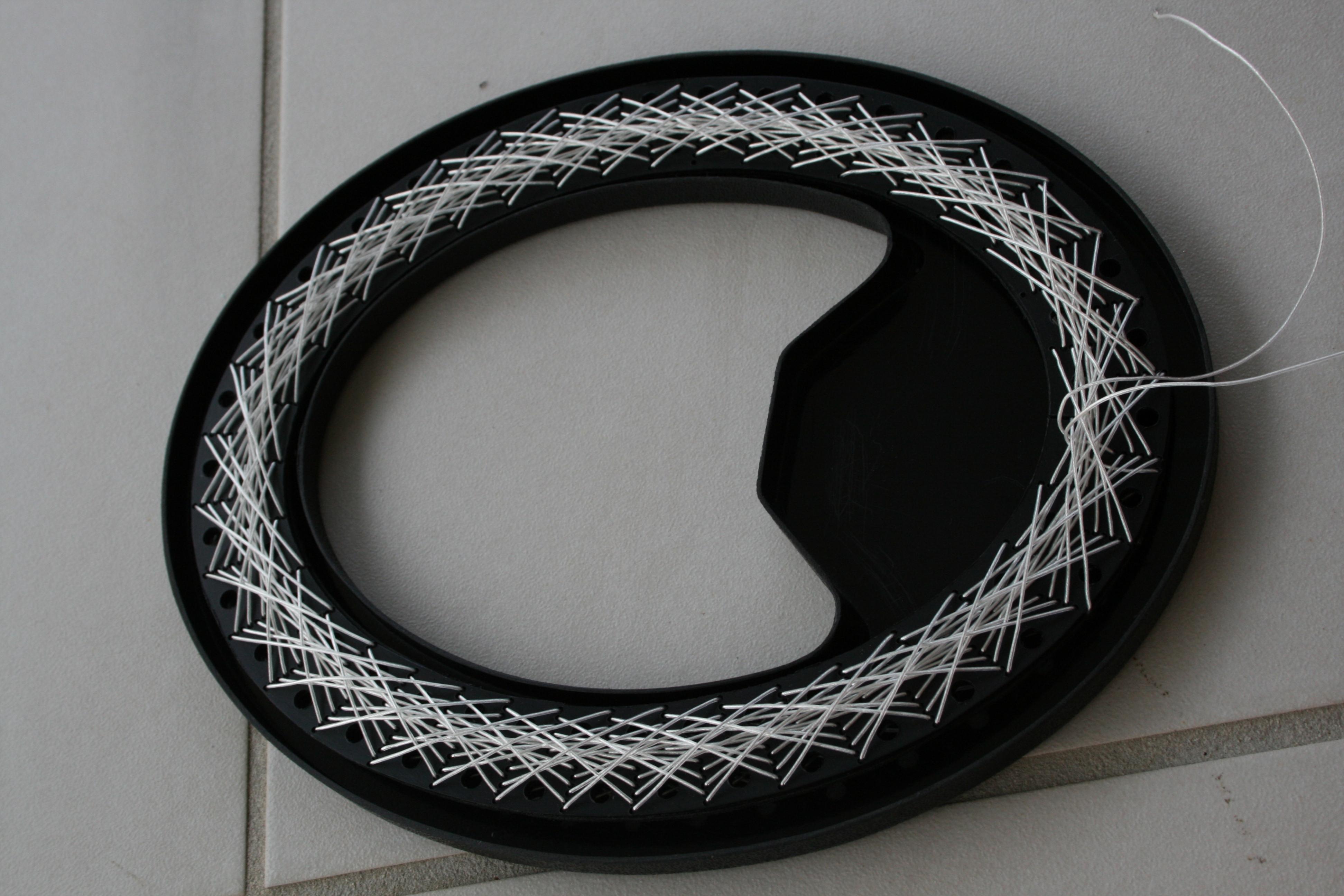

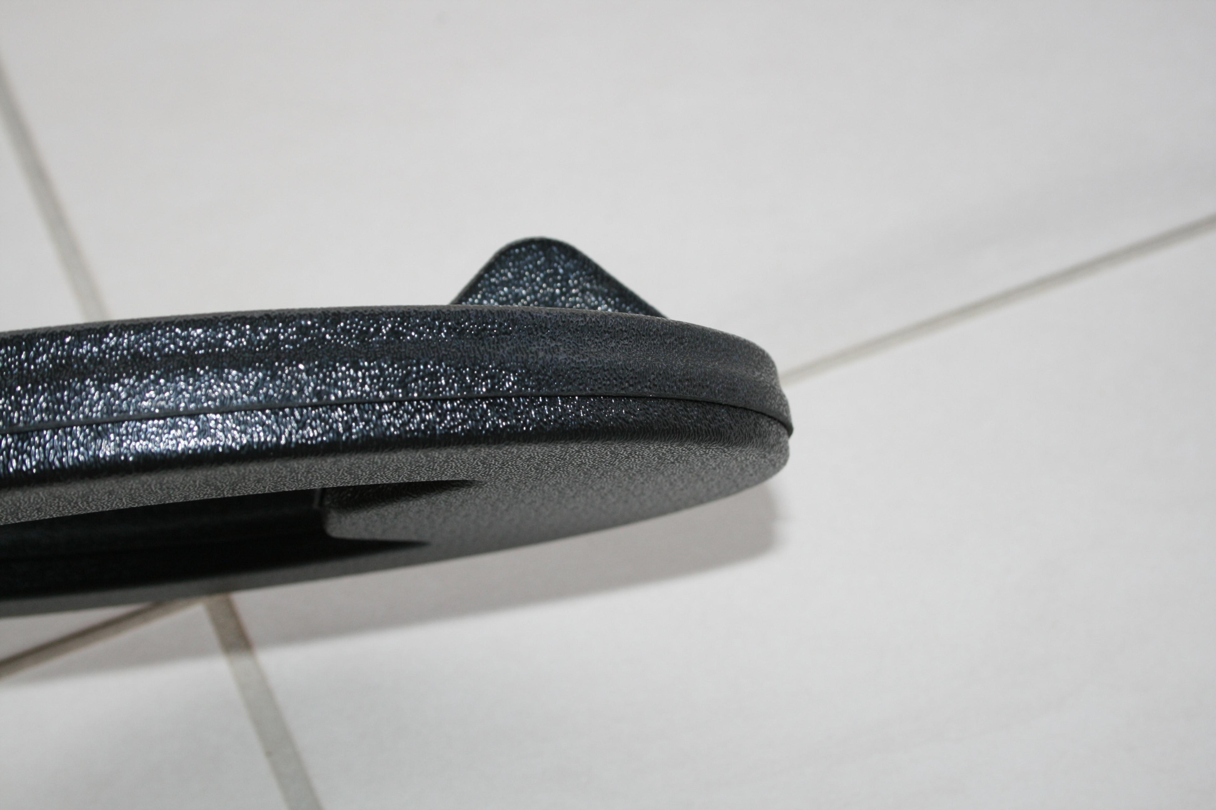

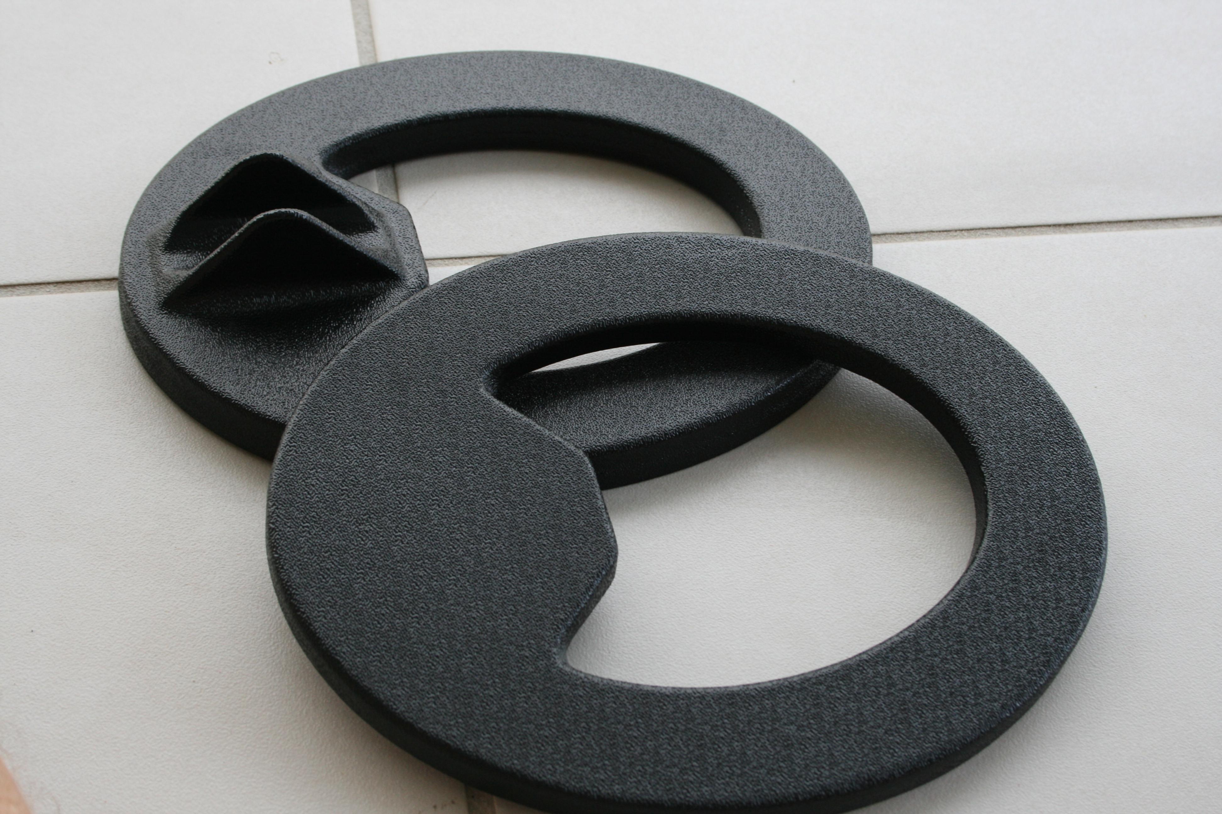

                        As a first step I focused on the search coil design and build the Oval Basket Weave coil with some slight modifications. Still experimenting with various other designs also. Along the way I crafted vacuum mold table to make a suitable housing. I’m able to detect a square cm aluminum (coke can) at about 0.5 inch with the basic MPP.

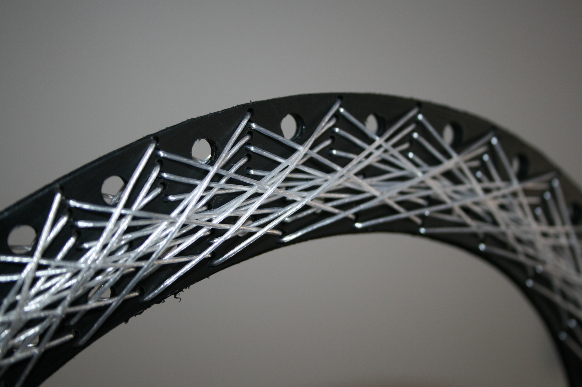

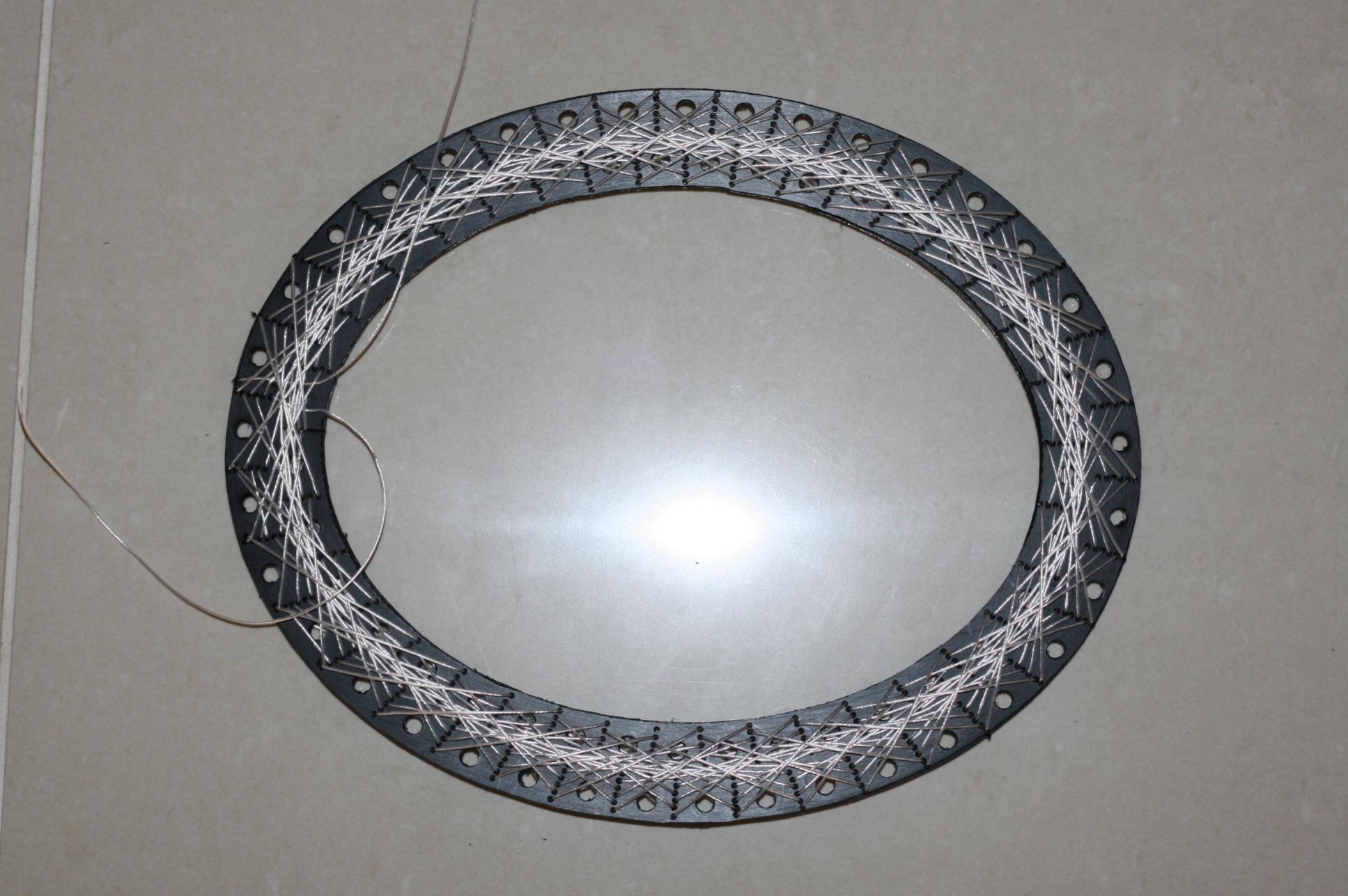

                        I used a 4mm PE base with 0.12mm2 26AWG PTFE insulated silver plated stranded occ copper. Instead of slots I drilled holes to maintain separation at the crossings. I’m not sure though if this is the optimal design to lower parasitic capacitance. Will post some photo’s once I know how to.
                        Cheers,
                        Jacob
                        • Great looking coil. Must have been murder drawing upwards of a 100' of wire through each hole! Will follow to see how it reacts in actual use.
                          • You are very patient and persistent to have drilled all those holes and then threaded all that length through them! If I counted right it looks like you did about 30 turns on the form. The holes indeed help separation of the wires and should help keep capacitance lower. What voltage rating is the PTFE insulation of the wire? It will be interesting to see what the Self Resonant Frequency of this coil measures. Goooooood job!
                            Dan
