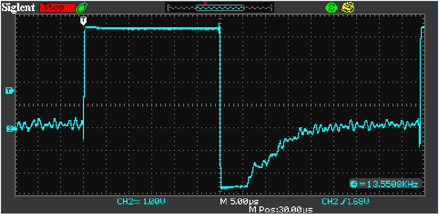

            Yes mate, I have the 1k still in place, added the diode and have the basket weave coil (350uH, 26AWG, 3.4ohm). Coil resister is only about 350 ohm though. I will check tonight and upload a scope image. There is a little overshoot on the pre-amp output but a nice response to small gold. Theoretically this would mean that I have a lot of capacitance sitting somewhere in the coil circuit right? Well, I sorted out quite a bit of issues with my modded MPP but this puzzled me. Cheers,
                        Jacob
                        Hmmm, that's curious Jacob. Sounds like your coil is pretty similar to mine. Did you use the wire to run up the pole to the control box? That's what I did, so it's one continuous length of wire from the control box down to the coil & all the windings, then back up to the control box. when I try to measure the capacitance of my coil at the connector (unplugged) it's too low for my meter to even see it's connected to something. Perhaps you could see if you get a capacitance reading. There's got to be a reason for the low value - 350 ohms is really low for that coil. How long in microseconds does the coil take to recover from the spike? - thx - Kyle
                          Hi Kyle, This is the picture of the pre-amp output (second stage). I've added a bit resistance so that there is a smooth decay without ringing at the shortest possible time. This allowed me to ramp up the damping resistor to 610 Ohm which looks a bit better. With a 30us TX pulse duration I measure about 6us before recovering (see scope image). I've separated the pre-amp from the main board and build the pre-amp in the coil housing as some kind of experimental mod.
                          Since last week the detector produces sound but I'm not really satisfied with the sensitivity. The coke can test gives me about 50cm with the basic MPP settings 58us TX etc.). There may be too much noise in the house but in this test phase I just need to hook my equipment to do some measurements. Further to that I have used all of your mods with respect to SAT and sensitivity adjustment and used some different components in the front end. I noticed that the coil wire I use has only a very thin layer of teflon insulation. When I checked the photo's of your coil build it seems the insulation is a lot thicker. Not sure if that makes a huge difference though.
                          Thanks for your advise.
