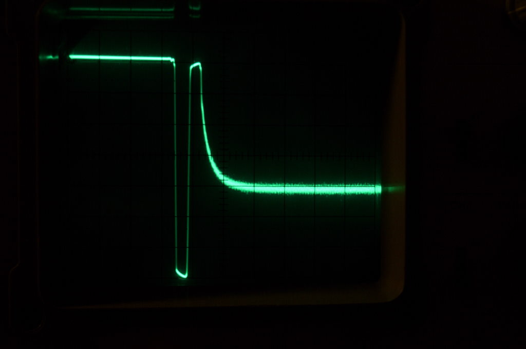

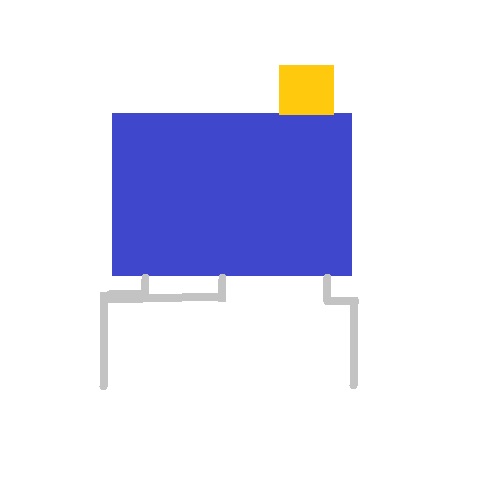

              • Can someone help me out, I replaced R10 and R11 with trimpots and R29 with a pot what TP do I use to adjust the Sample pulse width and EFE (secondary) delay on? I fitted the trimpot as shown in the little drawing, is that how we replace resistors with trimmers? also something odd with TP3 the waveform it is not what it use to be, if anyone has an idea why? Everything still works I'm getting good detection still.

                    R10 adjusts the secondary (EFE) pulse delay, and R11 adjusts both the main and EFE sample pulse widths.
                    The signal at TP3 looks underdamped. Changing R10 and/or R11 should have no effect on this. You probably just need to tweak your damping resistor value.
                        That's what's odd about , it's the same coil, with the same Damping resistor. I used to set it up the first time around, I've used the detector all summer long. the only changes I did since then was replacing the ( 5K R7 and a 40K R8 changed the first trimmers I originally put in, for new ones) and added trimmers to R10 and R11. Is it possible the bent over leg of the trimmer on R7 is touching R2 or perhaps R1 ? I did feel like a tight fit and its set in a little crooked.
                        • Originally posted by Tibuck19 View Post
                          If you've changed R7 and R8, then you will have affected the parameters of the TX oscillator. This will quite likely mean that the damping resistor needs adjustment, especially if it was on the edge of being underdamped.
                            Perhaps so, They are still the same values and set to the same resistance as the others were but perhaps being different manufactures it maybe enough to cause it the first ones were recycled button pots and the new ones are bourns style from china of course . we will find out, I'll pull the Damping resister and tweak the value with my Damping-pot. Thanks for your advice and ill let u know how it works out. EDIT: Good call lol your the man! it was indeed the damping resistor ,Thank you
